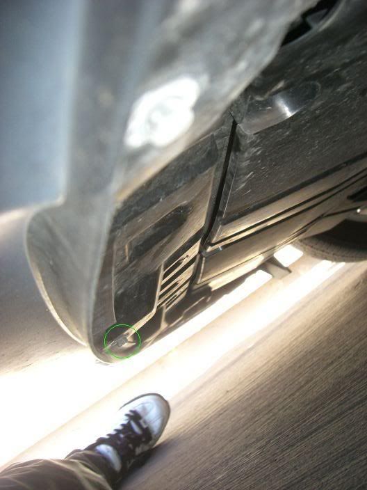

Step One: Bumper Removal

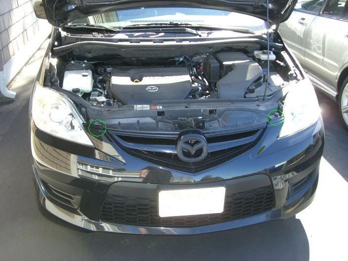

Park you car somewhere where you can get underneath it, and away from where you will be painting. Pop the hood and remove the two screws and rivets located in the green circles below.
Then get underneath and remove the 9 screws (? - can't remember if it was 8 or 9, but you'll see them (yes)).

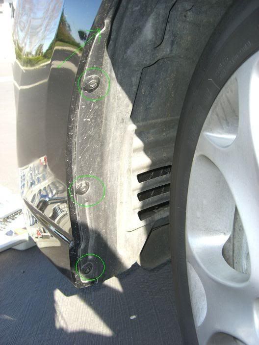

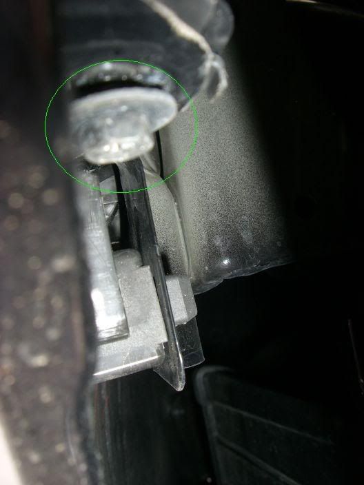

Next - depending on what side you start on, turn the wheels towards the car so you can easily reach the next set of rivets and screw. Use a philips to twist out the plug part of the rivet, then pop the whole thing out.
Once all three are removed, pull back the splash guard to get to the final screw.
Now that all the screws and rivets are removed, start by pulling out the sides of the bumper. These are held in by snaps. It shouldn't take too much force to do this.

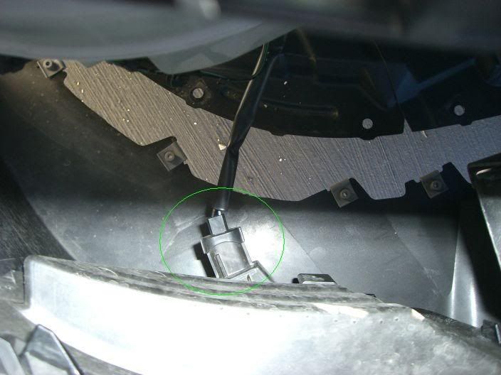

Then grab under the license plate holder, and in the middle of the top of the bumper, and shimmy the bumper off. DON'T YANK IT OFF. There are fog light connections to disconnect. I have a Sport with no fog lights, but the connections are still there from the factory. Reach down and squeeze the release part of the plug and seperate. On the driver's side, my harness ran through a clip that's plugged into the bumper. Just pop it out.
Congrats, your bumper is off! Go stash it somewhere safe and away from where you will be painting.

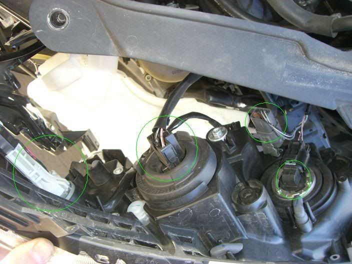

Step Two: Headlight Removal

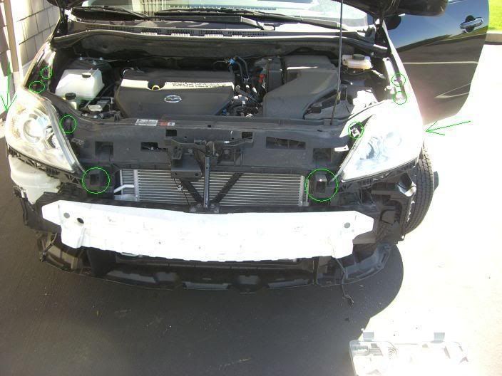

There are four screws and one rivet holding the lights on.
Remove the screws and take notes that the one on top, closest to the passenger compartment is SHORTER than the other three. Pop out the rivet. The light should be loose. Pull it out so you can get to the lightbulb sockets and harness. Here's the view looking down as you pull the headlight out:

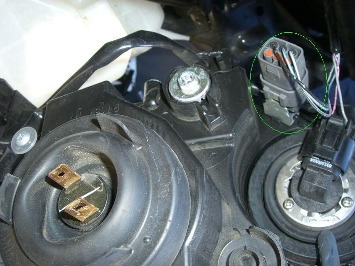

Everything in green is what you need to remove. Unclip the headlight and the harness for the blinker and highbeam. Twist out the highbeam and blinker sockets (don't touch the highbeam bulb. The grease from your hands will damage it). Unclip the second part of this harness seen here:
Carefully remove the wiring that is held in place by different clips. If you need to, you can loosen the screw with the plastic washer holding the wiring in place.
Congrats. Your headlights are now removed and your car looks like you rear-ended someone!

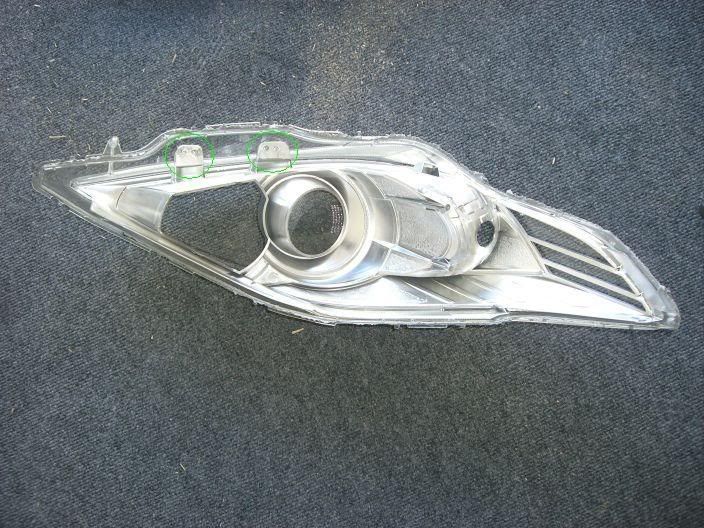

Now we need to remove the parts we don't want to go in the oven. Start by removing the rubber seal for the headlight. I just took a flathead, lifted the edge and peeled it back. This will reveal the bulb.

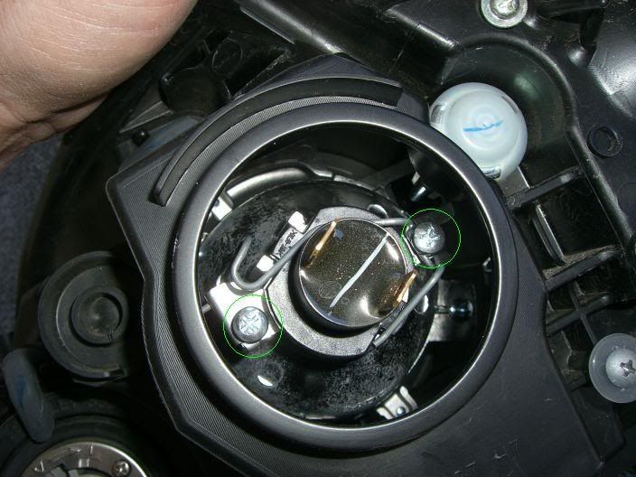

Use your philips head to loosen the screws holding the pin in place. Remove the pin and the bulb. Set the bulb aside somewhere safe, and again, DON'T TOUCH IT.

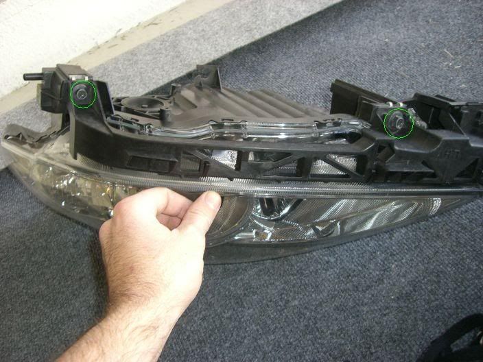

Next remove the headlight support that is used to hold the headlight on to the car. Remove the two screws and seperate from the headlight.

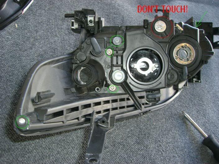

Now remove all the screws shown below. Take some notes on what screw goes where, or just refer back to this photo. DON'T TOUCH the screw circled in red. That one adjusts the headlights. I found out the hard way...
Now your headlight is ready for the oven.

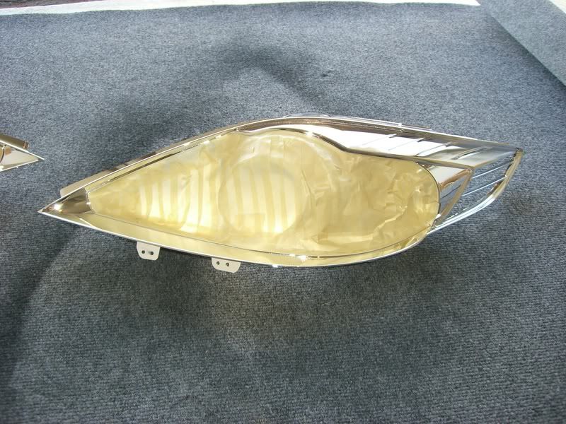

Step Five: Headlight Prep and Paint
Now remove the two screws holding the bezel in place and remove the bezel. Mine had some excess glue holding parts of it in place I had to work around. Don't FORCE it out, it's plastic, and it will break. Just take your time. Set the plastic cover aside and away from where you are painting. I put all the parts of my headlights under a towel so no dust would accumulate.
I wanted to paint the reflector part of the headlight because I hated the orange. So I removed that from the headlight assembly as well. Just unscrew the one screw and slide off.
Now you need to decide how you want the headlight to look. There are lots of different ways to tape of the light for different looks. I examined this for a while, and decided to just tape off the inner part of the bezel so the outside would be painted.
I would have liked to paint around the headlight and such, but the taping would have been a real pain, possibly resulting in a messier job. What I found out later is the chrome part of the bezel is quite resilient. Don't be afraid to put some tape on it. Just be careful when removing it later.

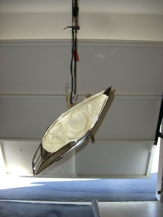

Remember to tape the holes in the rear of the bezel. You don't want spray getting inside.
I hung the bezels from my ceiling so I could get a good even coat.

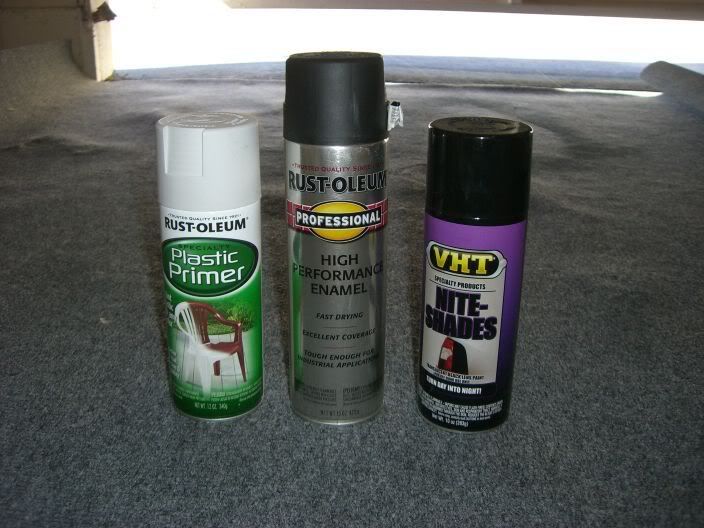

I used VHT Nite-Shade for the reflective part (because I wanted to retain it's reflective properties for safety reasons), and Rust-Oleum plastic primer and flat black for the bezels. You can use what every spray you like. Rust-Oleum just happened to be the only brand with a plastic primer.
Some people might want to sand the bezels for better paint-adhereing. I did this on my Subaru, used too much pressure, and broke the bezel. A little Krazy glue did the trick, but I didn't want to go through this again! Since it's going to be sealed inside the light, I wasn't too worried about sanding.
Start spraying!
Follow the directions, coating and drying times I did three light-to-medium coats of primer, then the same with flat black. For the reflectors I used about four coats of VHT Nite Shade. They came out REALLY dark, and I'm not sure the reflective part is visible anymore...
Here's where you make the call. I let them dry for an hour, and started putting the lights back together. I scuffed them a couple times because the paint wasn't completely dry. It was dry to the touch, but not COMPLETE. I had to use my car last night, so I had no choice. But it might be good to allow yourself some time for drying.
If you do scuff the paint, I used a Sharpie to fill it in. Worked perfect!

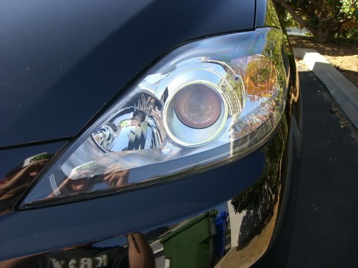

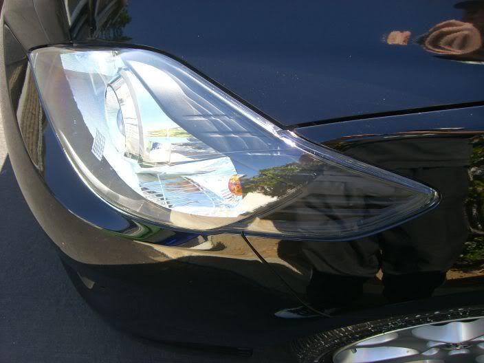

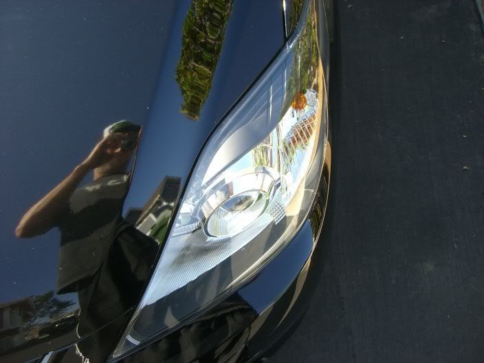

Here are the photos! Don't mind the tire foam n shine. It will dry.
If you look close at the bottom of the headlight, you can see my tape job wasn't perfect. The paint bled under the tape just a bit. But looking at the car you don't notice. I expected a little of this.

looks good man, I wonder if that would look even better if you get the whole thing painted black
I wanted to do more, but the taping would have been a nightmare, and I was worried about the reflective part of the blinker. I didn't want to pull any of the chrome off with the tape. I've seen this happen to VW's. You also obviously can't paint over the reflective part of the blinker either. So I made the call to paint around it. Although after realizing I could scrub the reflective part and not damage it, I figured taping it off would have been fine.
What I originally wanted was the whole thing black, leaving a chrome circle for the headlight, and the highbeam and blinker reflective area still chrome. Maybe one day if a friend wants to do this, I'll do mine again and go that route.
Either way I'm happy with the result.
