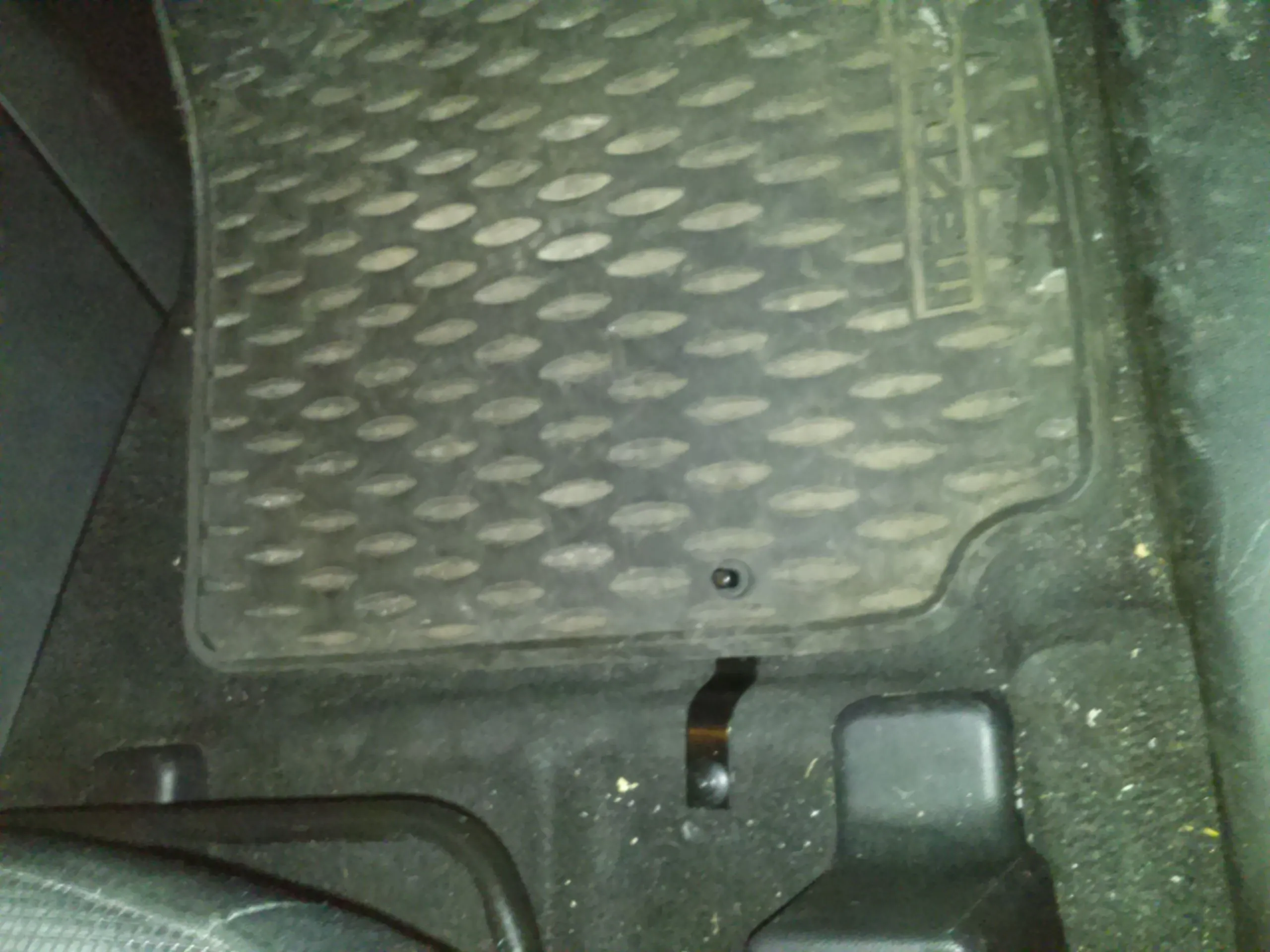

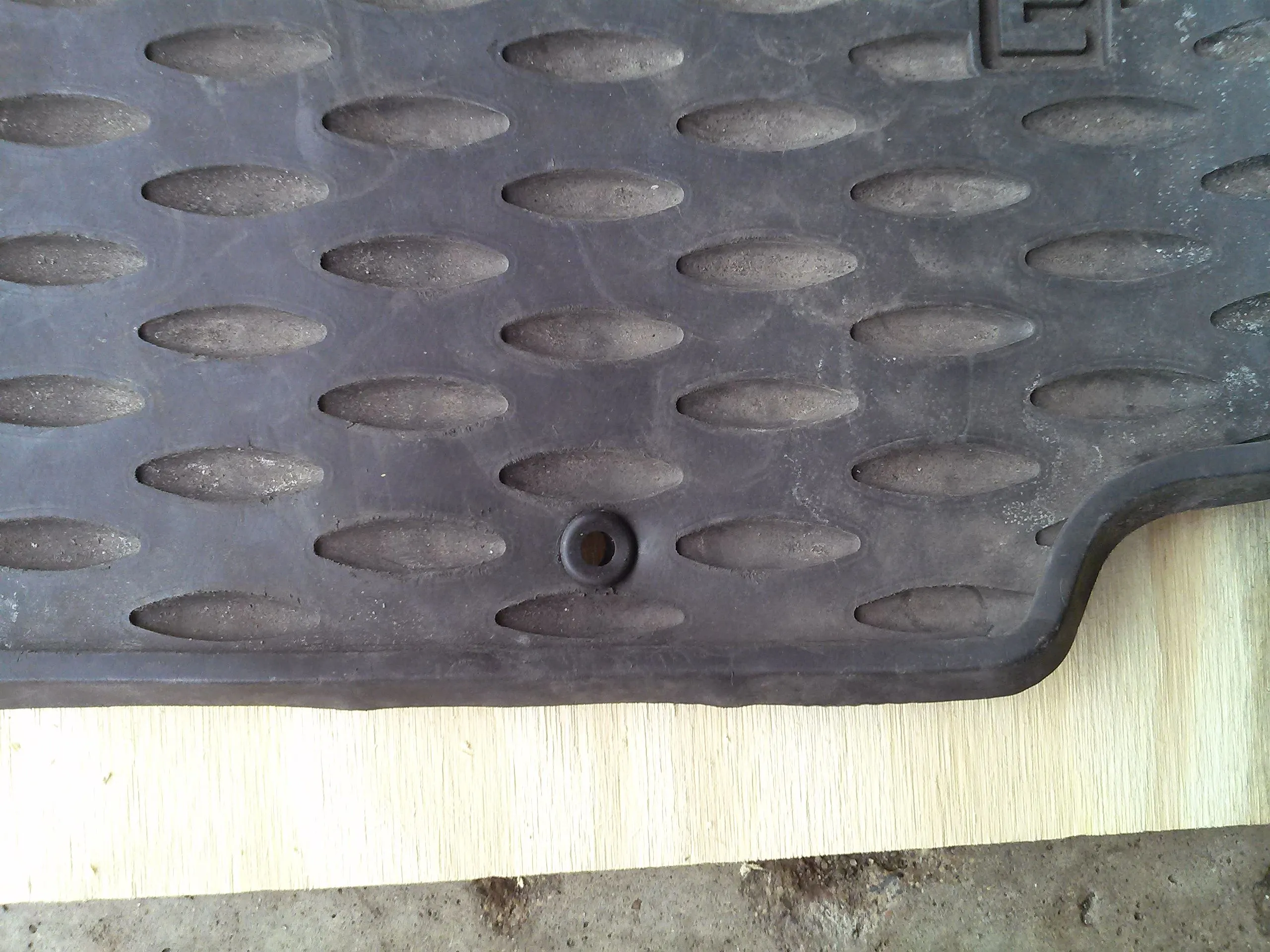

1. Drill hole in mat using 1/2" bit (see pic for location). The hole wasn't 1/2" when I was done with it but it worked perfectly
2. Insert grommet into mat. Just work one edge in and then work it around until it snaps into place

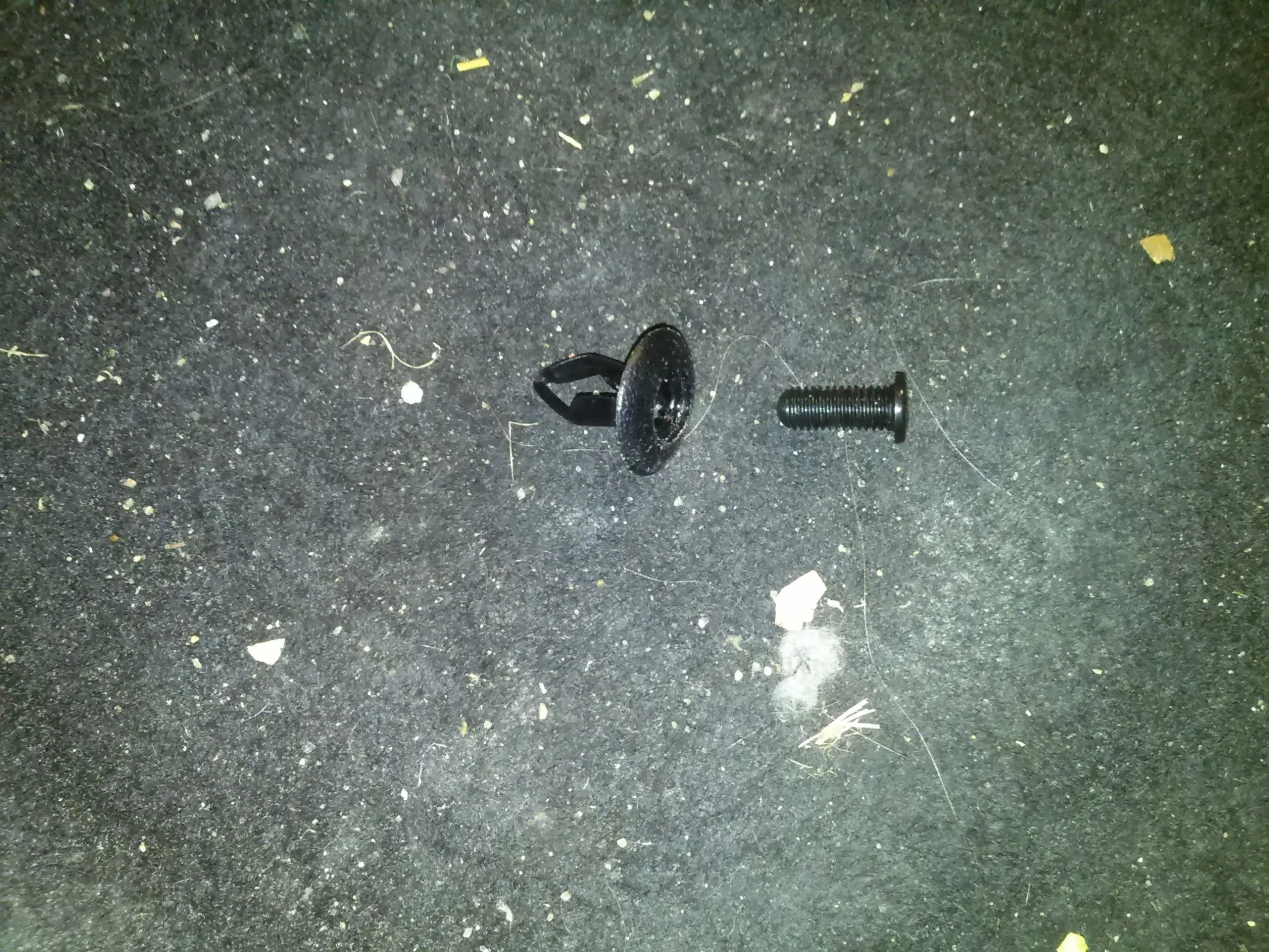

3. Remove the retainer clip from underneath the passenger chair
4. Put the bracket in place, re-attach the clip, screw it in, and secure the mat
