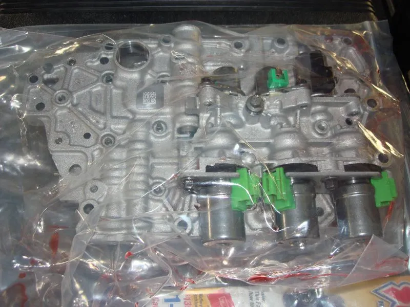

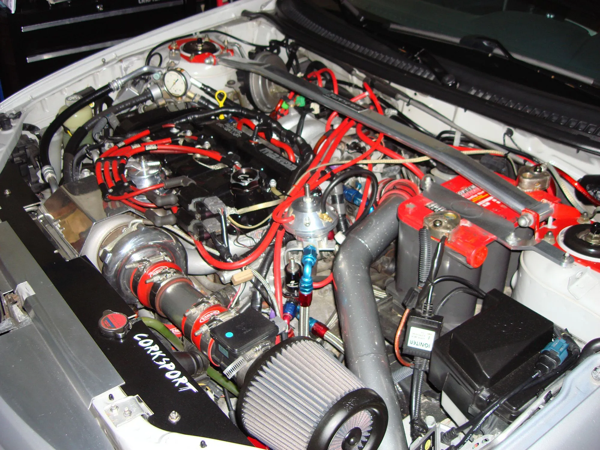

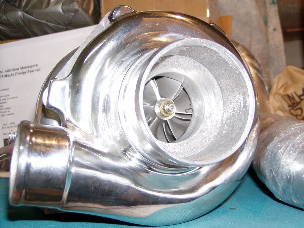

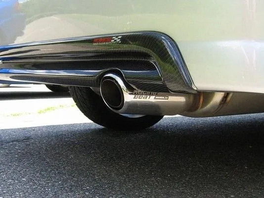

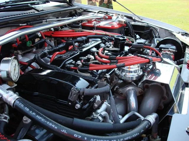

auto tranny and been boosted about 50k miles, no tranny isssues at all...i don't beat it but i do push it, no neutral drops...i have the lentech valve bodies, awesome mod! tranny cooler going in this fall....had it for a yr now, just getting around to installing it finally(hand). i haven't been on the dyno, but @ 6psi, probably about 160hp...? i have no cats and the RB cat back. i had the mpi on the car, but just couldn't tune it right...i'm using the begi rrfpr and fm O2 clamp, works awesome!! for those who haven't boosted their auto, it's just not the same car...i could never go back!!:D
nope, i'll do it some day....next yr i probably looking at a new car...so this will become a "project" car...i'd really like to build the engine and tranny (lentech street terminator $3k+-)
