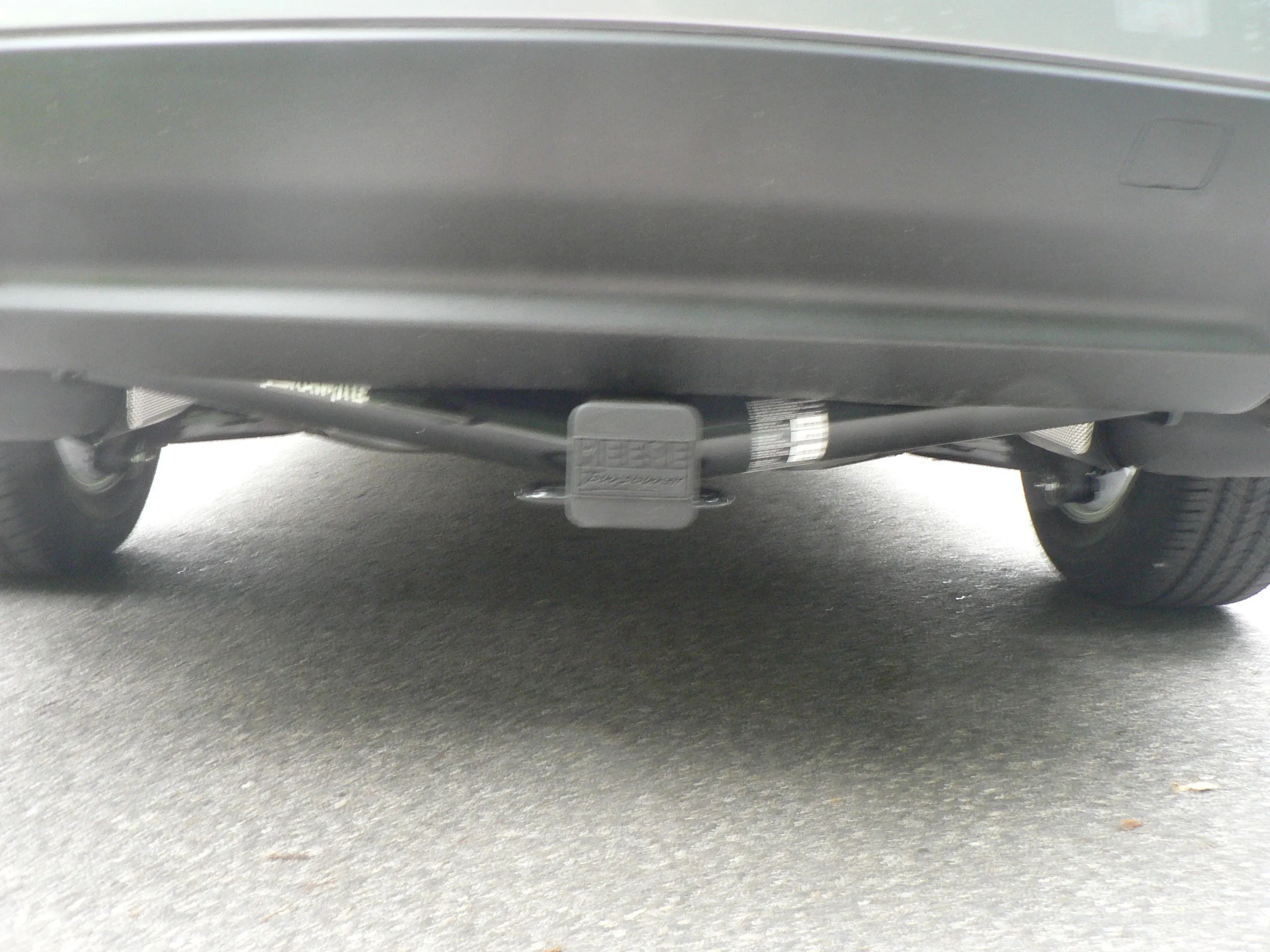

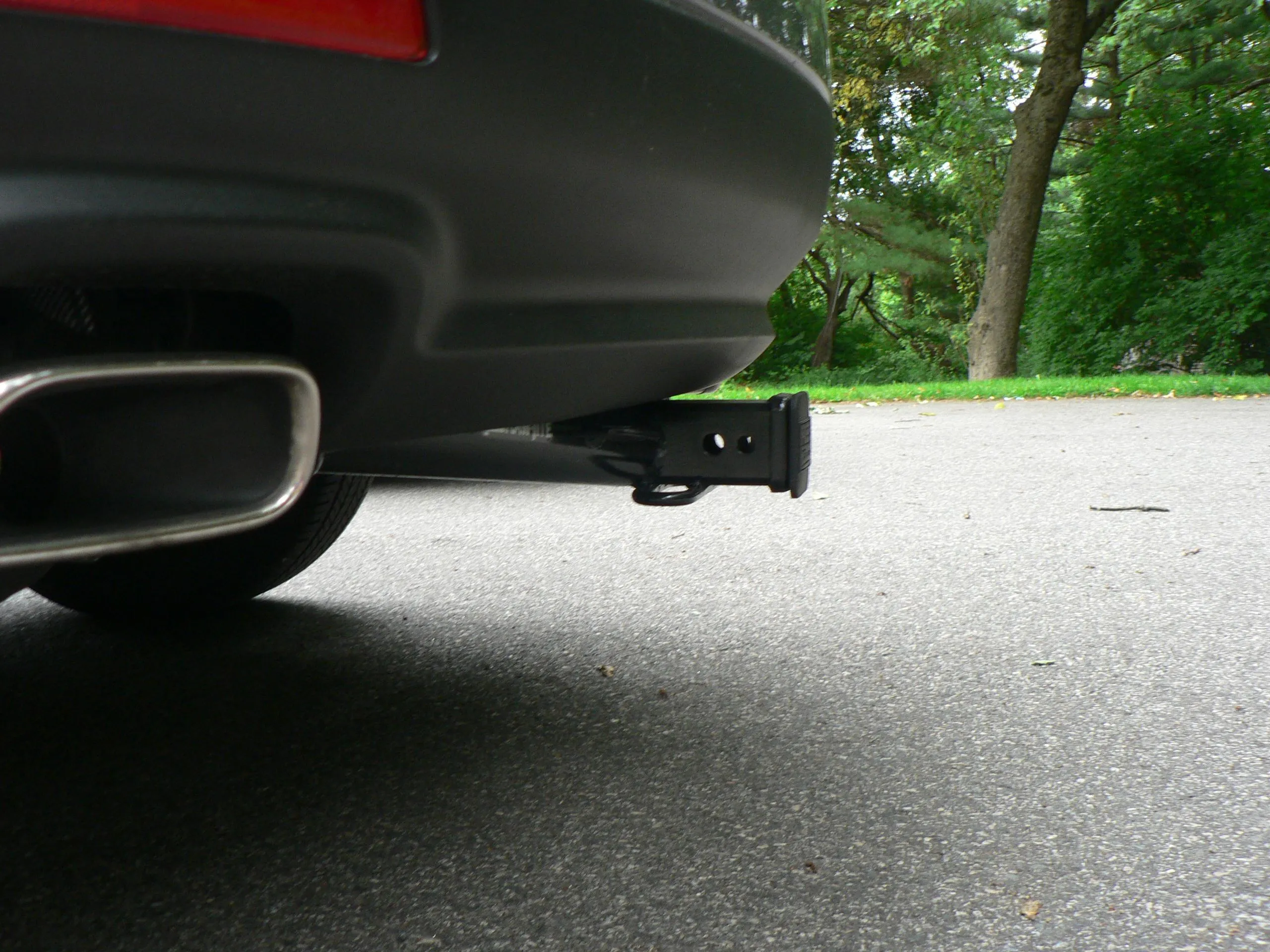

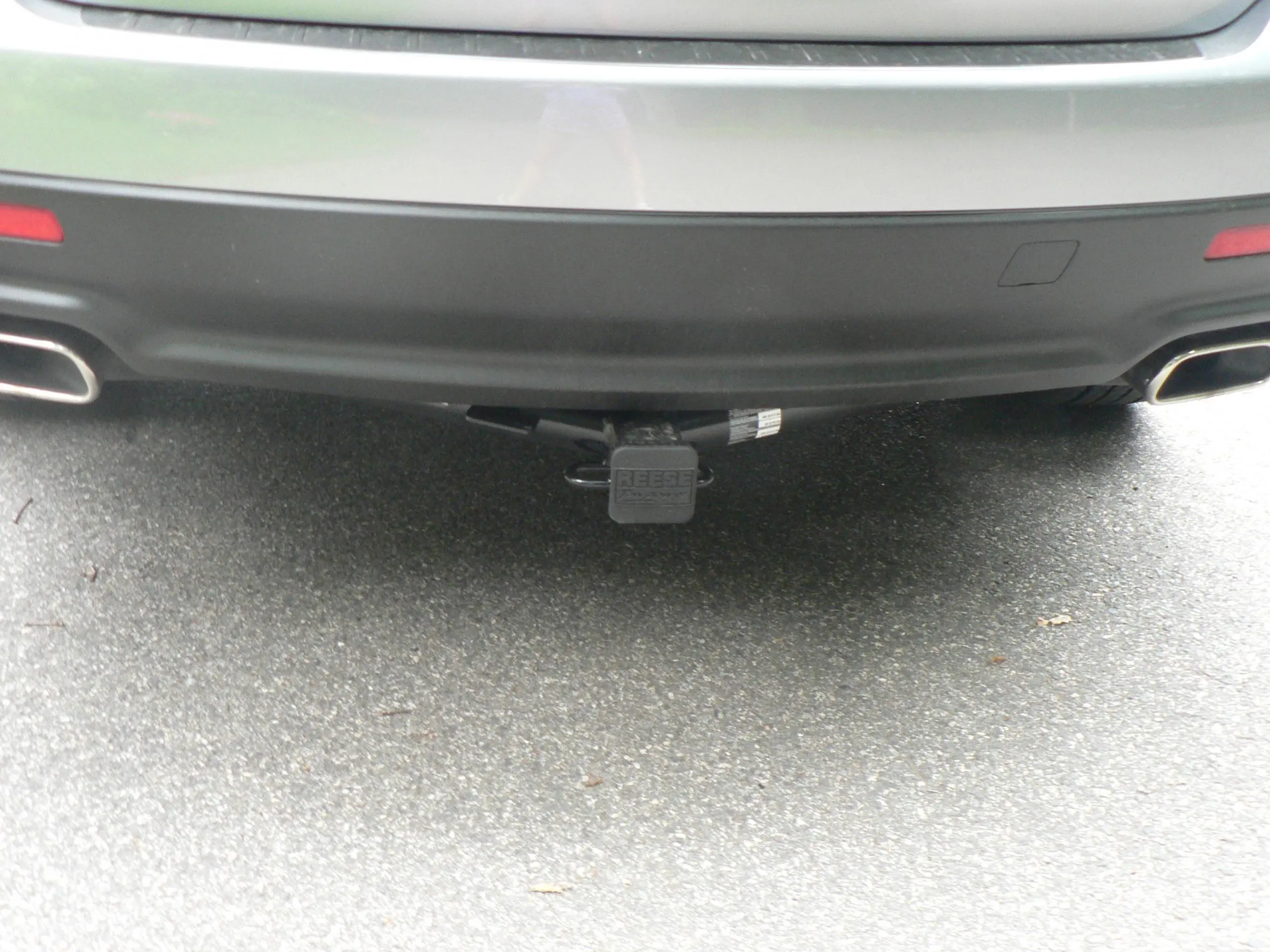

Sorry if this doesn't work, this is my first attempt at including photos. Thankfully, there is not much to see. My wife commented that it was nondescript. Definately better than 'you put that ugly chunk of metal on my nice new car'!!
Stu
P.S.
Thanks to my 11 year old for taking the pictures for me.
