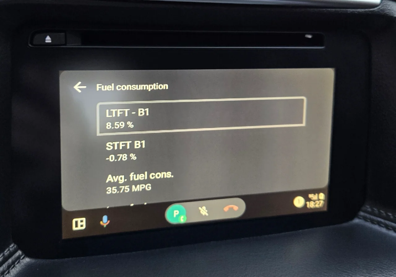

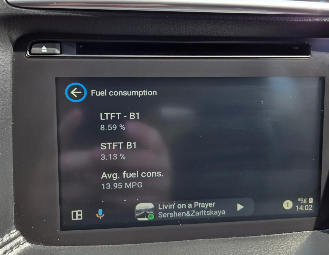

I've only had it for a week but I noticed today that the fuel trim is quite high, 8.5% for LT and 3% for ST. It doesn't go up much when driving, just a few percentage points at most and sometimes ST will be around zero depending on the environment, driving style, etc.
I asked the dealer service department about the fuel trim and they weren't at all concerned. I asked if carbon buildup on the intake valves could do it (seeing as it's close to 100K miles) but they didn't think it would affect the fuel trim, at least not more than a percentage point or two. I've heard conflicting things about this. Any thoughts (see related second question below)?
So, all that to say, I was wondering if anyone has any ideas I can try myself to see if I can get this a little closer to normal before taking it to a mechanic. Or am I worried about nothing?

Considering that you are achieving 13mpg according to your screen read-out thing, I would suggest to lay off the throttle for a tank or two and see how your LT, ST - FT's improve.
I'm not totaly sure but I believe what you are getting are "averages" on those readouts. What you really want to be looking at is current "real time" data under varying loads. I cannot believe that 13.95 miles per gallon is anywhere near accurate. As for the valve cleaning, you really need to remove the intake and do an inspection to make a determination. Have you any legacy codes or current ones showing up on your diagnostic scanner?

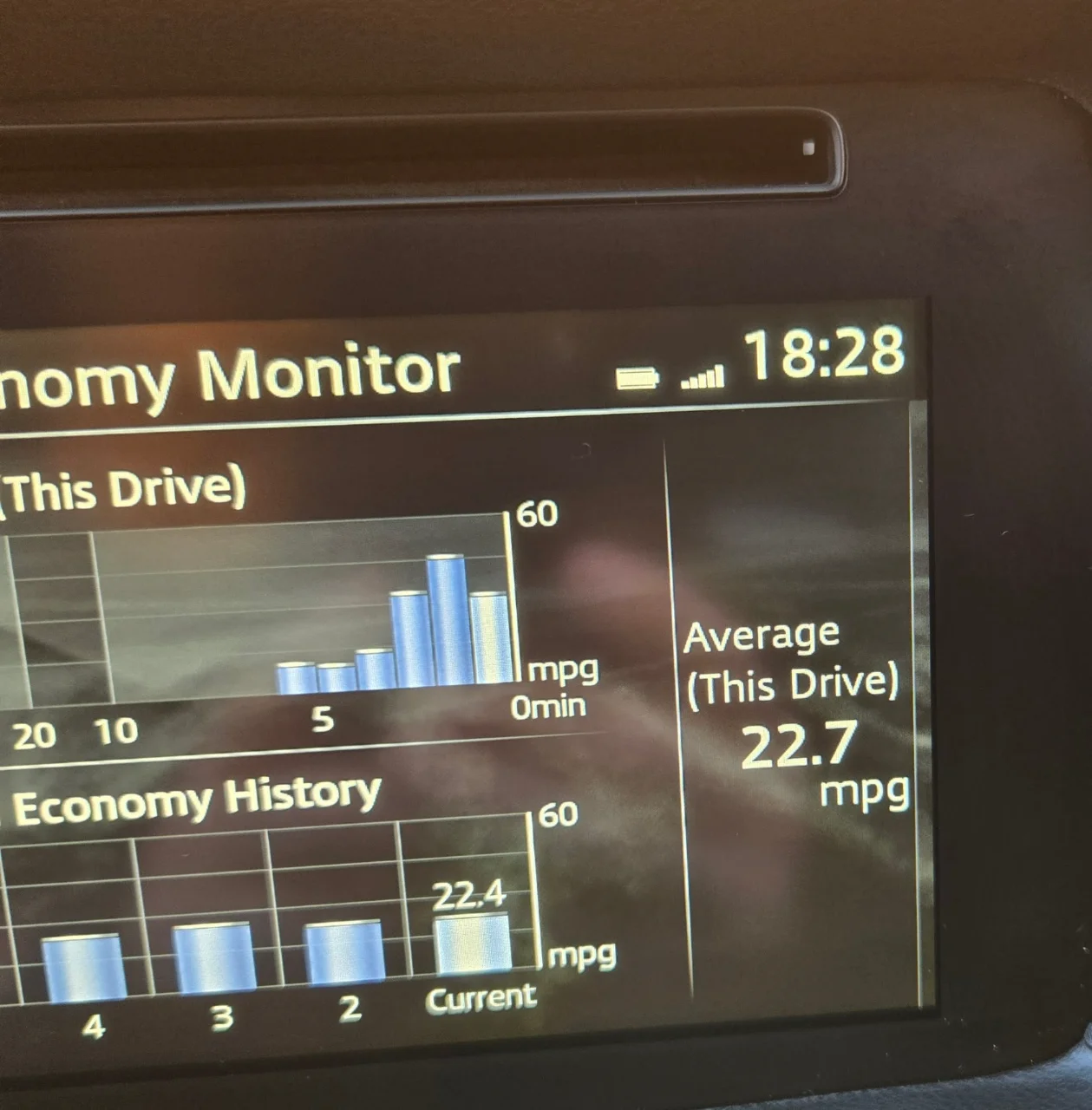

I think that 13mpg average was because all I did was drive around the block to see if the trim levels went up or down under load. I'm generally a very good driver and I consistently get excellent mileage in my old 4cyl, 2.7ltr, 2009 Highlander with 230,000 miles on it.
On Saturday I reset the MPG average and went to the dealer and a few other small stops on the way -- around 30 miles round trip with roughly 70% highway driving -- and I got an average of 24.5 mpg with the highest average being 26.5%. I have noticed that short trips in town get pretty bad average of between 15 to 19 mpg.
I mainly wanted to see if anyone had any ideas of where to start looking to try to track this down. I guess I'll monitor the fuel trims more closely for the next week or so and see what they do under normal driving conditions and then circle back to this.
Got it! It's normal for fuel trims to be high, initially, after a quick drive around the block at low speed.
15mpg sounds unrealistic around town. Try hand calculating your mileage. If you confirm that readout is accurate, then perhaps I would trust those fuel trims too.
But even if it were accurate, a short drive at low speed will not provide you with any definitive evidence.
So, determine that the information you're getting is accurate over a longer period of driving, such as 1-2 full tanks, and then let's assess what your fuel trims likely are in reality, and then see if anything needs addressing.
If your fuel economy really is that low, then yes. But let's see first .

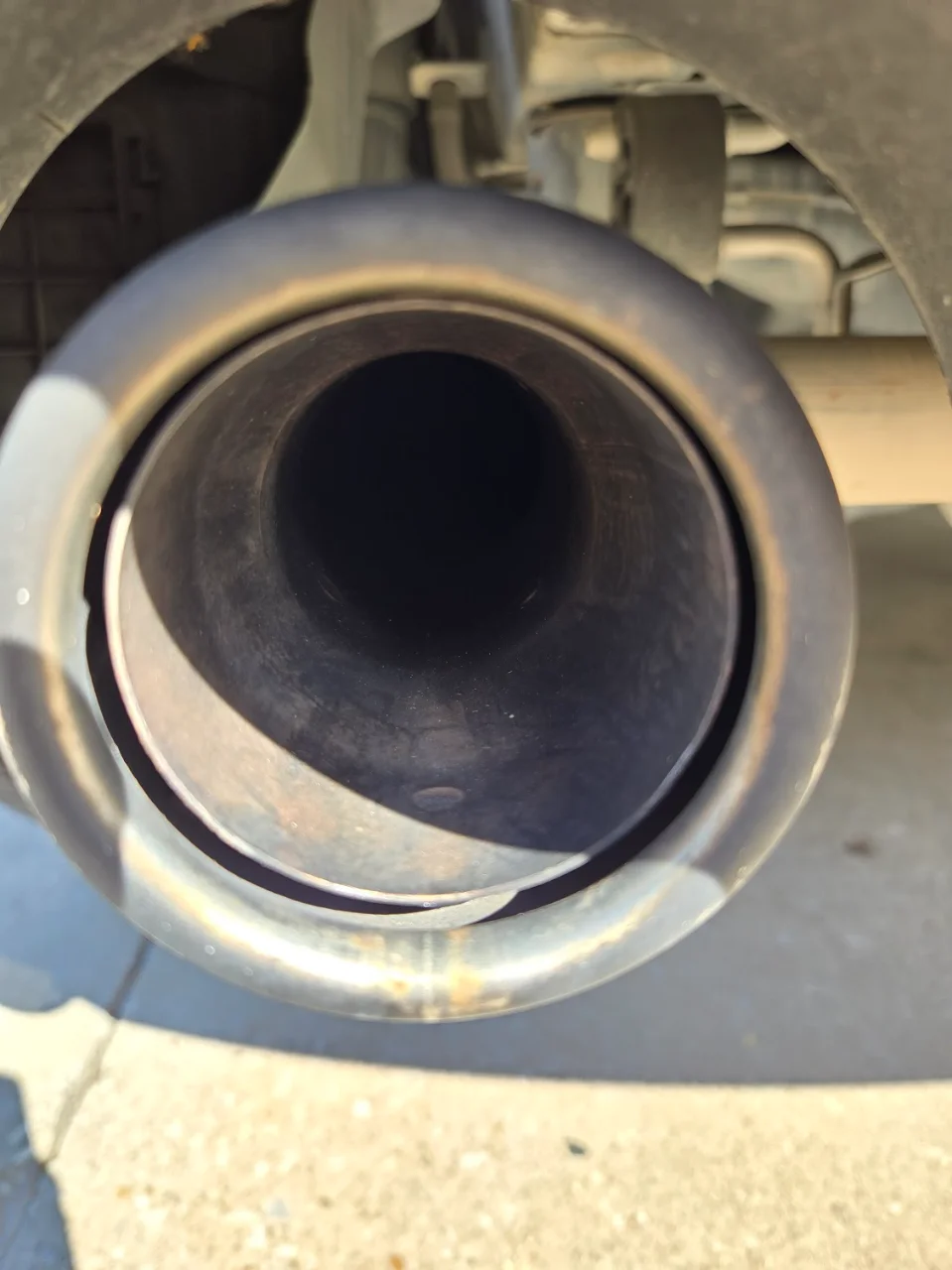

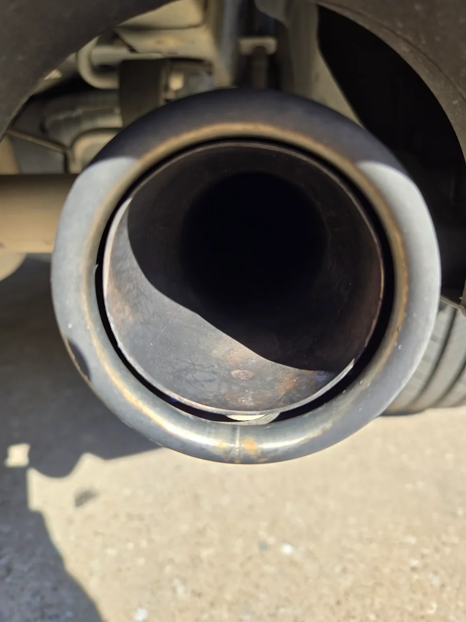

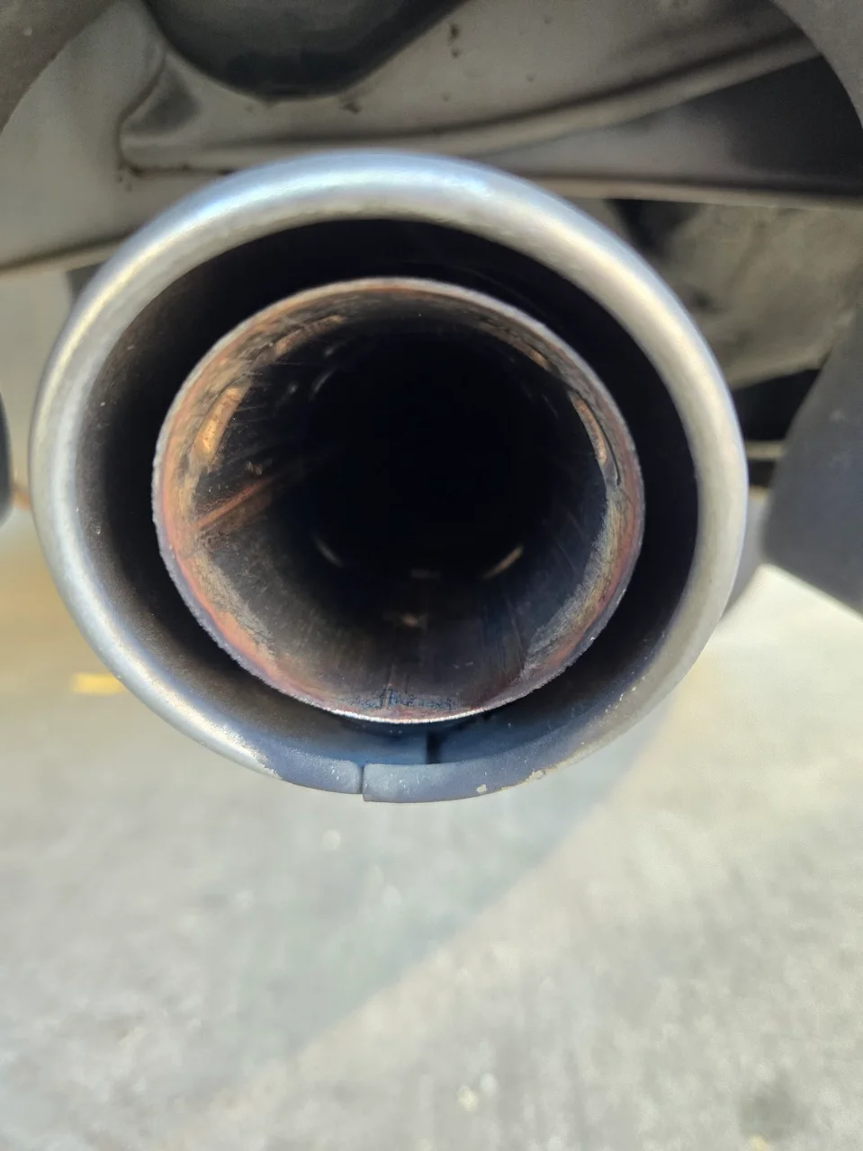

Please take and upload a pic of your exhaust tips. It would provide good insight as to your engines conditions and how it's been used over the years.
Here you go. Pictures are named as to which side they are. They look pretty decent to my untrained eye. I also included a picture of my son's 2010 Corolla with the same amount of miles just for interest.
Your CX-5 tips looking clean. I have no doubt that this engine burns little to no oil, and the previous owner likely treated the car right (at least as far as throttle input goes.) excess run off onto the chrome tip (such as with your corolla) Indicates a potential issue or heavy throttle application with the Skyactiv's.

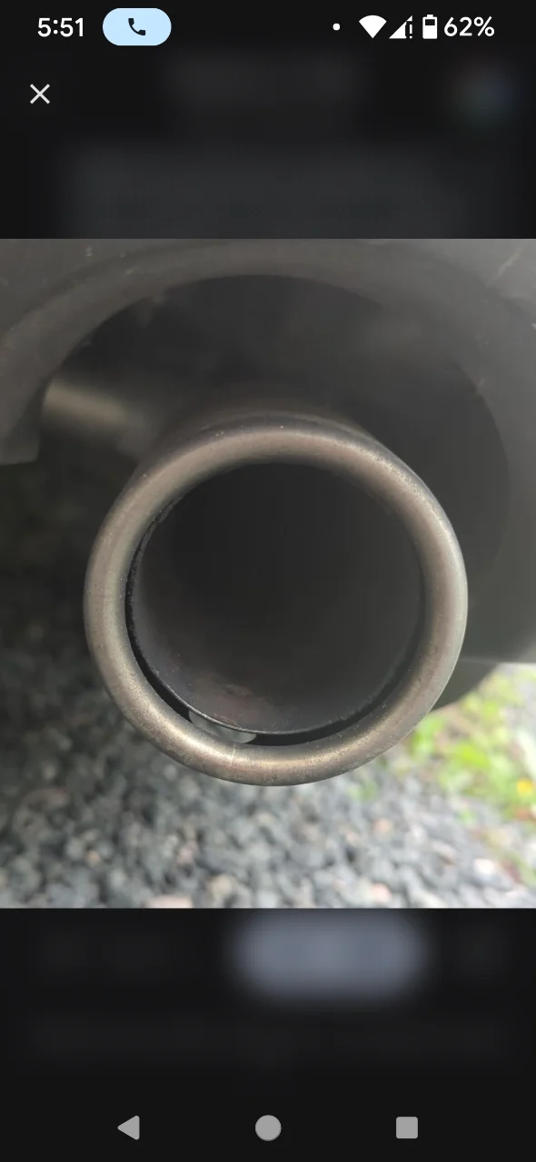

Here's mine for reference. You should not see black liquid running off onto the chrome tip with these Skyactiv's. If you do, suspect worn internals such as seals, rich mixture, aggressive or hard use.

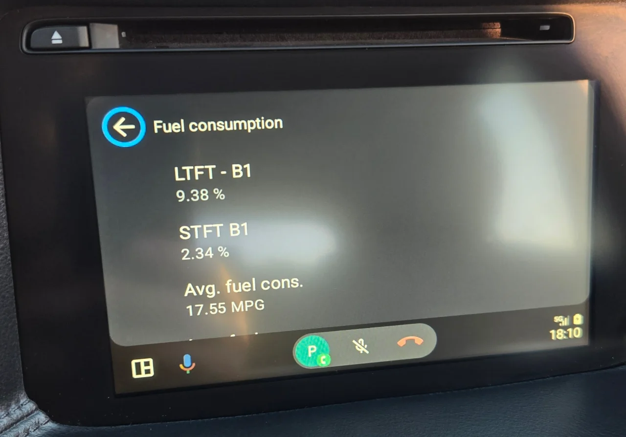

Just did a 4 mile trip (2 miles each way) and here are the fuel trims. I was going to video them but I got a call while driving so I couldn't. 😁
The averages from my scan tool are out of wack, as you can see, I probably need to calibrate it a bit with the correct car info, etc.
