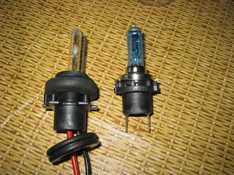

I got some HID's installed yesterday and the boneheads at Futureshop didn't put the bulbs in properly (I would have done it myself but then I wouldn't get warranty). I know the factory bulbs have an adapter/spacer on them. Any suggestions on what material I could make some out of and how to attach them to the bulbs? Right now they're just kinda sitting in there...(pissed)
just go to home depot and buy a pack of grommets for plumbing
put them butt up against the base of the bulb.
works fine
I think I'm just gonna drill a hole through the factory spacer to feed the wires through and silicon it. I don't want those boneheads touching my car again
Umm, The kit comes with the correct spacer normally..
In the kit it could be mistaken for a misc piece of plastic..
There was no spacer in the kit... I just used a drill and a grinder on the old one
All Fixed :D
It should've had something like this with it, the black plastic that resembles the one on the stock piece
