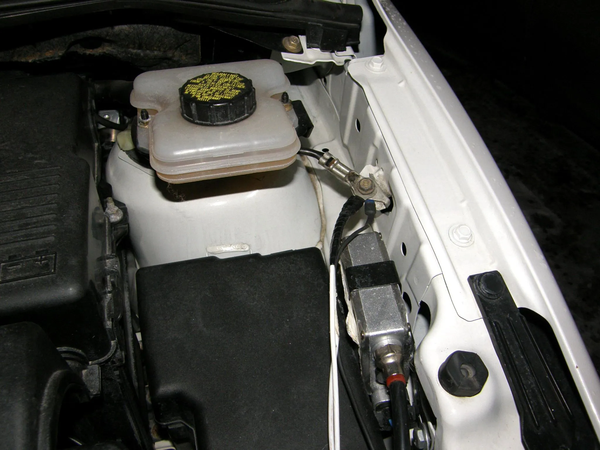

only because it takes no more than 15 minutes to remove the bumper and headlights, meanwhile makes your life so much easier. Not to say that my ballasts are behind the bumper cover, so is the ground point. I figured that the only place to mount the ballasts where it is not on the way, is right on top of the front rail bar. Not sure how long it took you to do the install, but I spent 40 minutes including removal and installation of the bumper and headlights.
It's the guy who sell me the kit who install it to me, it took him i would say about 15 minutes. He will come back to install the relay to bypass the DRL, this will take more time because he have to pass a wire through the firewall.

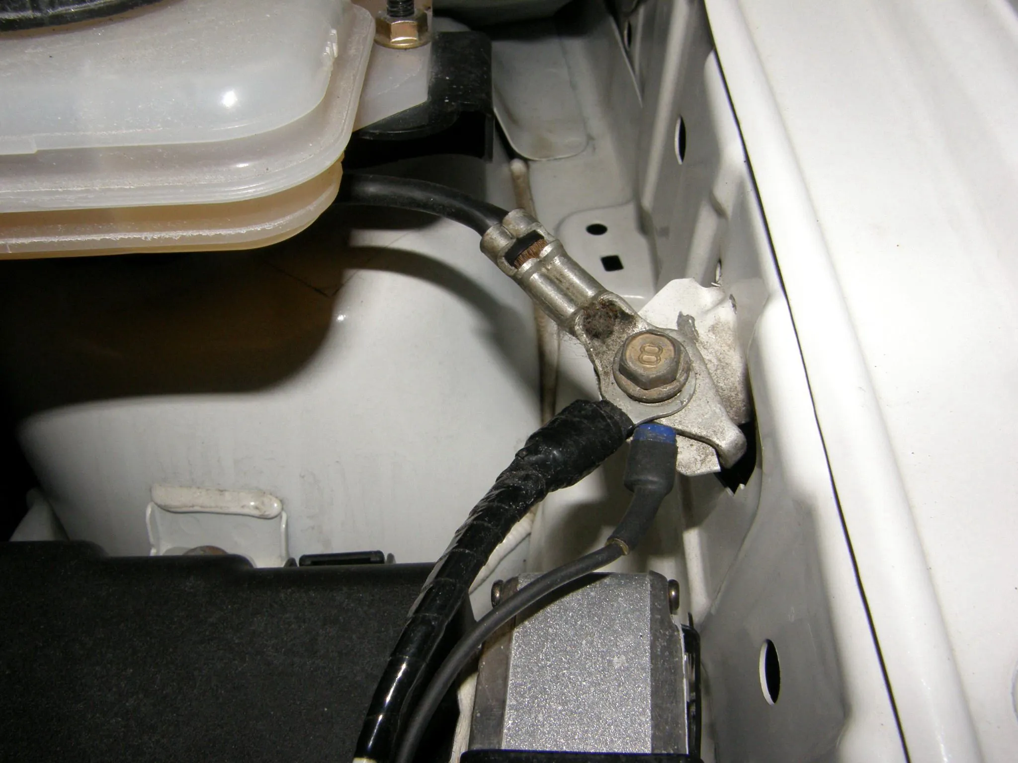

Awaken,
You don't have to install a relay to bypass your DRL... You simply need to put the negative (-) of your HIDs to any ground of your vehicle.
This is what I did and they don't blink anymore.. It took me 2 minutes to figure it out (with the help of a good soul on this forum)!
See pictures attached.

Awaken,
Si t'as besoin d'aide, PM moi!
Jasma.
attachment.php
This the same grounding point that I used (with the relay) but my HIDs still blinks. What did I do wrong?

attachment.php
This is the same grounding point that I used (with the relay) but my HIDs still blinks with the DRL. What did I do wrong?
attachment.php
no relay needed with HID install. Don't use all the extra wiring provided. It is simply plug in play, with only exception (grounding point)

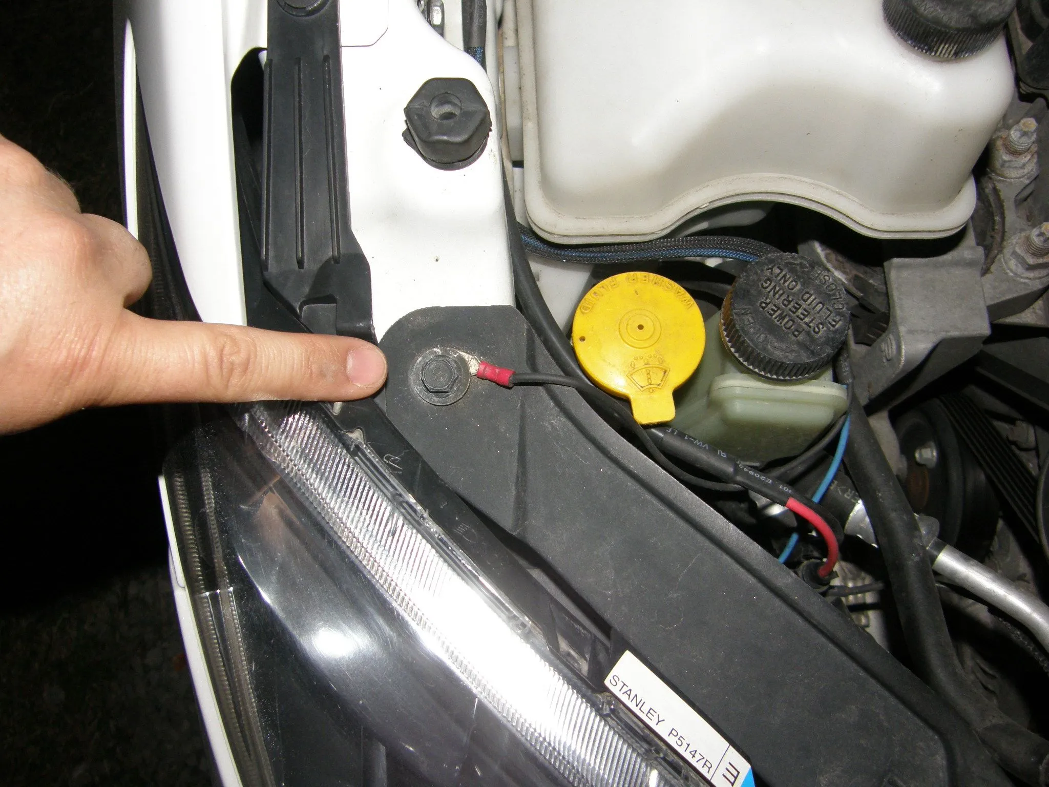

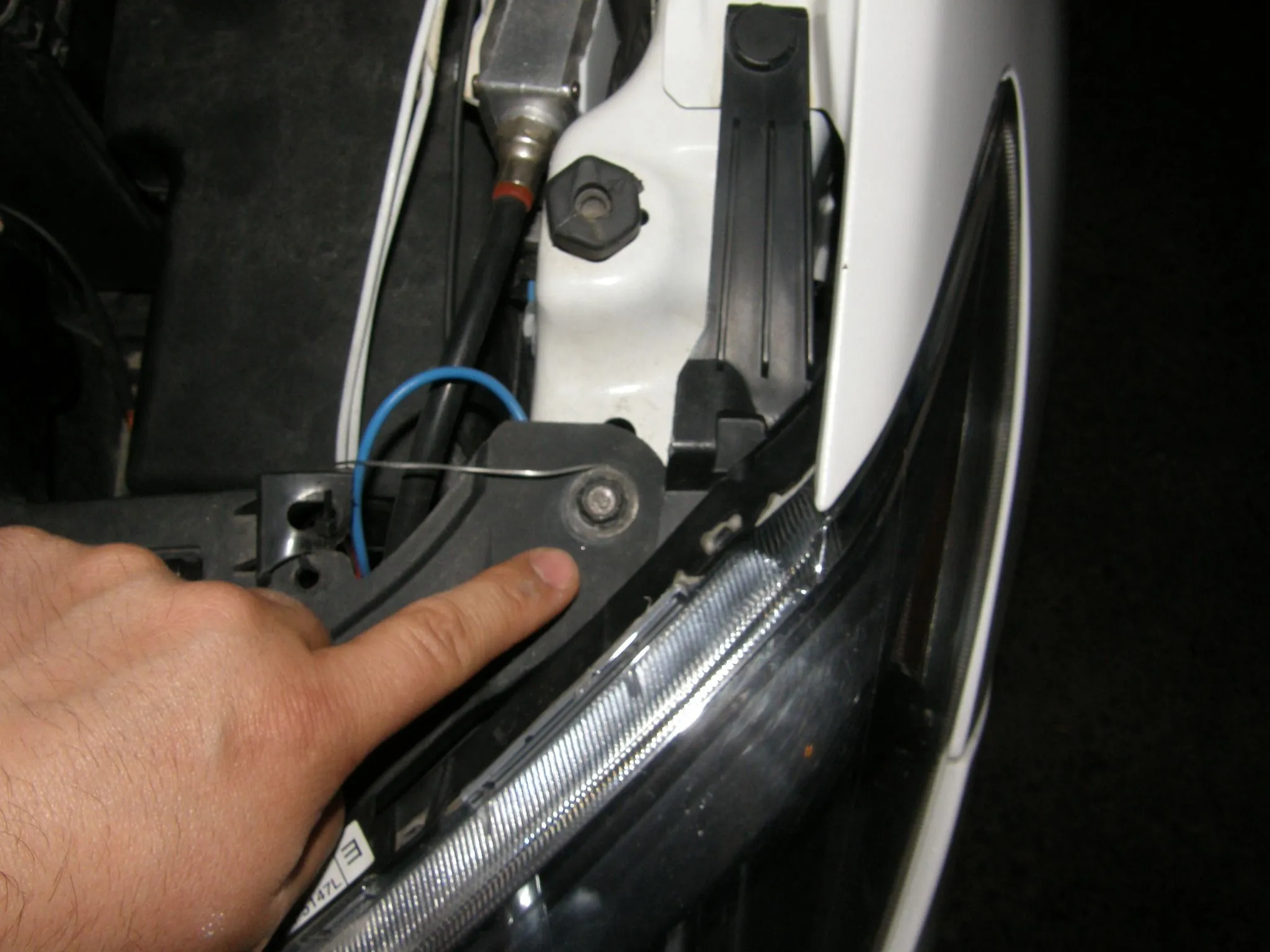

Ok....
Here are 2 pictures of bolts that you can also use as a grounding point. (pictures are left and right).
I got it right this time. Got the ground wire connected to ground point instead of connecting to OEM headlight socket. Thank you all for the help.
