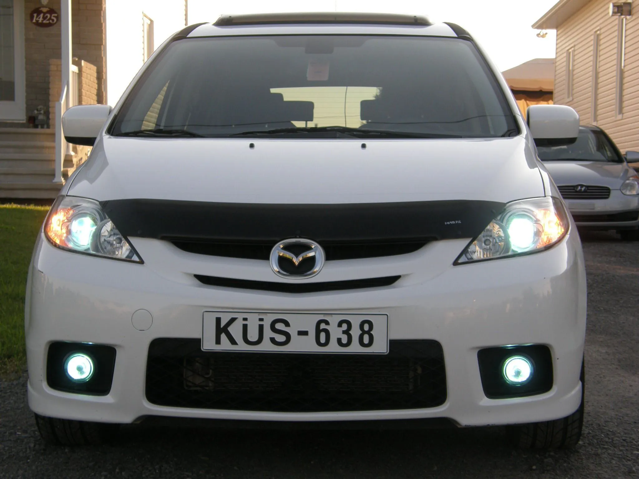

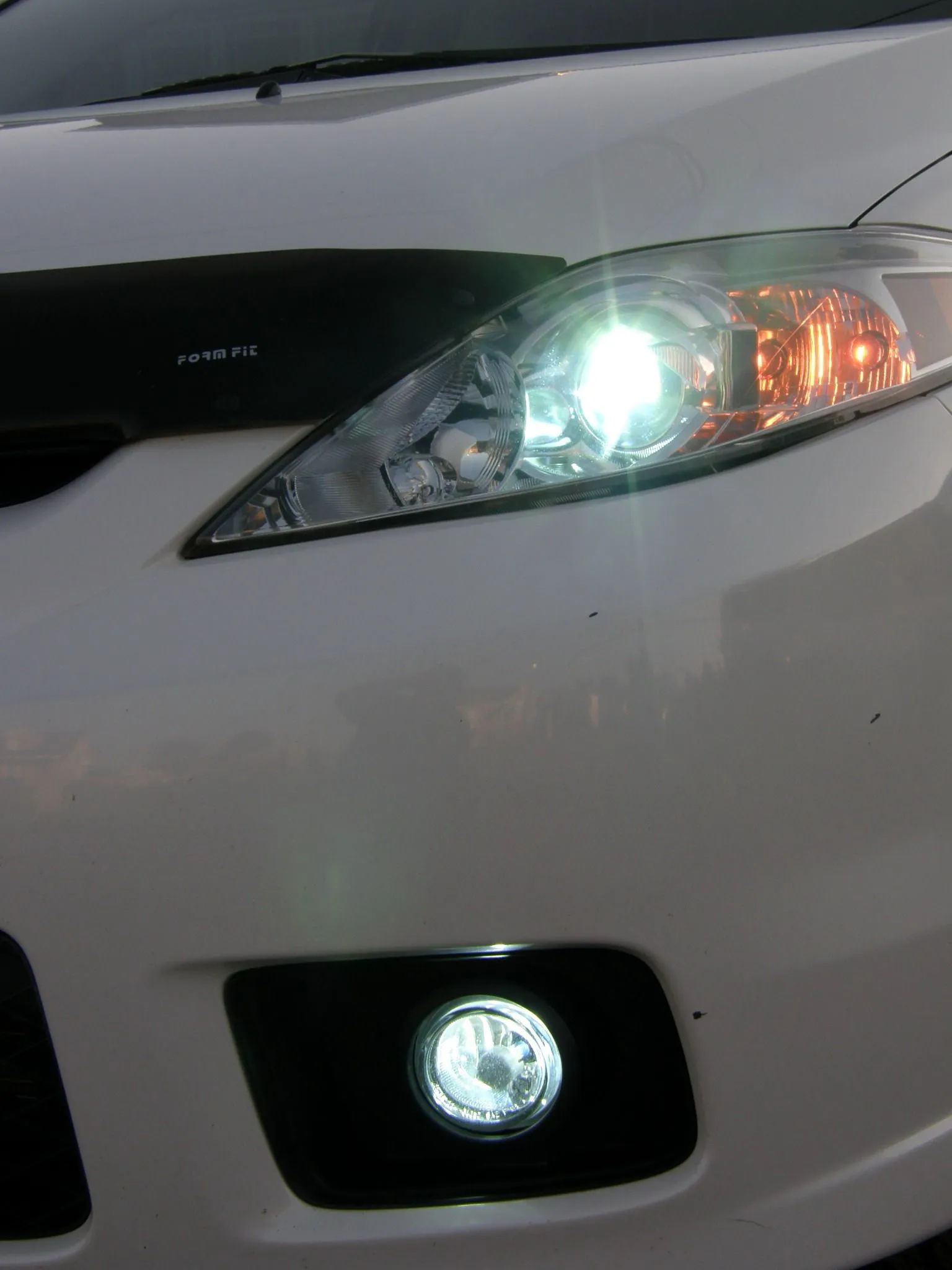

Simple advice.... If you install HID's on your fog lights, make sure you use a relay that will be connected directly to your battery, in order to give the fogs, a full 12 volts. I tried to connect my fogs "plug & play", but there was always one that would not turn on... Or it would blink all the time... Since I did that, it all works well. I'm including two pics for you to see.
