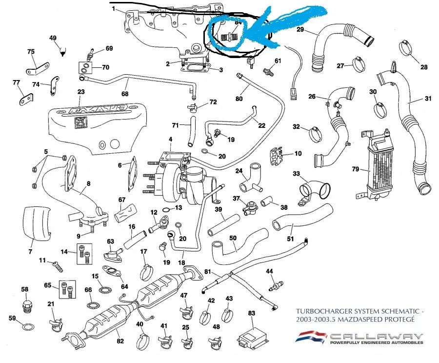

I am looking to get a hold of one of these...EGR connector thingy that connects the EGR tube to the turbo manifold on MSP. Where can I get a new or used (not stripped)? Thanks.

Dorman 917-400 MAY work, though I'm not 100%. Ford used two different diameters for their EGR tubes and this is probably for the larger diameter, though it's easy enough to order it through a parts store and visually inspect to verify if it's the correct diameter.
It's a 1/2 inch pipe thread a lot of hardware stores sell it in brass or steel.
