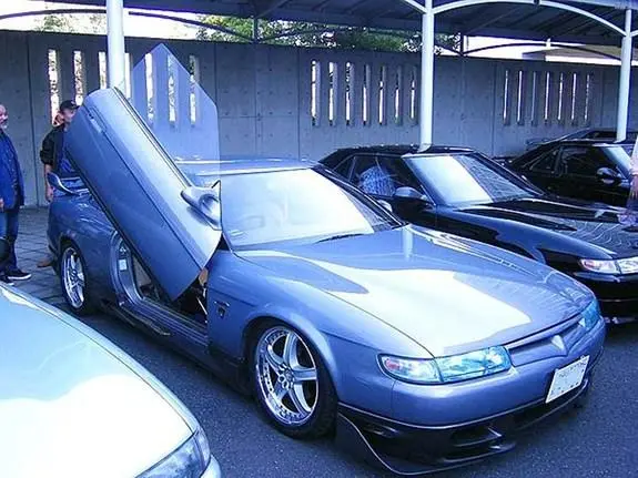

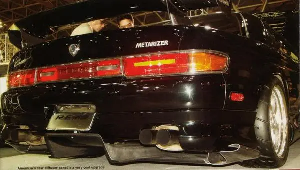

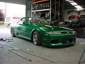

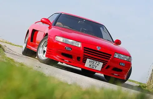

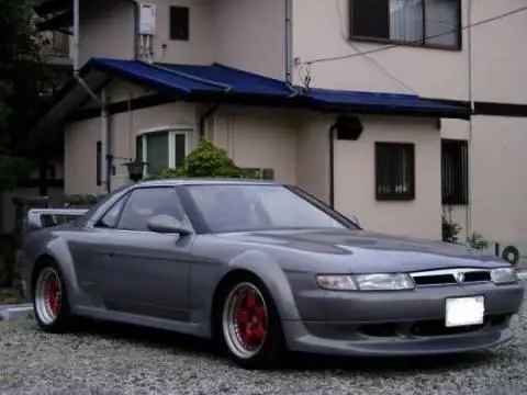

a majority of cosmo's are tuned somewhat. compared to other cars out there. not many complete builds. check out the Proud new owner of a Cosmo thread, my post there. for kits their kinda subtle. heres a few custom jobs.
