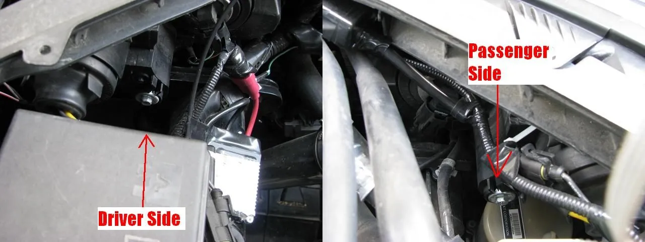

Where are thre adjuster screws for the low beams?
I switched out my headlight bulbs for some "brighter" xeon's and was highly disappointed, but the more i thought about it and looked into it, it appears they need to be adjusted up....
i cant seem to figure out how to move them up...
any help would be appreciated guys...
If this is for a Mazda3. then here:
These silver nuts adjust headlight beams up and down.
