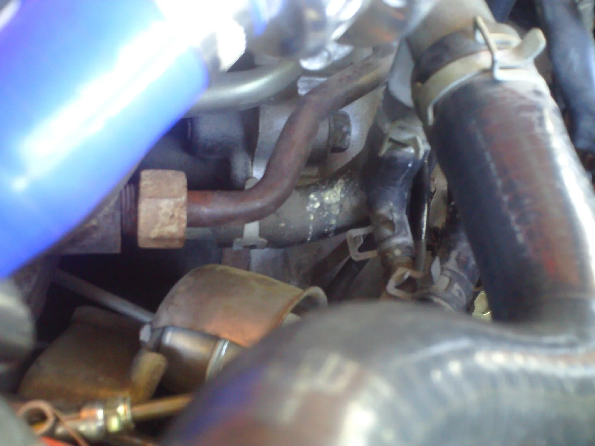

I had to replace mine too. It cost me around 70 bucks for it. Did you have the part number handy the first time...0000-88-C54.

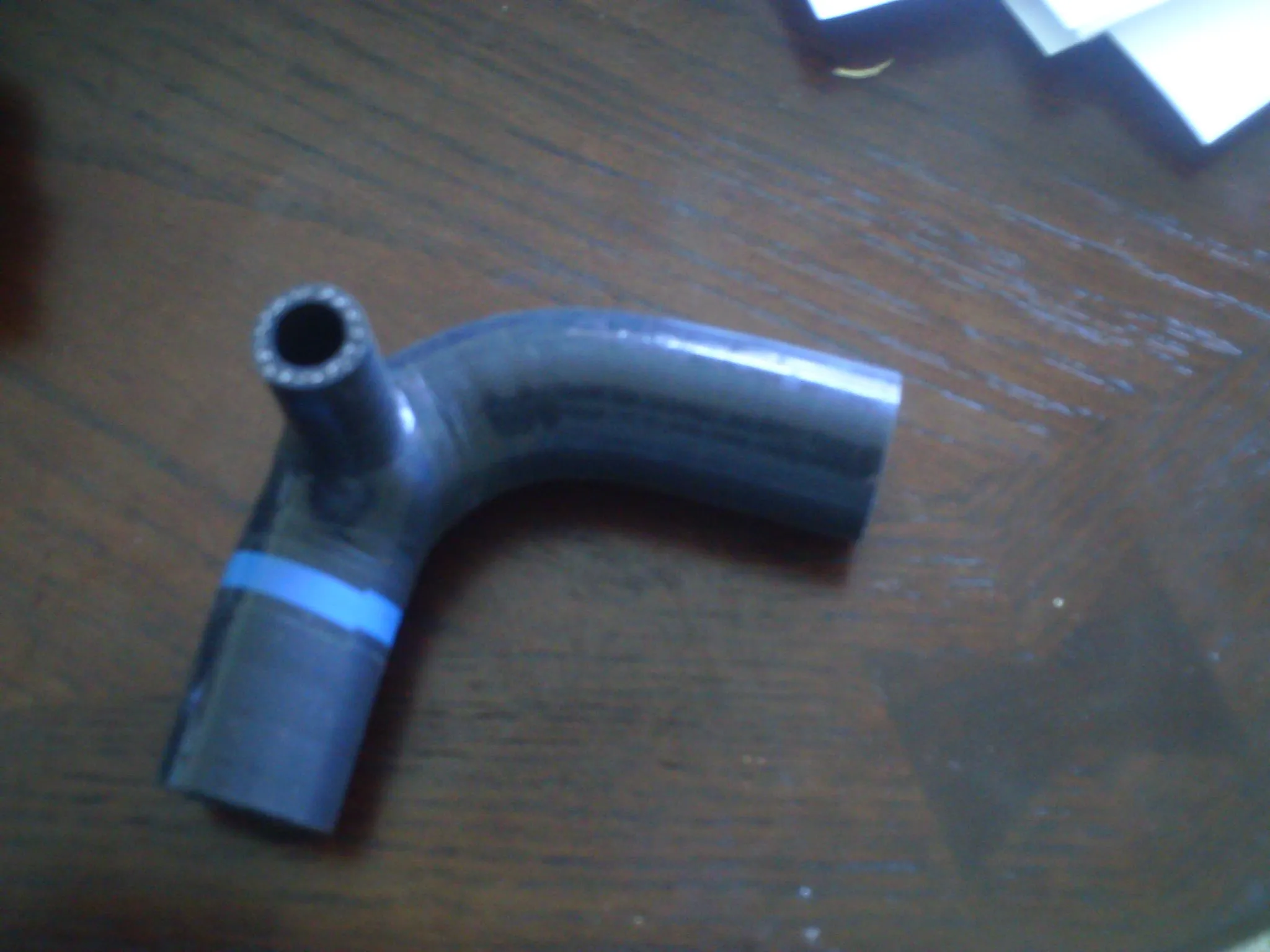

replaced mine as well.... such a low quality piece and yet so important
The one with the blue ring is the updated one. It shouldn't leak again
