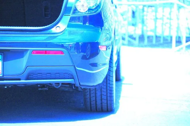

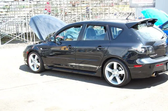

And here is a pic of the speed3 sitting on Rx8 wheels (225/40/18 rubber). The white mazda3 is on Tein Basic coilovers. It was my previous car, now owned by my little brother.
Yes, I installed them myself...both the H&R and Teins. Both setups reuse the stock upper strut mount. The H&Rs up front have a slimmer damper body when compared w/ the Teins, so you can run the wide rx8 w/o any clearance issues between the tire and damper body. Also the fact that the rx8s on 225/40/18 tires are about 0.5" smaller in rolling diameter helps too. :D
Damn Soko7...that ish is swwweeeeetttttt. How does it ride? road noise? ease of asjustability...do you recommend? Wow man...the last pic is hot...way too low to drive but awesome none the less..thanks for the pics ;)
Rides reasonably well for the drop. The drop amount is only about -1.8" front/-1.5" rear. Relatively, the sedan is dropped more from stock than the speed3. The sedan is dropped approx -2.1" front/-1.8" rear, and on springs w/ a linear spring rate. The spring rates on the H&R setup are progressive, so that helps the ride a bit.
Both setups are height adjustable (duh!), and have no dampening adjustability. Height adjustments up front are easy, but for the rear it becomes a bit more involved if you drop it more than 0.75". The more drop you go w/ the rear springs, the adjustment collar starts to tuck up into the crossmember spring cup. Therefore if you want to adjust the rear more than 0.75", you will have to remove the spring from the vehicle ... set the collars ... reinstall.
Oh and that's the daily driven ride height, I'm just extra careful ;)

Here are a pair of reference pics against the MS coil overs with RX8 wheels and 225/40/18 tires. Second pic shows the offset better.
The car is almost all the way down in front and has about 10mm to go in the rear. Not sure how much lower the H&R's go but the two cars look to be at almost the same height. Also love the separate compression and rebound adjustments.

As pictured, the fronts had quite a bit more to go ... about another 1" worth of threaded body to max drop. I haven't built up the courage to go that far down yet and drive it, I might do it when I start to run the Rx8 wheels fulltime. Currently I rub the front tires on the inner plastic fender linings but only on very sharp turns low speed turns. Since the rx8 wheels are a bit shorter, it may be possible to roll it out of the garage...but I don't think I can exit the driveway. :lol: The rear has about another 0.25" worth before it is maxed out. Price that I got the H&Rs for was around $1100.
