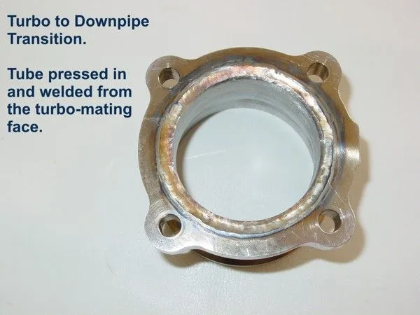

usually with downpipes u have your flange |- and a pipe butted to it (placed against), and welded around the perimiter of the pipe. this creates a "step" in flow. you have your opening from the turbo flange, then this open pipe all of a sudden. its not a smooth transition. The way were doing it is, you form the downpipe to the same shape as the flanges opening, and stuff it in the pipe and weld it up from the inside. So now you have a smooth transition from the turbo to the downpipe.

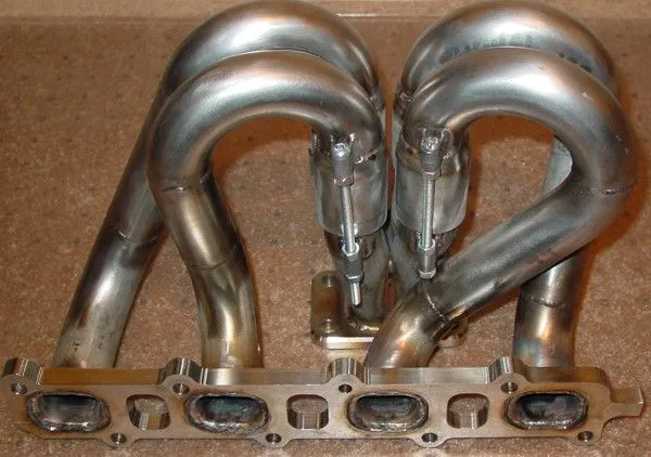

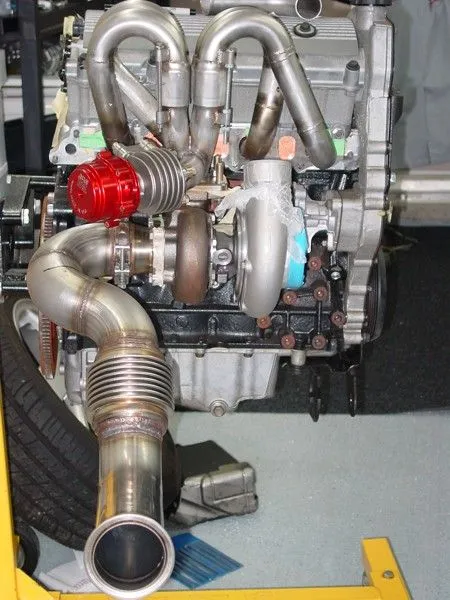

thank you. thats my plan, make it once. I cant say it will never crack, as that would be foolish, but i will do everyhting in my power to stop it from doing so. i think between the mani bracing, the molded pipes, and the braced downpipe we will have a solid piece.
since were at a standstill for information untill i gather parts. i got some pics from one of the shops cars.
I cant show you the rest but this is a testiment to their work quality. Enjoy.
edit:
in case anyone is wondering what the nuts and bolts are on the mani are, those are to allow for thermal expansion. Yet another detail to help stop cracking.
