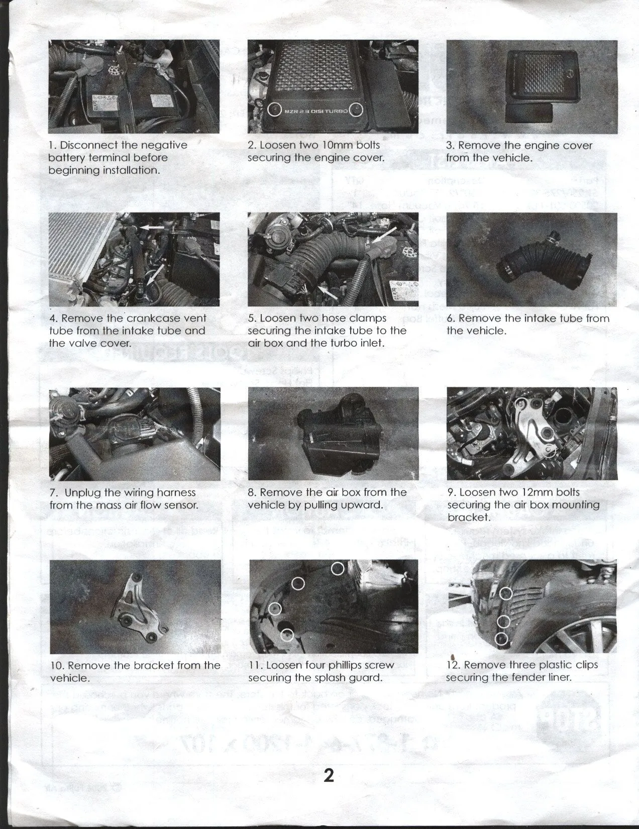

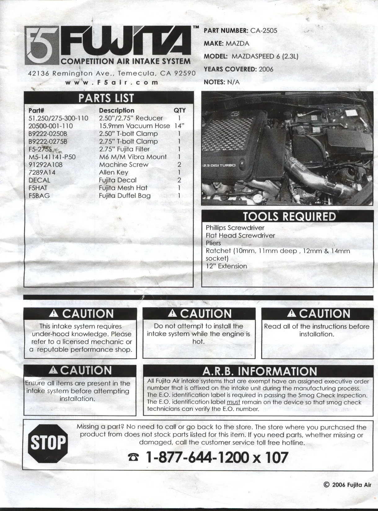

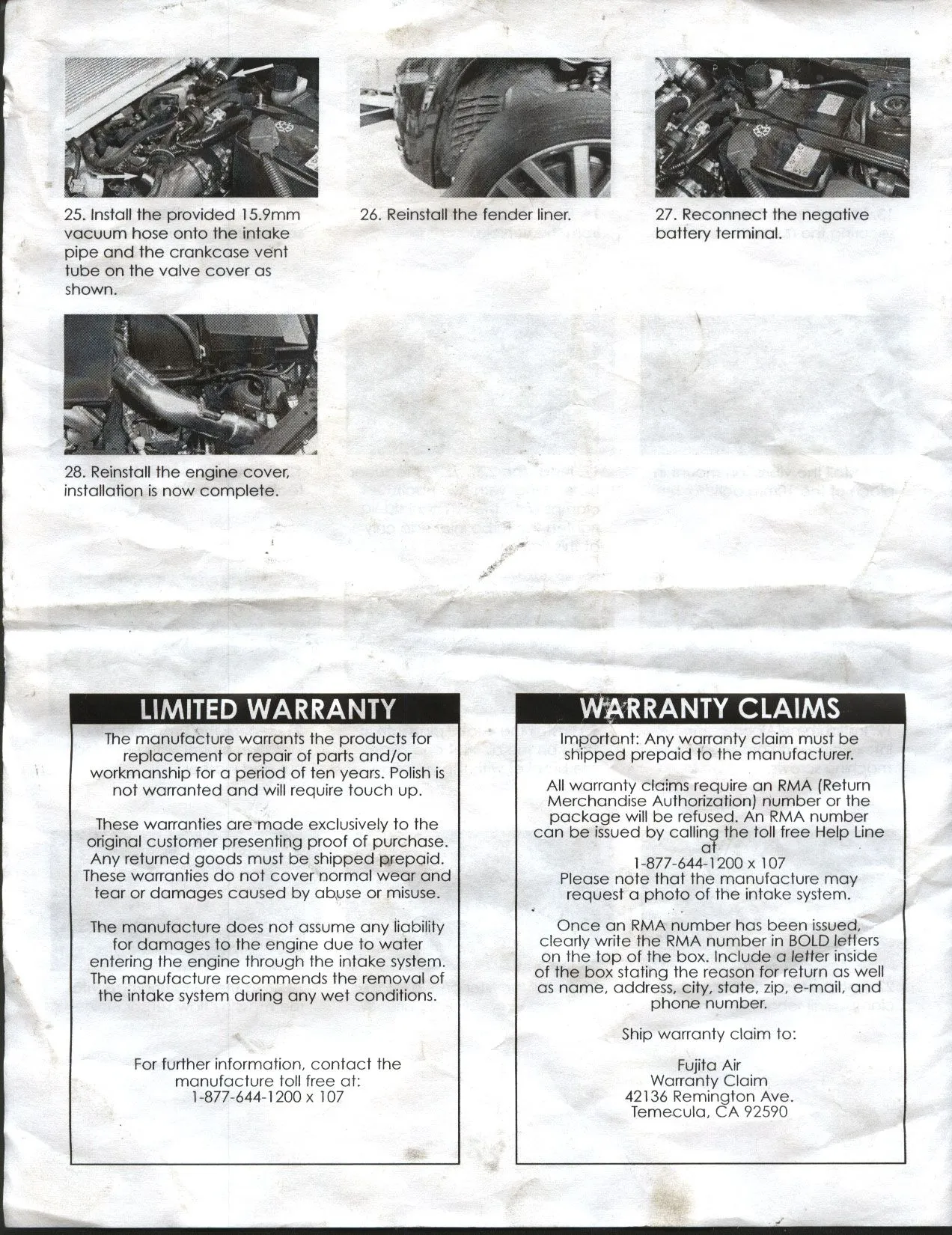

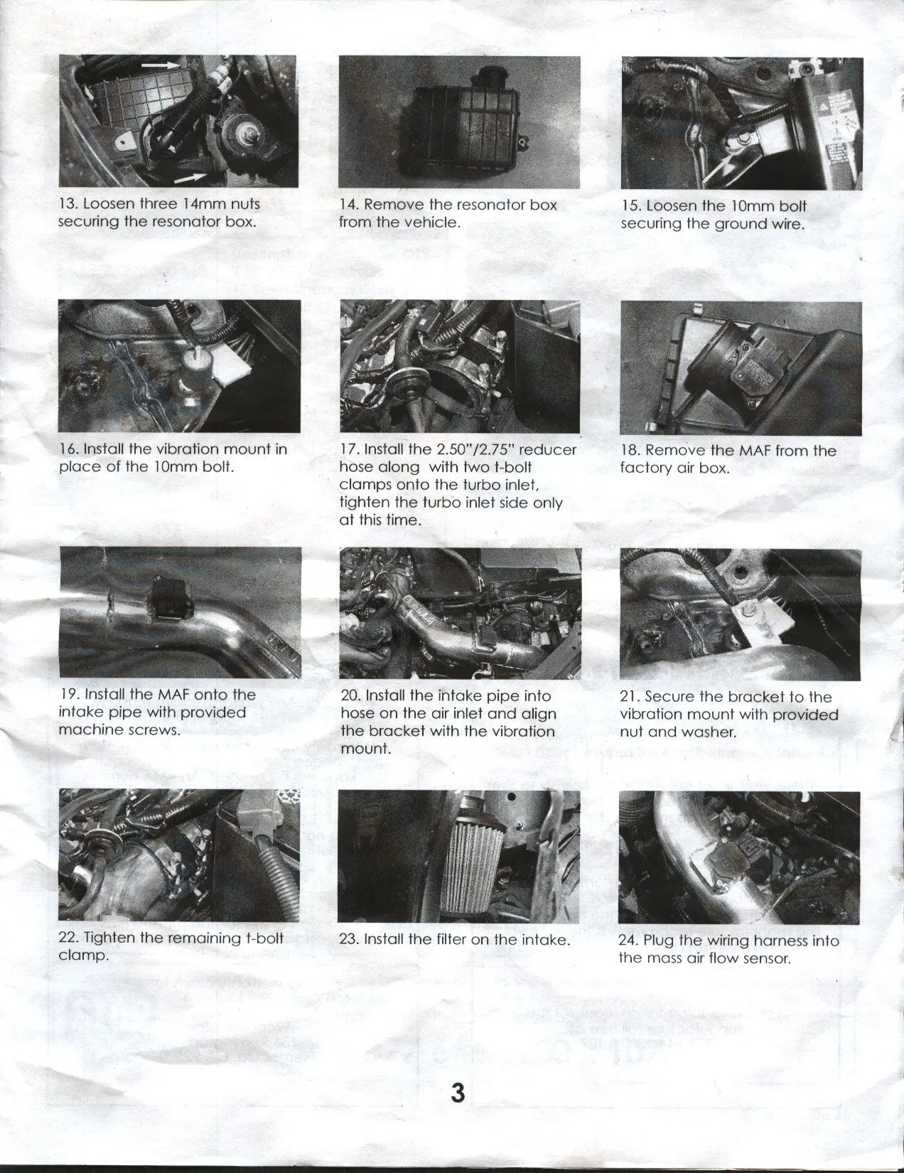

i finally got the CAI today and here are the instructions it came with...
if you guy see anything that you can to for more detail please do so.
