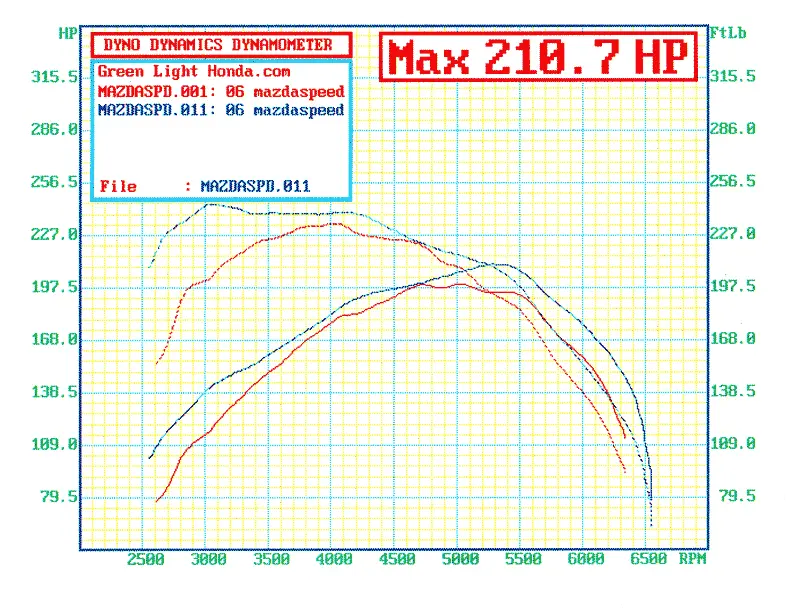

A dyno i found for Fujita F5 CAI for MazdaSpeed6.

disappointing number considering ive seen stock dynos yields the same.. if not more than that..
yes but it has already been proven that cai arn't resulting that big of gains over stock...this goes for other cai not just fujita.
Guys, look at the before and after and you can see gains there - it doesn't matter what the #'s say as it's all relative. If you dyno higher on the same dyno with a CAI than without (as it shows), then you've got gains.
I've got my CAI and I've removed it once and then put it back on again and both times the improvements ARE noticeable - you just pull harder once the turbo spools.
Dont look at the number it put down, but the comparison between stock and CAI.
(gun) I can't tell you how many people getting stuck on the number and not the difference.
understood.. im not wet behind the ears...
my comment is based on my assumption that the difference indicated were not taken as before and after runs..
but of multiple runs with 210 bein the hightest.. apologies if im mistaken..
that's so true...#'s really don't mean much unless the same dyno is used..under same conditions (humidity, weather)..etc.
Also, if it's it's SAE corrected..and if used any type of smotthing software
