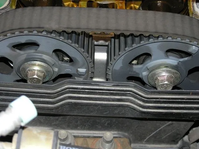

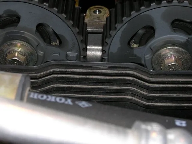

The next step will be checking the cam timing. Based on the posts here and an online manual, this can be done without removing the front cover. Once the valve cover is removed, the engine will be rotated to find TDC of the compression stroke on the number 1 cylinder. Then the alignment of the marks on the cam sprockets can be checked.

Well, the valve timing appears correct. This was checked by removing the valve cover and spark plugs. By placing a rod in the number 1 cylinder, TDC was approximated and the lines on the cam sprockets appeared to line up. TDC was matched by a notch on the crankshaft pulley lining up with the 'T' on the timing belt cover.
