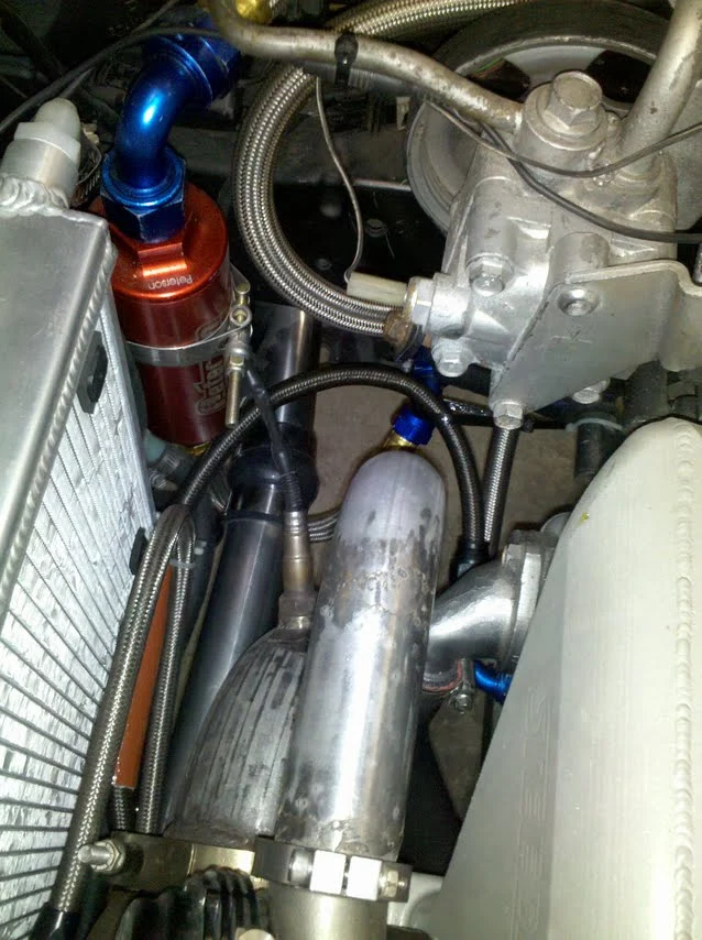

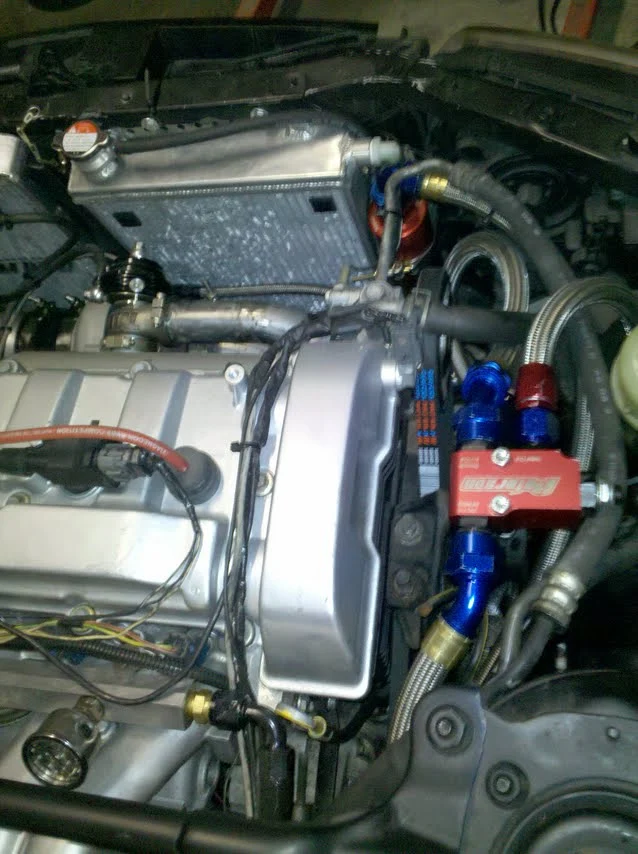

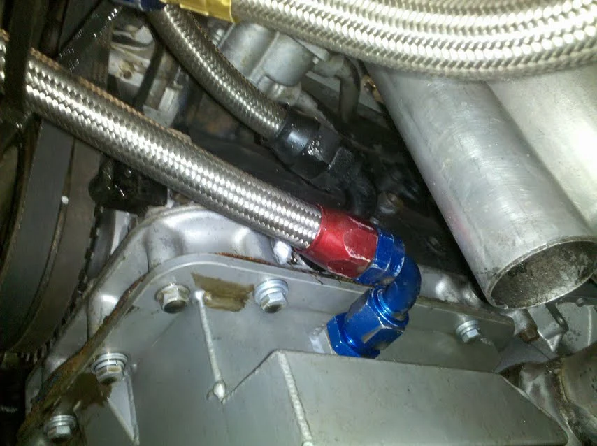

here are some photos of my system. BigLou is absolutely right about how easy it is to tune. relocating the oil filter is a must for our car. plus the extra capacity is nice.

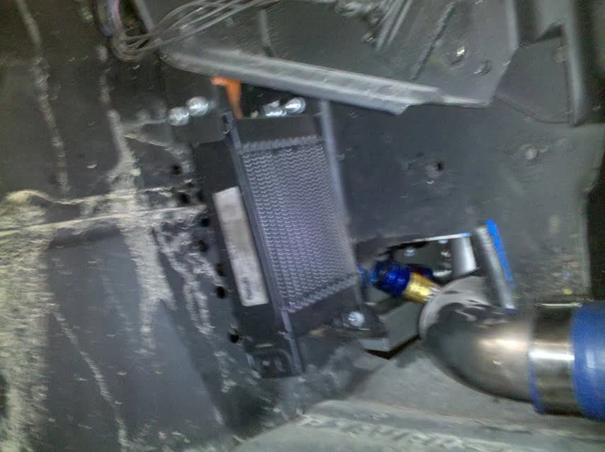

the Setrab oil cooler is mounted in the passenger wheel well, where the wiper fluid tanks USED to be.
I decided to go with the bigger AN -12 oil lines and fittings. I am here to prove that pressure is NOT an issue with the coating treatment. I can run well over 90 psi oil pressure at 5000 rpm! didnt do it on purpose.
the huge peterson oil filter kit is working very well. its a reuseable stainless mesh filter that will eventually pay for itself. easy to clean and get to.
anyone even thinking about turbo-ing their ride better do this mod now, or pay big time later like I did.

Did you just delete the wiper fluid tank or did you relocate it? I notice there are holes in front of the cooler, did you have to make those? How is air flow in the fender well? Are you still running the fog lights?
baller dude. i'm excited for this. i need to buy it.. they make reusable oil filters for my busa. which i'm excited for... but do they make that kinda thing for our car? cu i'm looking for a spin on reusable filter.
I deleted the fog lights and wiper tanks, but there is room for both depending on oil cooler size. On the drivers side I used my old AEM CAI for a ram air into the new intake. On the passenger side I am using a straight 3" pipe to direct air to the oil cooler. The holes drilled behind the oil cooler allow the air to flow thru. I just used a step drill bit for that.
