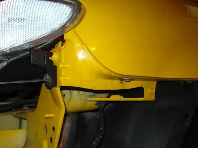

Where does the bottom hole screw/go in to? Top two screw into the fender, but that bottom one sticks out when the bumper is installed. Figured it should be tucked in somewhere

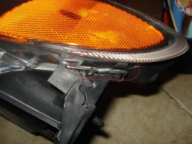

where is this clip located or suppose to be in this pic?
there is actually a bigger clip like those on ur door panel. 2 of them if i am right.
Right here. There should be a little tab right under the turn signal portion of the headlight that snaps into that hole.
There's a good chance that it's broken though. If you didn't know about when taking off the previous bumper, then you most likely broke it while removing it. They're really easy to snap, but they're also only like $7 from onlinemazdaparts.com
hmm i dont see this clip on either side, never was as far as i can remember. any pics of this clip would sure help
ah, I finally see. I checked the other stock headlight and I see whats missing. My aftermarket headlights did not come with those clips. Guess maybe I was suppose to transfer them from my stock lights. Damn, i've been clipless for like 3 years.... Thanks for the info
Yea it's not a part of the headlight, you're supposed to transfer them to the new ones. Onlinemazdaparts.com has them for like $4.xx each + $6 shipping. So ~$14 shipped for both.
