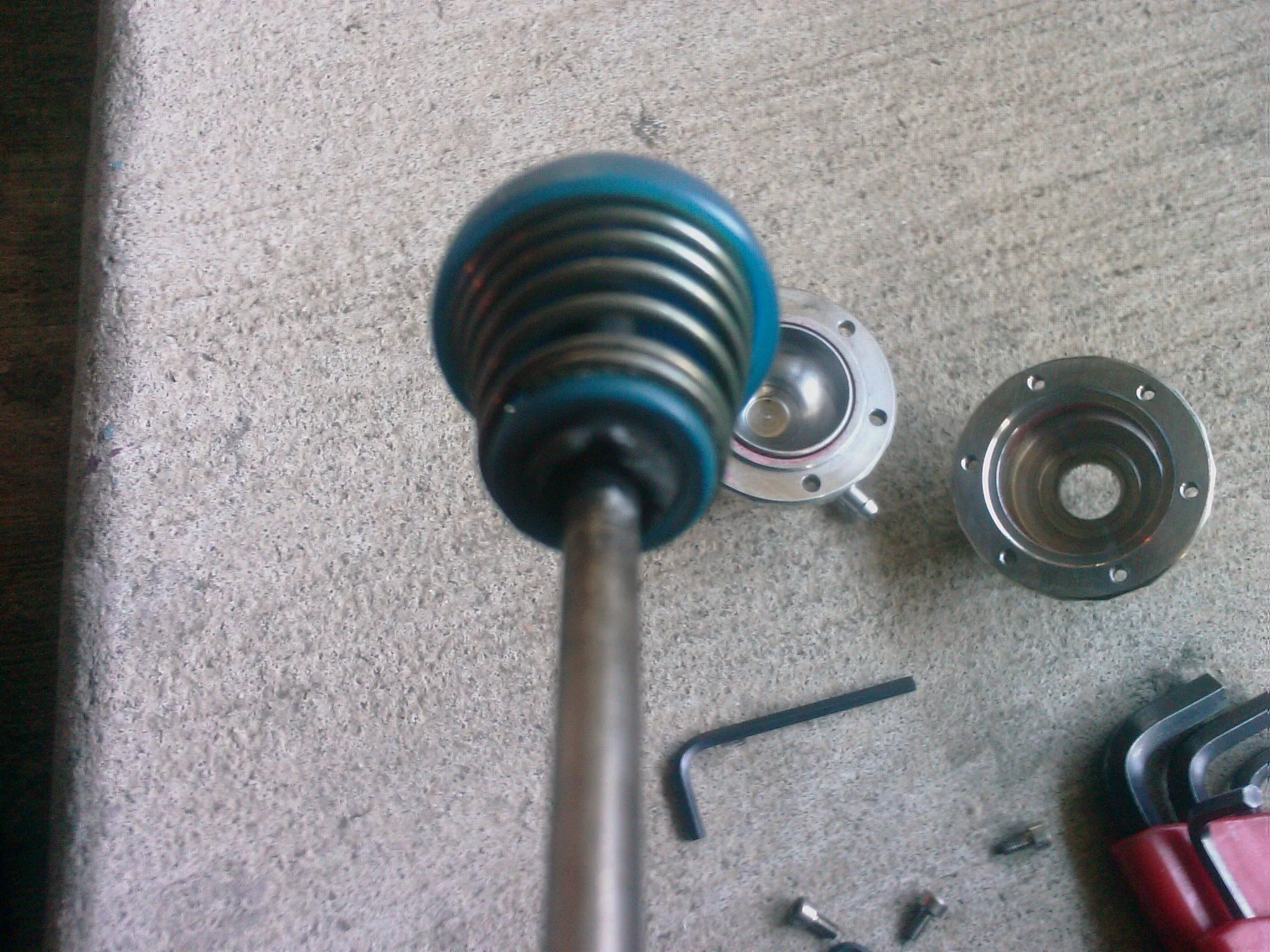

Had a forge wga installed for about 5 months without any problems, however recently started to spike. With the greddy EBC at 10psi, it spiked to 11.5-12.8psi. At stock boost of 5-7psi, it spiked to 9-12psi again. I tried to blow air thru the vacuum tube to the WGA and there was a slight give.
Has anyone else had a forge wga fail on them?
Forge told me that the rebuilt kits are oos.
Also I took apart the wga today myself after my mechanic ***** me and charged me $185 to do the same thing last week. And I have a quick questions.
Is there supposed to be some play with the actuator arm? And with the WGA opened is the blue cap supposed to be attached to the metal piston?
