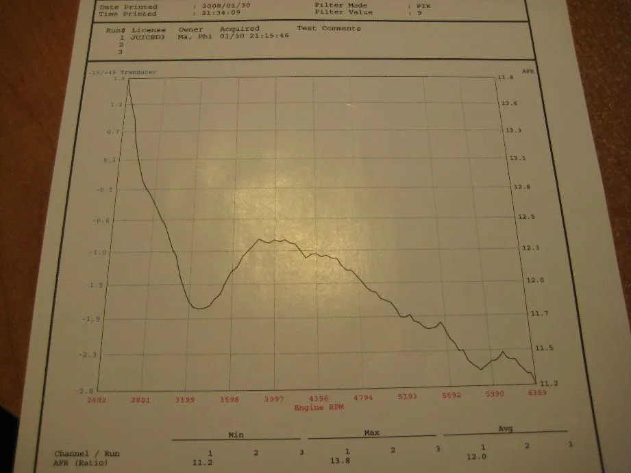

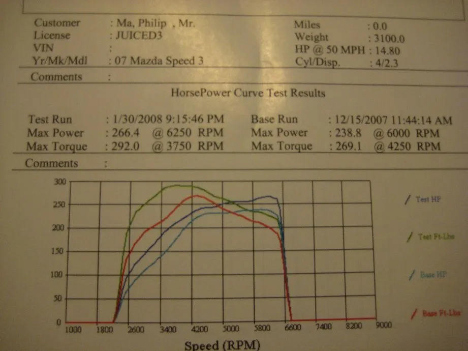

Dyno results?
on a mustang dyno....no fuel cut....car never pull harder before.....i know anthony(driver311)'s car got a better number with less modd than mine.....i have no clue why but im really happy with the result...gonna play with this setup this season....next off season will be turbo upgrade....=)

Damn, with all your mods I would have expected more HP/TQ... (huh)
mustang dyno are famous for heartbreaker....one of their subbie sti dyno at 320whp on the mustang and jump on a dyno jet on the same day back to back get 380whp...
how did that happen without a CDFP??
the tuner told me he can make the car run stupid rich with the stock fuel pump...but he did said sure it will help with a high flow fuel pump....and a better ecu tuning....hes talkin about cobb ap....they are a cobb dealer... i expected them to said that....but he said over time the oem ecu will learn and counter what the piggyback doing.....who knows....but i know im happy with the set up right now....next off season project will be turbo upgrade/fuel pump
Really? Mustang's read pretty low. I think these are great numbers for your mods! I just pulled 215/253 on a Mustang with just the Cobb SRI.
(hand) damn, overlooked the mustang part... So I would assume on a Dyno Jet you would yield over 300...
I retract my previous post... (lol2)
yea...but the number is still way low compare to driver311 311whp 371tq only with modd air box/test pipe/mbc 18psi.....i wonder did he ever get dyno again with all the new modd....
