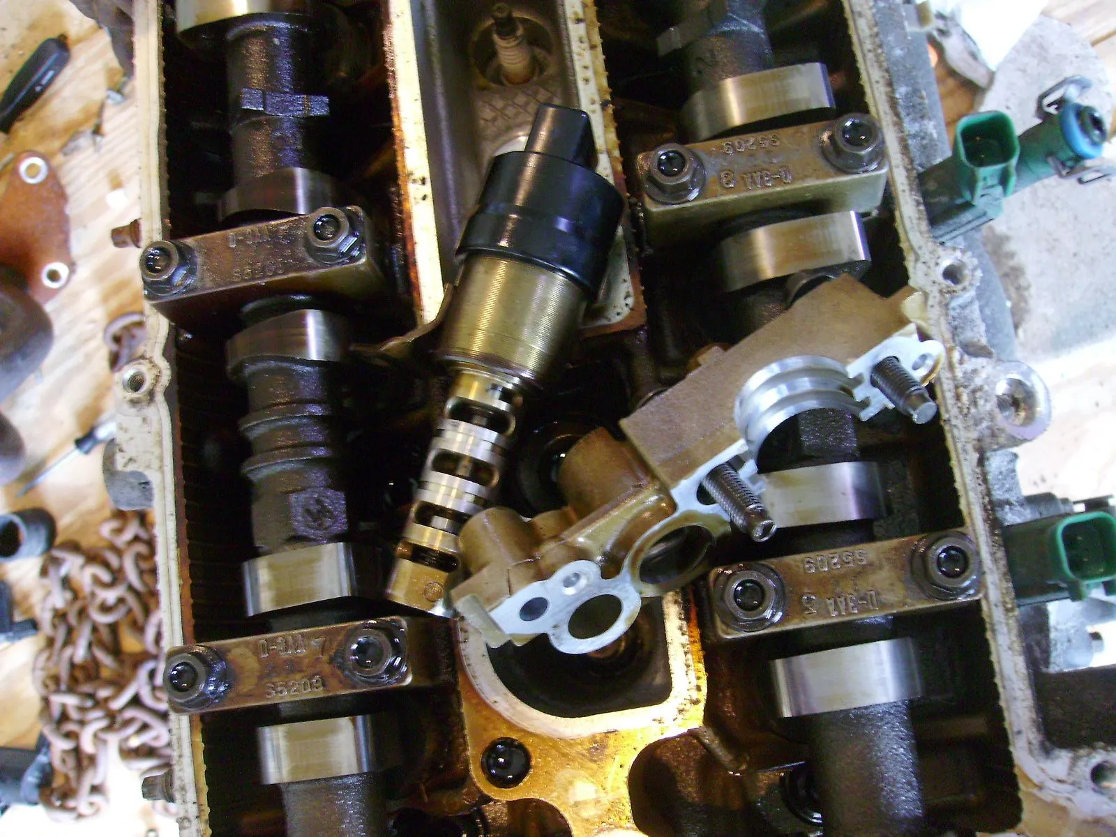

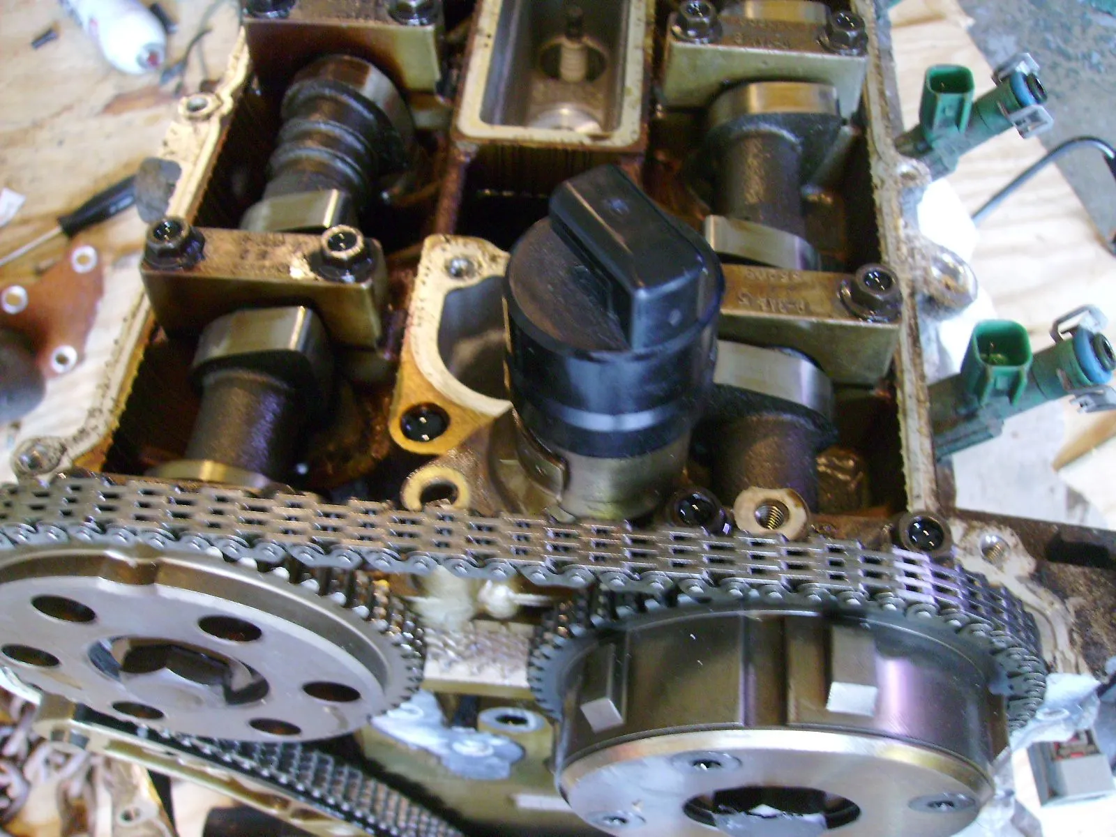

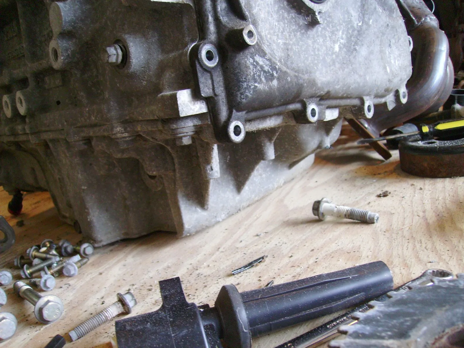

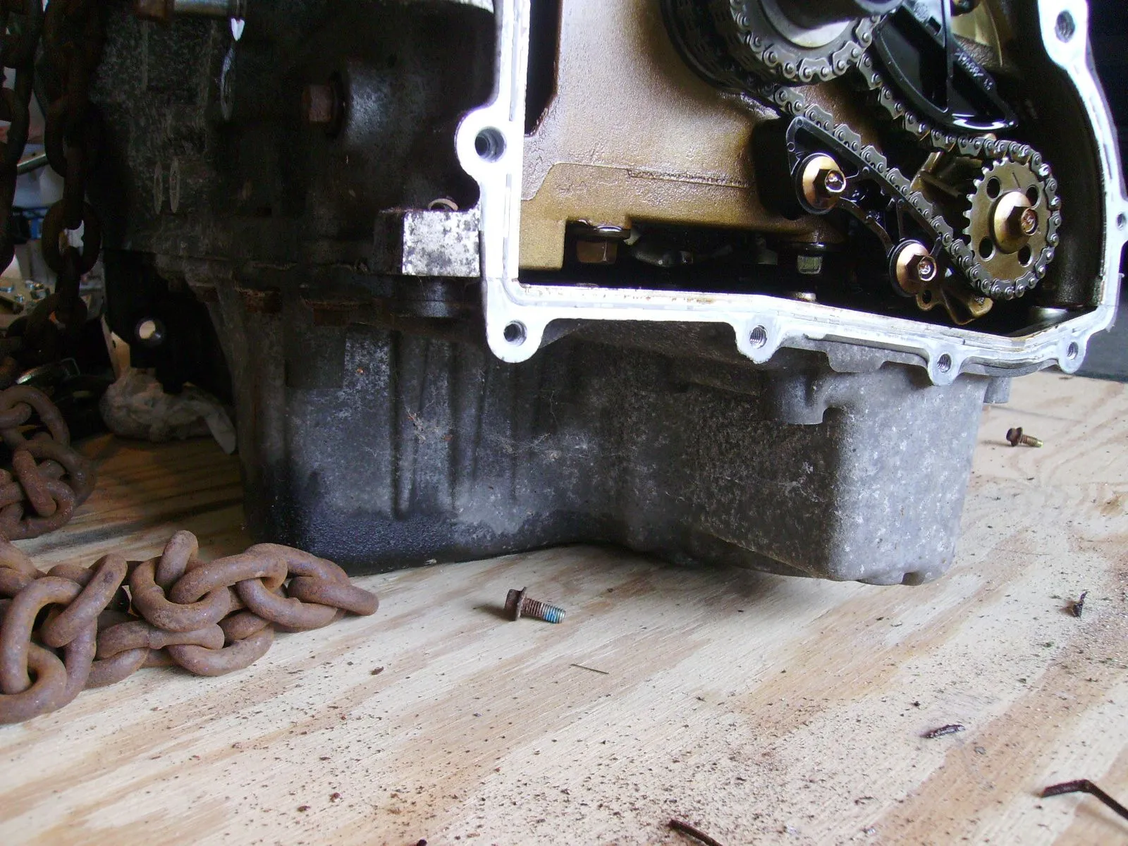

Ok I am putting a 2006 2.3 ford engine in a 2004 mazda 3. ok that part is easy. My question is I have to use the mazda oil pan on the ford engine do to the ac pump bolts on it. And the ford bolts on the side.The pan fits great but it just looks like there is a lot of space gone from it ( do to the cut out for the ac compressor ) will they be a oiling problem ? on the mazda engine their is a 2 wire something on the cam that sets right on top of the cut out area of the oil pan. if that makes any Sense. And the ford engine don't have any thing like that. So is what ever that is on the head right next to the cam have any thing to do with the cutt out of the pan? or will i be ok useing the mazda pan on the ford engine? The first 2 pics are of the mazda engine. What does that do? The ford does not have that .The third pic is the ford engine oil pan. And the last pic is the mazda oil pan, Thats the pan I have to use. Because the AC commpressor bolts there.. The AC lines are too short to mount it on the side.what do you guys think? thanks for the input

ford engine doesn't have variable vlave timing, balance shaft, and some other mazda characteristics, i've only dissasembled one for 2.3 and it was a while ago so there are many things i am forgetting.

Well I got the engine in and done it sounds great. But this focus engine seems to and more power than the mazda engine did? Has any one else made this swap? O yea by the way that was a 06 engine.
