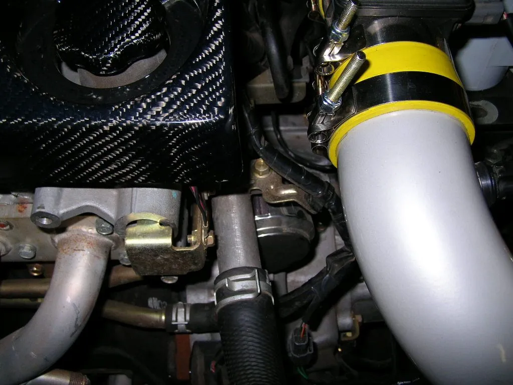

Far as I know...it's been like this for 2+ years now. When we pulled codes before the only one we got was for running no cats. Fixed that with Vielster's resistor. No CELs since (shrug)
Anywho, I've attached a pic, but it's sorta hard to see. The EGR tube was not going to mate up with the Bosal header so we plugged it at the header (small rectangle), cut the tube back and put one of those small shrouded filters on it (larger rectangle).

MPNick said:
Drill and tap the exhaust manifold on top of the number # running. Get a brass adaptor thats 1/8th pipe to 1/4 flare{brake line}.
Will brass hold up to the heat?
run a 1/4'' brake line to the egr valve. Use exhaust air tube hose and two clamps and you are done.
What's exhaust air tube hose? Where can I get it?
Do you have a closer picture of the filter? Do you ever get any stalling issues?
Closer picture? Nope, but I can attempt to remember to take one when I get home! (boom07)
Stalling issues? Never.(thumb)

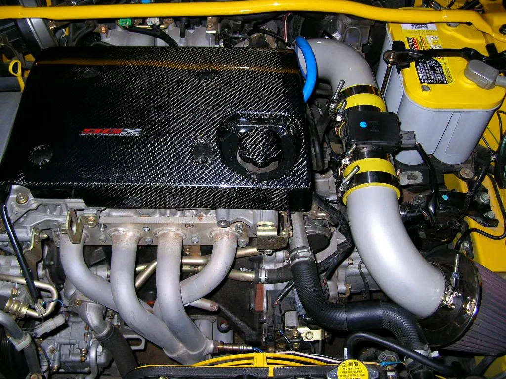

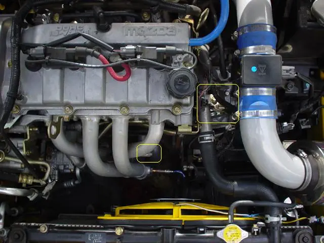

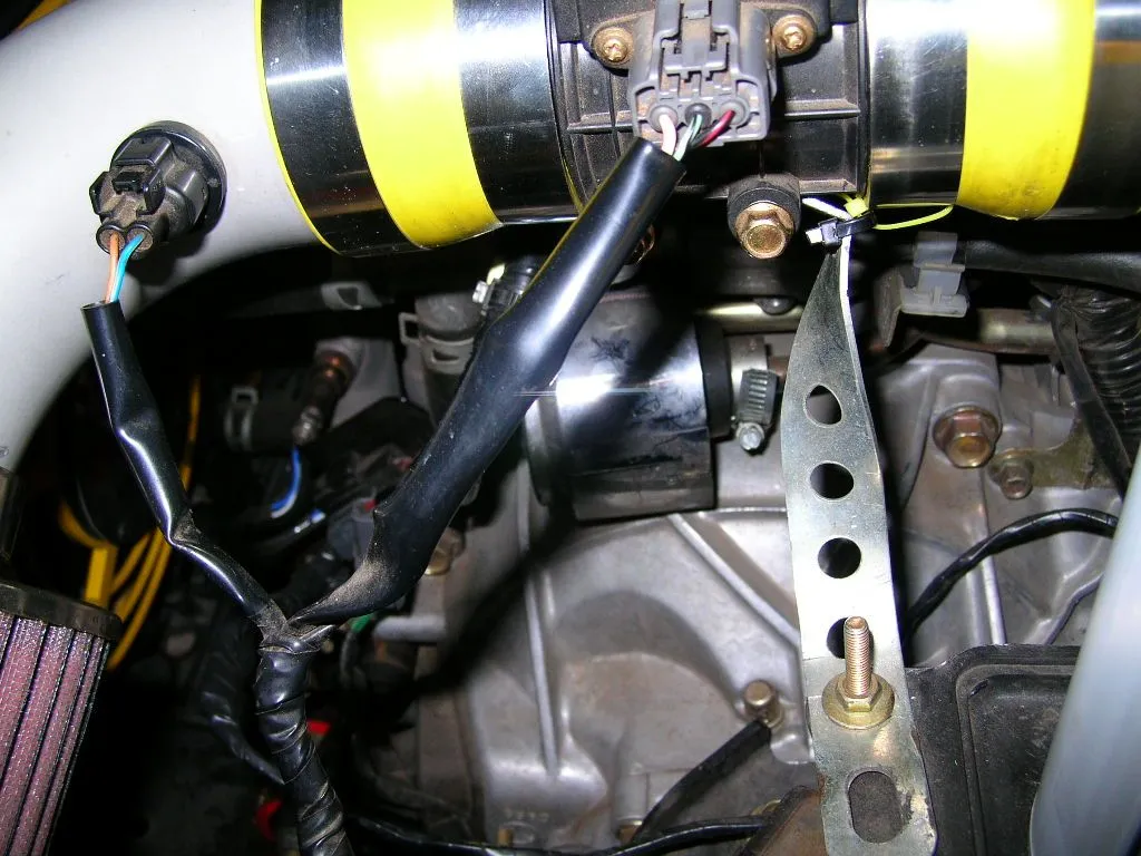

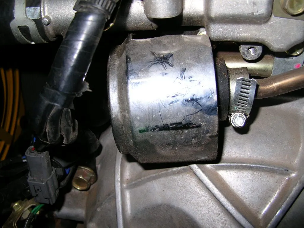

Okie-dokie. Here are the requested pics. The filter is one of those small shrouded K&N filters, most likely the breather one (gift from friend!).
Please forgive the twisted bracketry and overall dirtiness(thumb)
Ahh, I see. I may give that a shot. Thanks!
