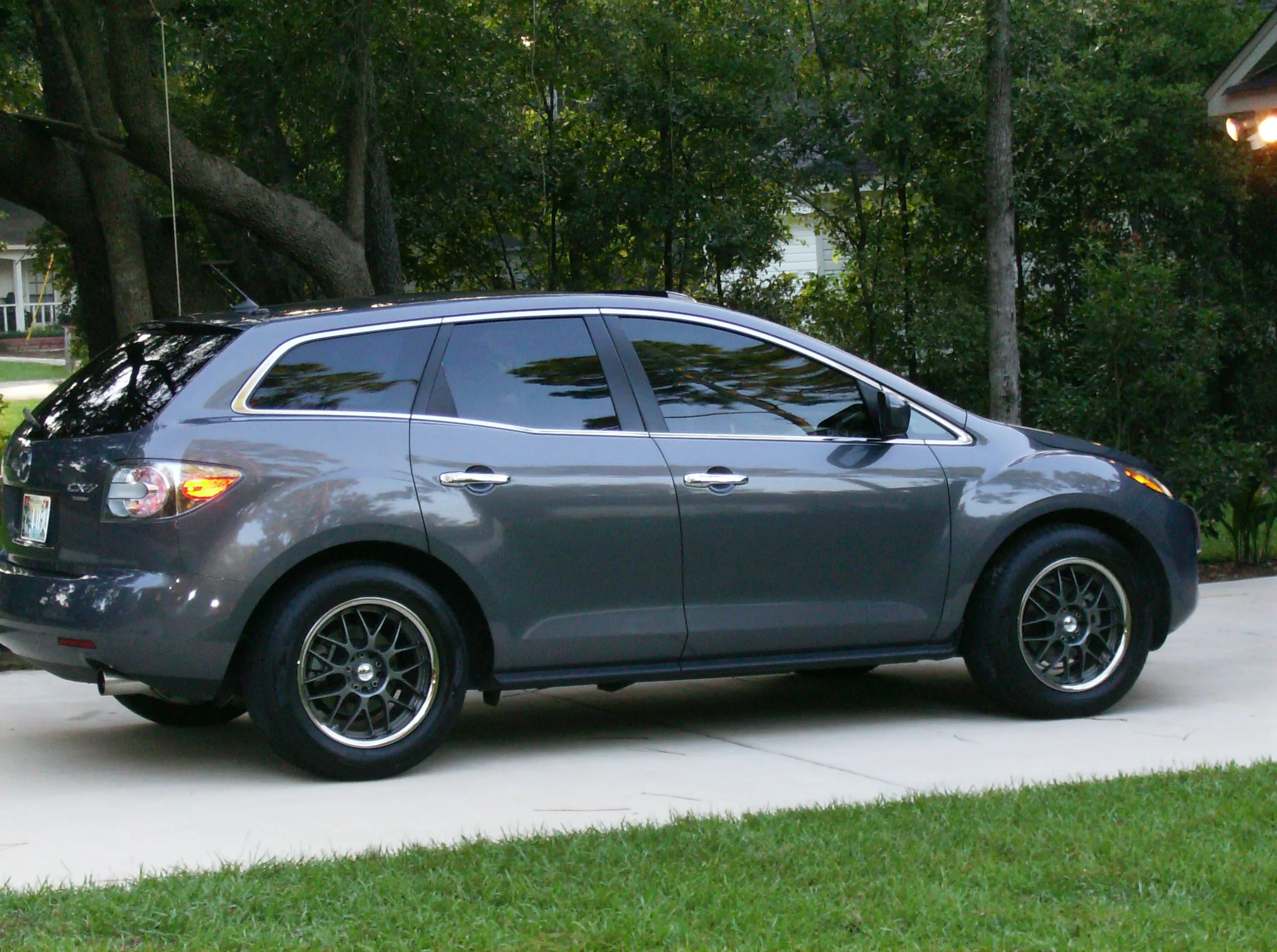

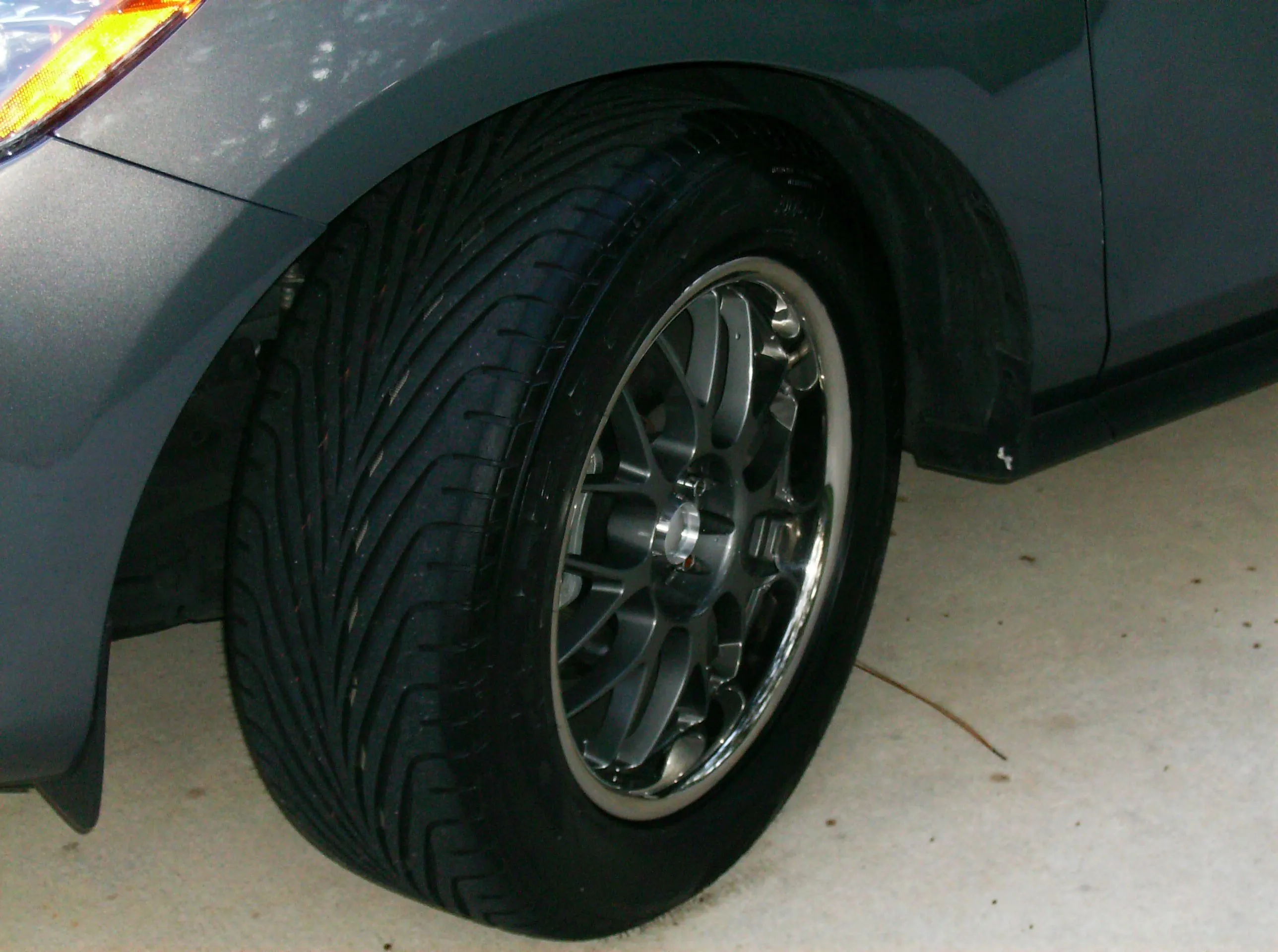

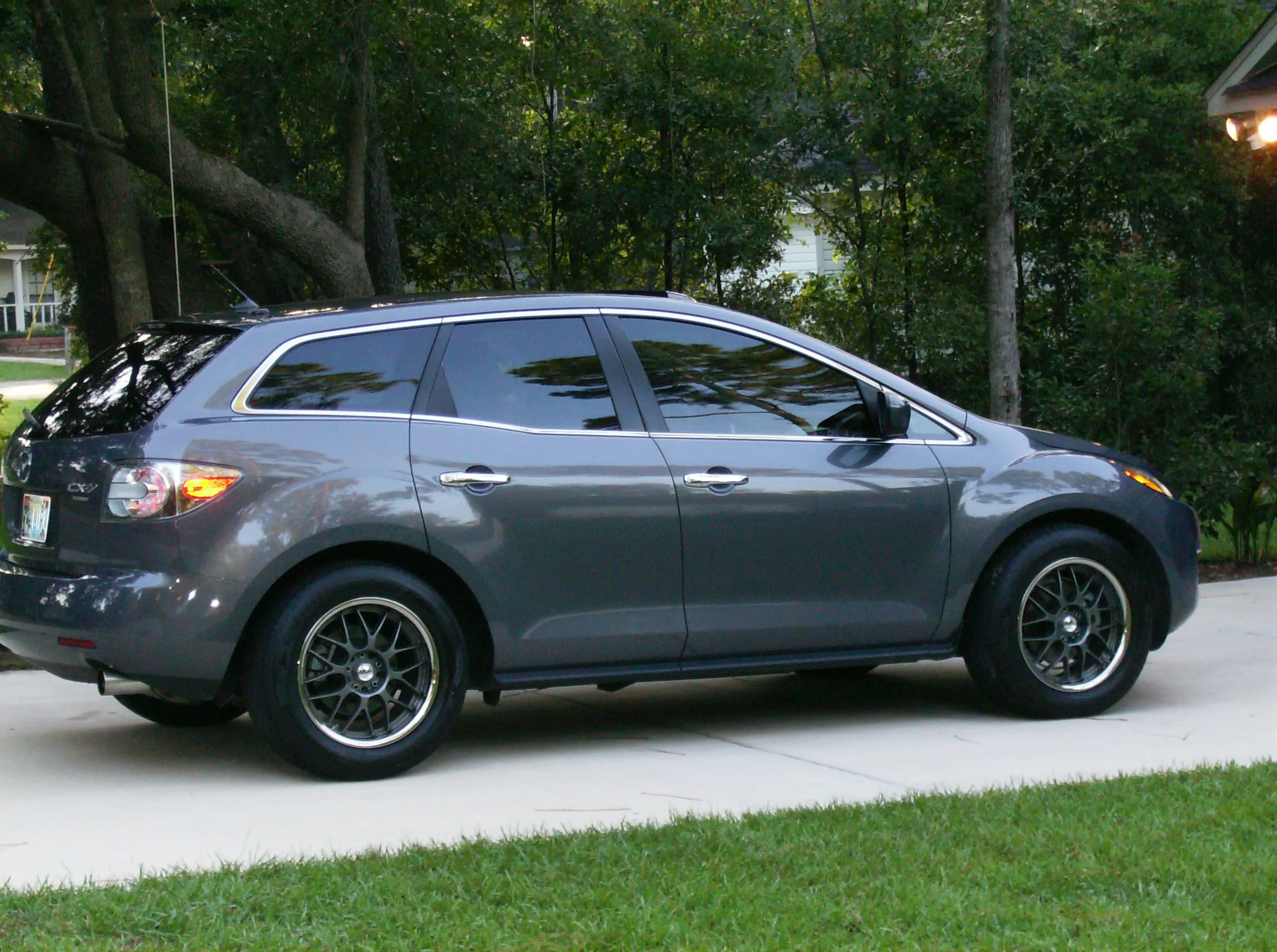

I have a new digital camera and I will try and take some pics today and get them posted some time over the weekend. I have really enjoyed the performnance of the cx with the sport springs. It really corners on rails and has not made the ride harsh. I have been driving on the sport springs for a couple of months and love them. On another subject, has anyone purchased the CP-E standback. I was wondering if it made a noticeable difference in HP gains with the increased boost. I was considering getting the new CP-E QuickPower Pipe and Dual Cat exhaust but if you can get better gains from an aggressive tune with the StandBack, I might go for that instead. Who am I kidding, I'm sure I will end up with all of this stuff on my cx over the next few weeks. I can't help myself. This cuv is too much fun.

AutoExec Sport Springs
I have 255/55zr18 tires on my cx so they are lower profile than stock. You can really tell the difference when you pull up next to a stock cx or another cuv like a lexus rx330 with 8" of wheel gap.

lower CX7
Hello, good pic's,
With new spring, do you ajust alignement of the 4 weels ?
Do you observe change when you load your CX7 (many luggages or 5 peoples on board)?
No, I did not have an alignment done but I have been keeping a close eye on tire wear to see if I will need one. So far so good. AS far as putting a load in the car goes, I can't tell a difference in the spring rates. Yes, they are lower and will drop the cx about 2 inches under stock but the stiffness (spring rates) are said to be the same as stock and I would have to agree. The car handles better because of the lower center of gravity but the ride quality is the same.
