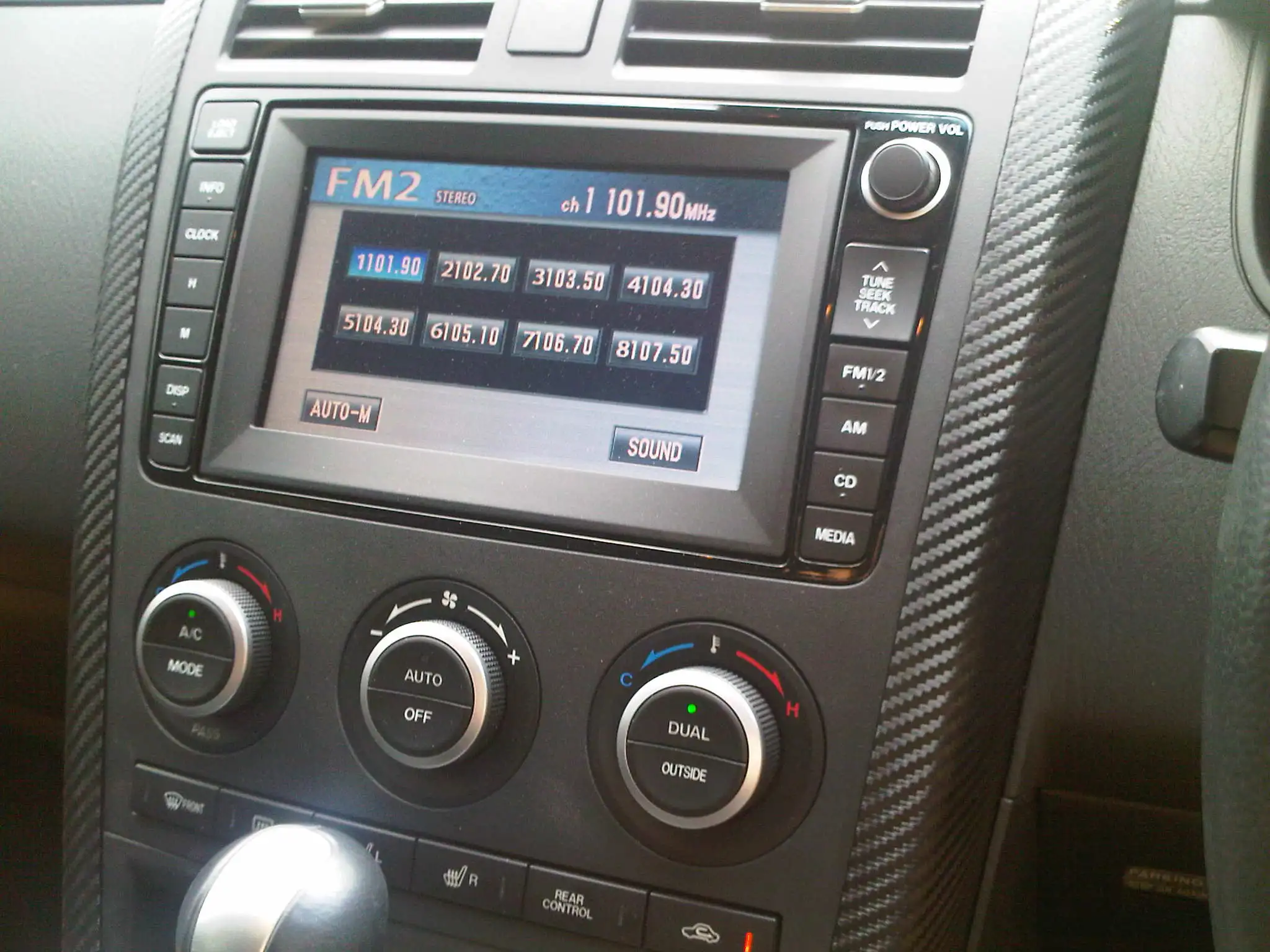

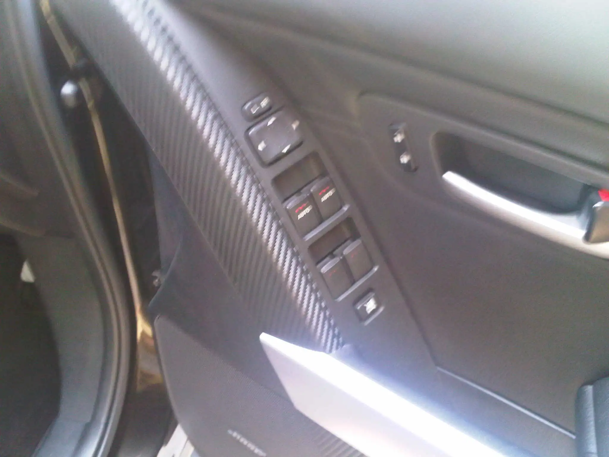

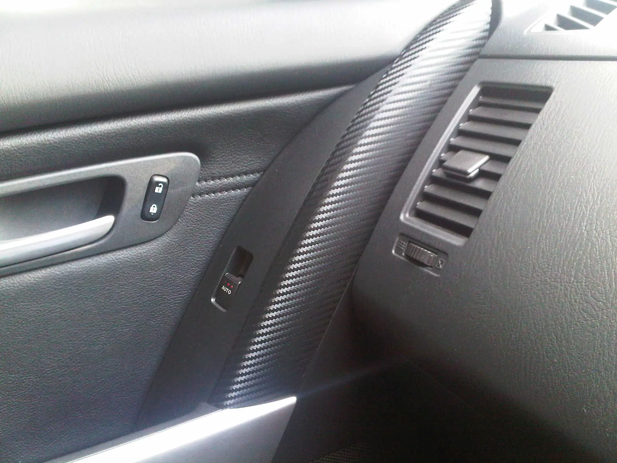

OK, thanks for all your help. Yes the door panel does have to be removed and the trim is attached by screws from the back. So here's what i've been doing, it won't be to everyones taste but the piano black was always dusty or smeared by fingerprints so i brought some "carbon fibre" vinyl from ebay and covered the bits of trim in question. I quite like the "technical" look and unless you know what you're looking for you can see it's different but not exactly how.

I've seen that carbon fibre look done on some other cars and I was not impressed, they went a little crazy with the stuff, however this one seems to look better than I expected - not 'over' done.
