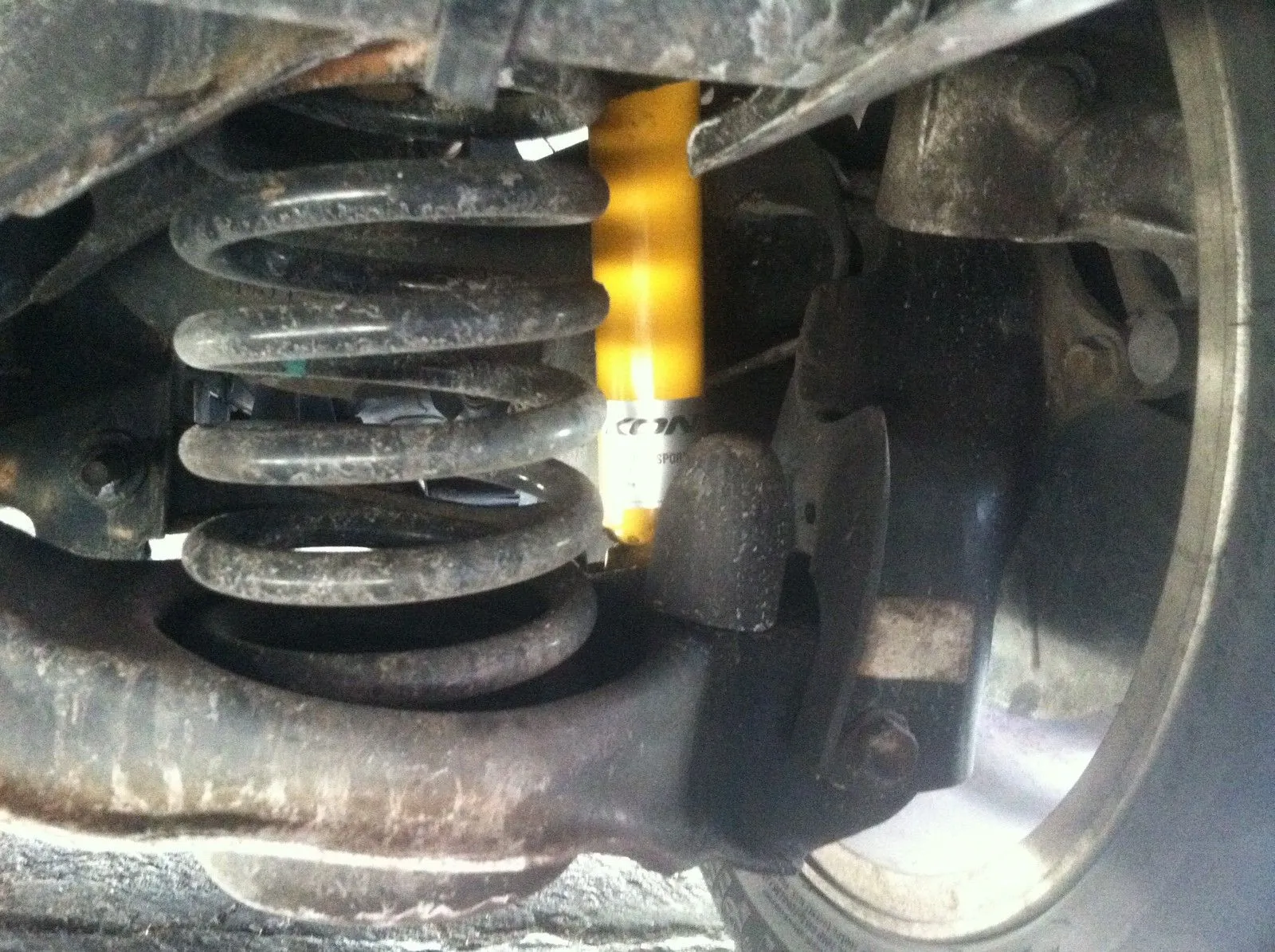

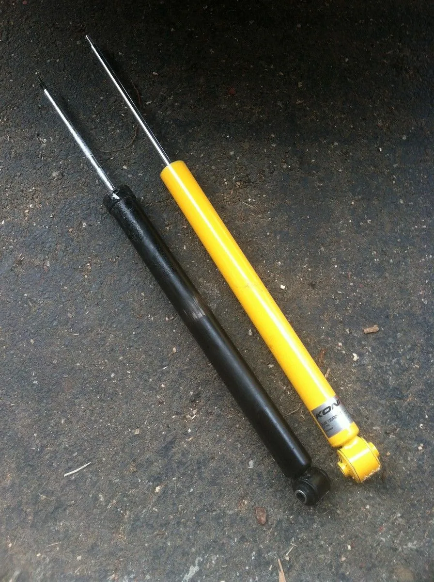

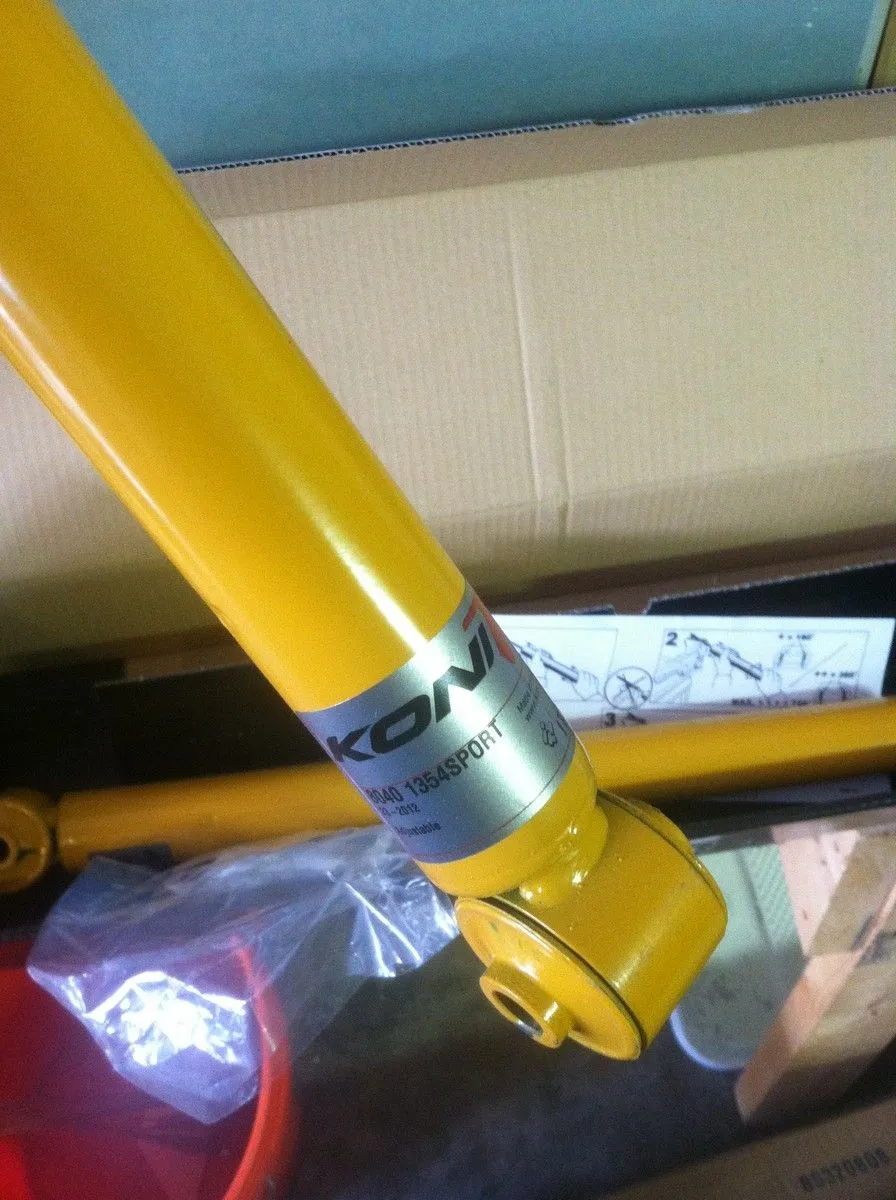

Don't waste your time with any of the "cheaper" options, these are the dampers you want. Even with stock springs and set to the softest setting, these control the car SOOO much better then the stock dampers ever did. (including brand new OEM's) I think a full set of Koni's and a set of Racing Beat sway bars will make this car a very capable daily driver.

njaremka! You're the man!
Thanks for fallowing up about your install. It's now proven for me that mz3 koni yellow can be use on a mz5! Thank you very much
Hey njaremka, is just me or the koni seems longer than the stock shock?
Does that effect anything?
its a little bit of an illusion. the actual shock body is the same length, the mounting eye at the base is a little bigger on the koni, and the piston rod is slightly longer on the koni. i doubt it will affect anything since the koni's are rated for a slight lowering from stock height.

Yes, the mazda5 specific koni yellow sport.
