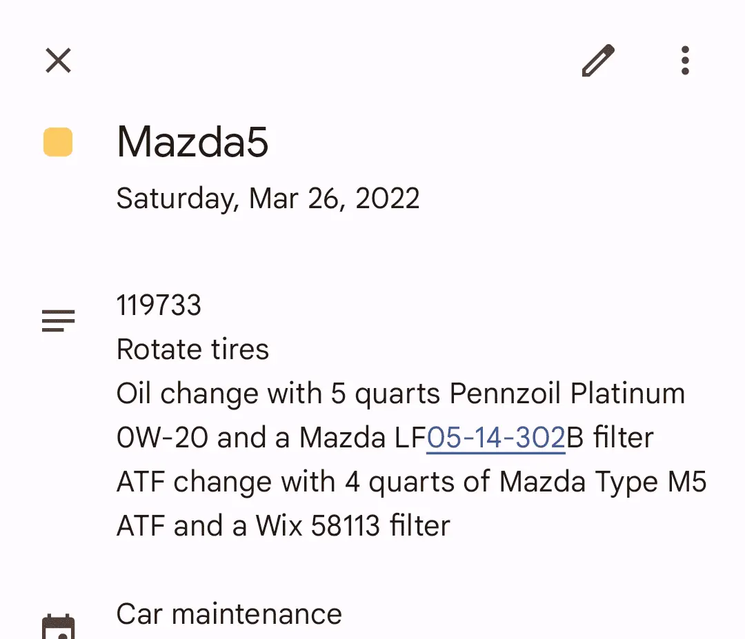

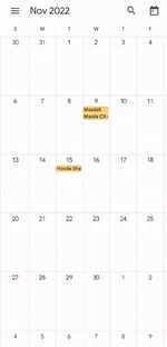

To track literally everything I do for my vehicles, I set up a separate Google Calendar I named Car Maintenance.
Then, on the date I did maintenance, I make an entry with the name of the vehicle, then in the description, I write in mileage, what I did, and part numbers.

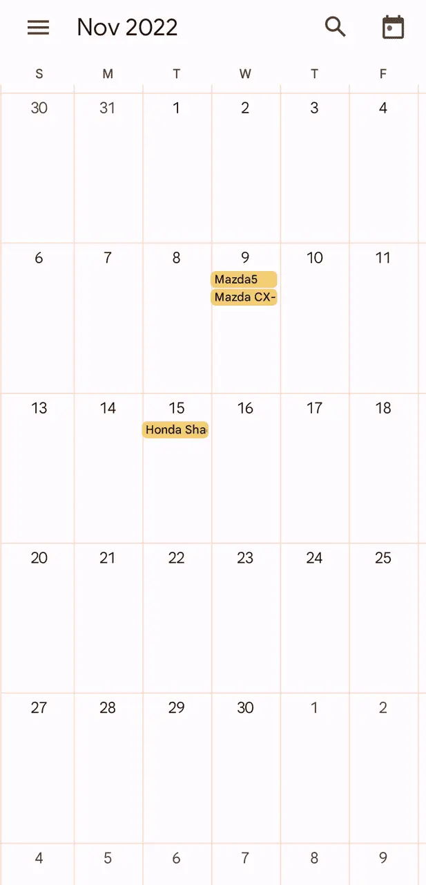

I typically track vehicle service intervals with Google Sheets. Some factors that I have are date, mileage and service performed on that date as well as cost. The built in service maintenance feature on the CX-5 is a nice touch and acts as a reminder for when the next tire rotation and oil change is since it's hard to ignore that orange wrench on the speedometer lol
