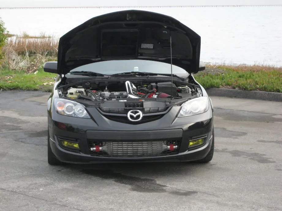

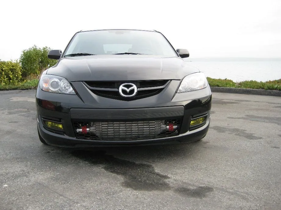

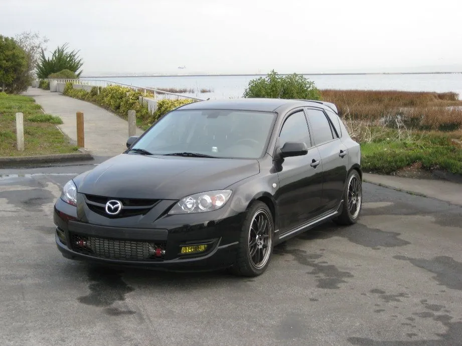

if it fits without harming anything, keep the ducting on.
the black clips are a PAIN IN THE (butt)
ok....everything fit without cutting or removing anything....took the shop longer to do the turbo inlet than the fmic....fmic was pretty easy...
nice. yeah, keep the ducting on. just be careful, the piping can get CRAZY hott and if its touching the ducting, it may warp or melt it.
other then that, love your setup. that ATP Turbo Inlet is awesome !!! (drinks)
