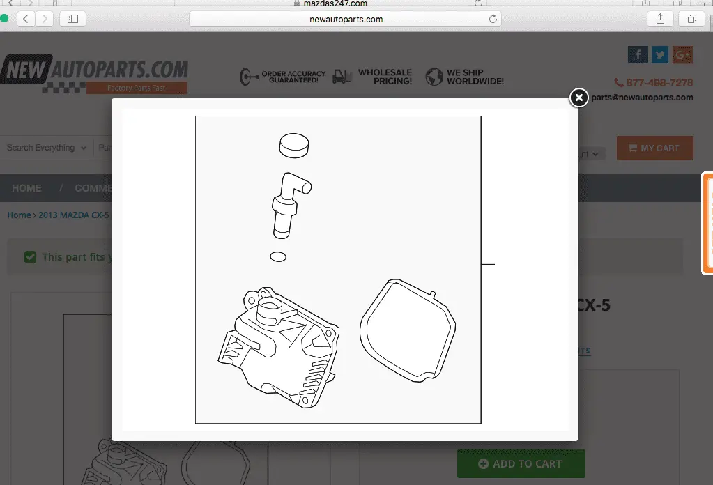

I am just wondering about the PCV system. Will serving this system help to keep these valves clean? On my old car it was right on top of the valve cover. This one is hidden. From what I've read its under the intake manifold. Can I get to it by removing the cover under the engine bay, and go from underneath? Or do I have to remove the intake? As far as intakes go, it looks pretty easy to remove, but would rather not if I dont have to.
I am not sure but it looks like its kind of already has a catch can built into the system. But if anyone can elaborate on that please do? So I am coming up on 50,000 miles. So my next maintenance will include new mazda plugs, drain and fill of the manual transmission. Should I look into the PCV system. The replacement cost of these parts are very reasonable.

TimberSTX you have it figured out. The PCV does rest inside an oil catch separator built into the engine. Oil is allowed to drain back down through to the engine sump, and the only thing that vents to the intake are fumes. That said, running a low NOACK volatility oil like Mobil 1 will reduce off-gassing and further carbon build up on your valves in theory. I got upset with Pennzoil when they increased their NOACK from 8 to 12.9 on their newer synthetics.
