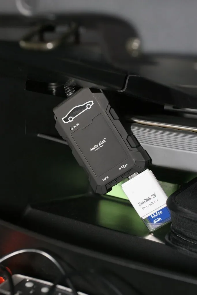

I bought an xcarlink to play MP3's from a USB stick. You have to create 6 folders CD01..CD06 on the USB stick which is then recognized as a 6CD changer and can be controlled from the headunit.

Can you go into greater detail, post a link to the product and maybe a picture or two of what you've got, I'm thinking of getting that 100 dollar thingy that lets you plug a thumb drive / SD card in.

This is the unit I installed in my 2005 Mazda5. It sits in my glove compartment. Normally, I put it on top of the grey plastic folder that contains the owners-manual. I took it out for the photo.
Installation is easy, although you have to remove the headunit. Simply put the connector in the headunit and off you go...
When I bought it, it was called an "Audio Link", but is has been renamed to xcarlink. http://www.xcarlink.com
Besides the USB port it also functions as an AUX-in. When a device is plugged into the AUX-in, the USB device is temporarily stopped.
Currently, there are more versions including bluetooth A2DP and IPod support

another option might be from gromaudio.com. I have the grom unit for the Mazda 3 non bose which is plug and play, you do have to remove the HU to make the connections, and run the ipod cable. The unit I have will charge the ipod, still have use of the steering wheel controls, the HU display does not song tracks, etc., but simple/easy to install & use IMO.
