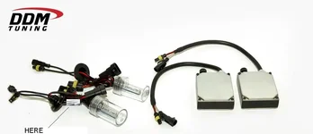

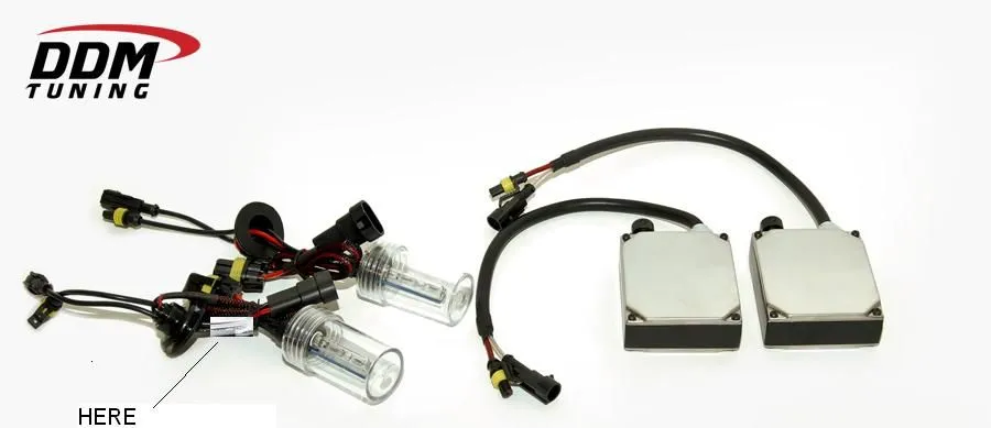

I installed the low beam HIDs today, but didn't have the right tools to install the fog lights. I don't see a way other than drilling a bigger hole out of the back of the metal fog light housing as previously mentioned. I had to do some slight modifications for the low beam HIDs, but the fogs appear to be a pain in the ass. Any other insight would be much appreciated.
to Shub
I cut my wiring here and reconnected it in the fog light housing, kept the dust cover outside of the fog light housing, kept the stock wiring outside of the fog light housing too.
Thanks, this makes sense.
