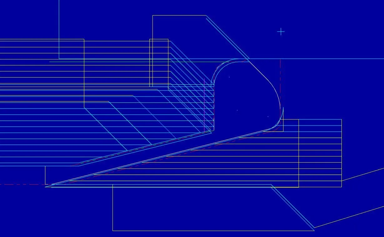

i am officially teaching myself mastercam, and hopefully im doing it right-ish. i can always go and check dimensioning for the toolholders and other specifics later, but right now im focusing on trying to get the toolpaths OK... im not positive how im doing, but if i get a chance tomorrow im heading to the lab and will get some feedback on how its looking. theres still two parts to finish on the profile, but thats not too bad.

i couldnt open the video, what is it???????
its a WMV, which means you cant open it on mac or linux. im gonna try to change that at some point
lol i think its the ring? i couldnt tell what i was lookin at ha
yeah... the sketch in the beginning is the profile of the ring with all the cutting paths. then it goes 3-D and shows the tools cutting away at it. which is pretty neat.

i tried to run a big ring on tuesday, there was one god damn line in mastercam that was screwed up and it busted my BFN tool. got another one on order, ill hopefully take a stab again on tuesday.

the depth of cut was set too large - mastercam didnt do what i wanted it to so i had to do a manual entry and miscalculated the depth of the cut i was taking. it was a legit toolpath, it was just defined wrong. so instead of skimming .01 off it tried to do ~.06-.08 and ka-boom.
no one to blame but myself... which oddly makes me feel better about it.
