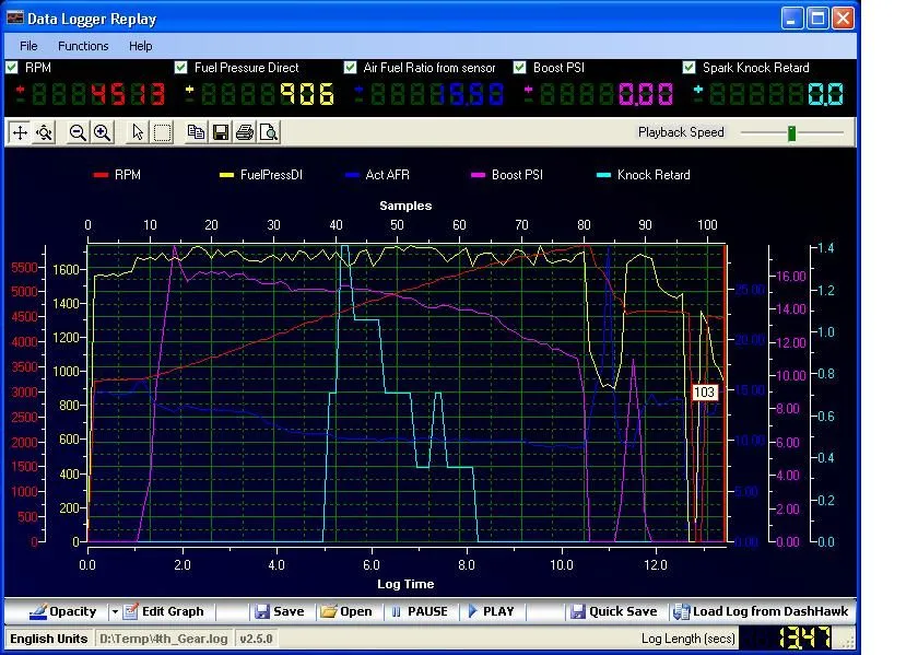

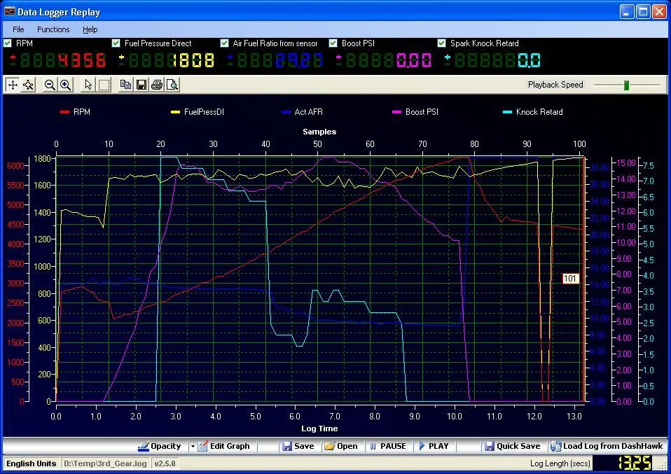

Finally got some logs today, and they show what I feel (and see in the alert) that I have nasty amounts of KR in 3rd. Thoughts on why? Mod's listed in my sig, 93 octane gas.
Screen caps and actual logs from 3rd & 4th (separate pulls) attached.
Thanks!

The second pic 1.4 kr is nothing, but the first one OH CRAP! 7.5 knock retard puls you got that dangerous super lean spot beteween 3-4k thats where everbodies engine is blowing and thats wher your knock is, you bettrer get an cp-e standback asap and add a bunch of fuel in that area befroe she blows... Or add fuel some other way if you know of another way to...
It could be related to you loading the car up at 2500 rpm's. You can see how lean you are when you get the worst knock retard I have ever seen at WOT. Did you hear pinging. I don't suggest doing WOT runs with KR like that. I would say put the stock tmic on and see what happens.
I'm not seeing the lean condition, help me understand that. I did mean start the pull at 3000-3500, I agree that I hit WOT at too low of an RPM.
Couldn't hear it, but damned sure felt it... it just stopped pulling.

You are very lean down low.
I would not suggest you going into boost with that much knock happening.
It wasn't until your a/f hit 11's before the knock began to subside.
I would def suggest getting ems to richen up that mixture.
Based on the datalog it does not seem that you need the upgraded cdfp.
You should def re-check all clamps and such and make sure you do not have any leaks.
I would even go as far as to suggest you getting the TMIC pressure tested.

Your a/f ratio is between 13 and 14 when the ecu is pulling all that timing to richen it up. You should be around 12.0 if you were tuned. I agree one step colder plugs should be added asap and you should check for leaks, possible the turbo inlet is loose. What are your long term and short term fuel trims? A would also help the situation and don't load your car up below 3k.

STFT is roughly -5 to +5, probably around -1.6 just normal cruising. LTFT is about -4.7 cruising and -12.5 at idle. I will admit ignorance and say that I really don't understand what is. If there's a "turbos for dummies" post/thread/site, please point me too it!!
I really didn't mean to start so low and I will probably make a new 3rd gear pull from a more suitable RPM, maybe we're just looking at a problem with the fuel pedal actuator. I didn't go full WOT but I did get into it today on the way home in 3rd at a higher RPM and didn't get the KR alert (set at 3).

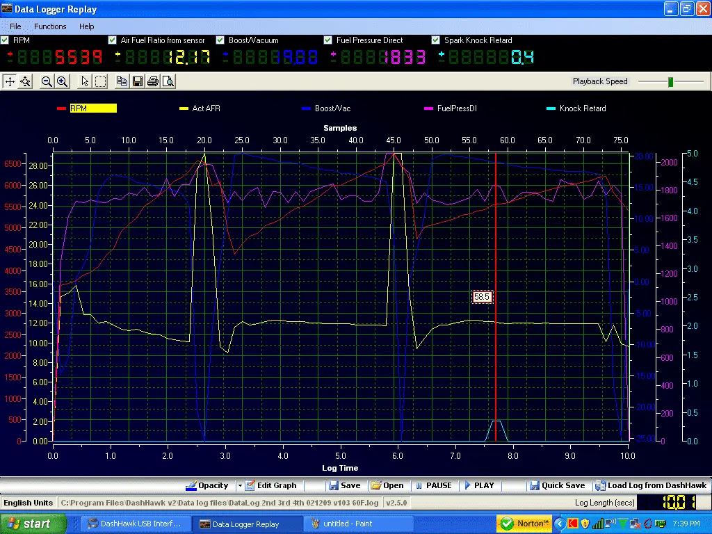

Stage2 v103 FMIC log attached....very little kr.
