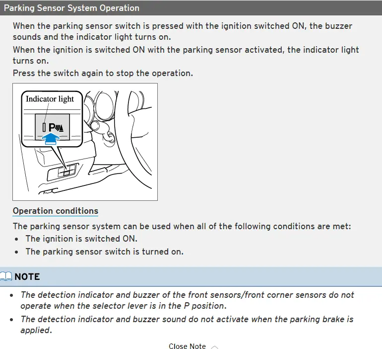

It isn't something as simple as you turned off the sound? There is button to shut off those in my car in lower left dash

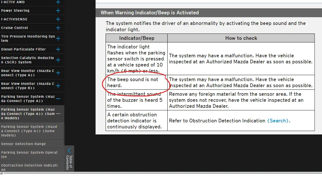

Good luck. Maybe you have to take it in....this from US spec manual.

First I have not read any previous posts on this subject. Do you know when the Parktronic beeper should be sounding? If so, when it is going off, have you tried using the small volume dial or volume switch on the steering wheel to turn up the Sound level? Just a thought.

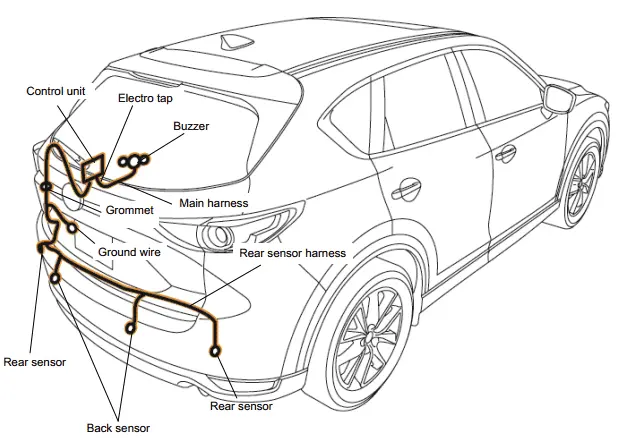

The instructions for the Mazda aftermarket parking sensor accessory kit (KB7WV7290A) shows this as where to install. I would ass-u-me this is the same as factory (?)

Was in the workshop today and the beeper has been replaced, it sits behind the back seats where RedBaron also shows. In addition, I was told that any change in software or electrical installations would result in warranty lapses, even if one had an original card for the nav.
