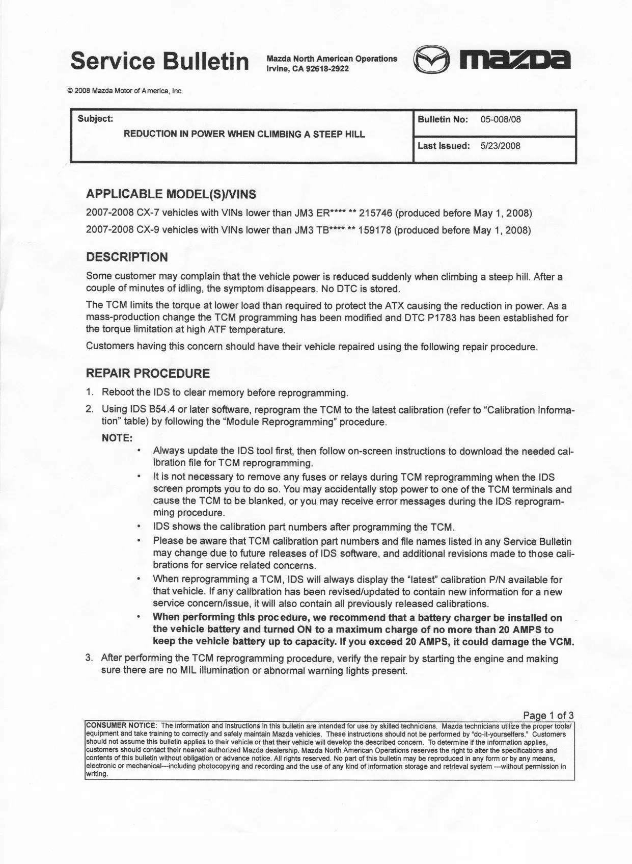

throttle shutdown issue can be resolved
Hi all,
CX9 and CX7vehicle manufactured before MAY 1 2008 have these throttle problem this can be fixed, by the dealer..
please refer the attached PDF or JPG
Goodluck
Karthik
please chk the attached JPG

issue can be solved please chk the attached jpg

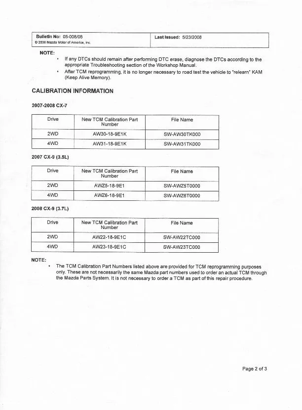

Thanks to kartikcx9 for the TSB.
I will make sure my dealer update my TCM at the next oil change.
The dealer won't require the 3rd page. I told them the TSB#, provided a copy of the first two pages attached here and no problems.
They did ask me to explain what happened before they would apply the firmware fix. So I told them that the engine quit while driving up Mt. Washington in nearby New Hampshire. I almost got killed when the engine shut down I told them. Firmware was gladly updated (so I was told when I picked it up).(spin)
