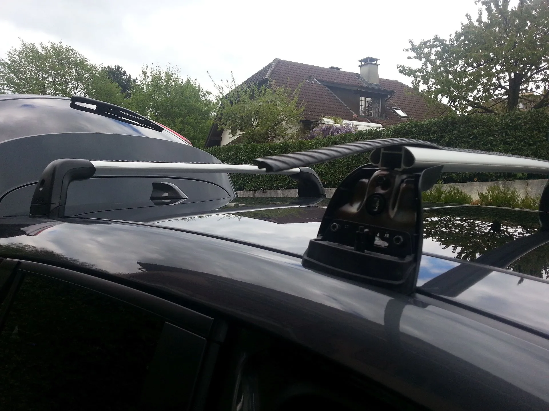

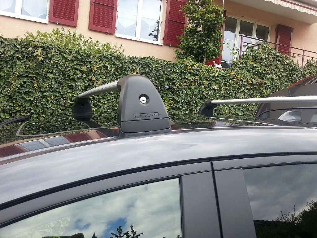

I know that this forum focuses mainly on North America market, but maybe there is someone interested in European model as well.
In European model there are no roof rails and cross bars fix directly to the roof.
I decided by OEM bars, as there were cheaper (little more than 200 USD) than any others and I was sure that they will fit perfectly my CX-5 2013.

I like the European rack better! It's very similar to how the rack worked on my Mazda5. It's a cheaper setup, simplistic and more functional IMO.
My Mazda 5 rack looked almost identical to yours and was made by Thule for Mazda. I dig it.
I like it. How far is the center of the front bar from the rear hatch being open? I wonder if it's longer then the U.S. Market roof rack.
Well, the distance between front and rear bar measured at centre is 89 cm (35 inch), rear bar and open hatch 48 cm (18.89 inch). The height between bars and roof are for front 9 cm (3.54 inch) and for rear 8.5 cm (3.34 inch).

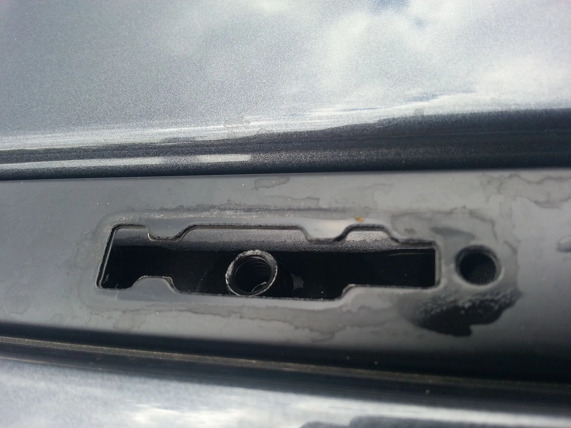

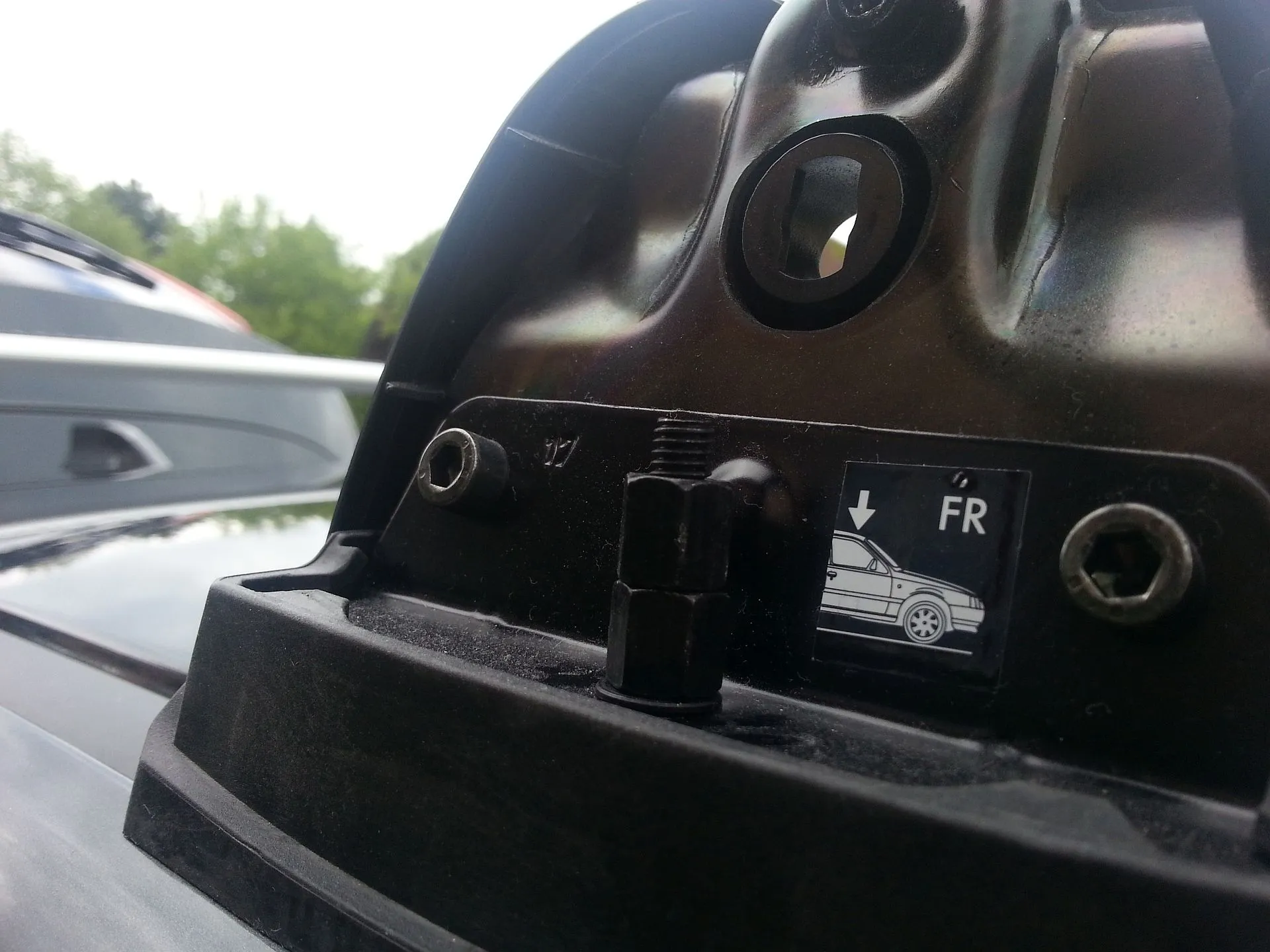

The cross bars came with only one set of screws/mounts. European Mazda CX-5 roof had already a hole (see first picture) with plastic cover (on picture already removed). This hole is placed in the plastic roof side rail.
EU has much higher government standards for roof racks than the US. That's why almost all of them have non adjustable threaded mounting points in the roof. The threaded points are positioned further forward (which is better for actual users) and are a different design than what we have in the US. They are completely incompatible with each other. With few exceptions, every US OEM crossbar is positioned behind the driver so the manufacturers get fewer complaints about wind noise.
