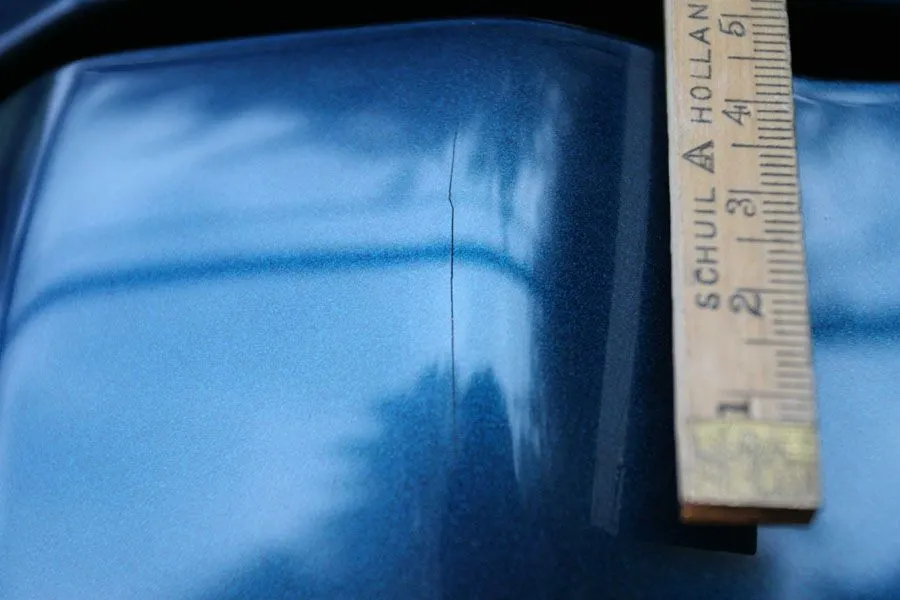

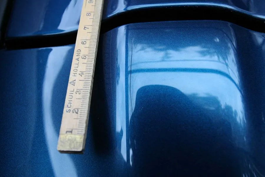

Hi all,
After reading a thread in a Dutch Mazda forum, I discovered two cracks in the tailgate of my Mazda5. The cracks are located near the hinges. I've attached two pictures of the cracks. I included a ruler (in cm.) to give an idea of the size. The crack on the left is about 6cm, the one on the right about 4cm.
This is a Dutch 2005 1.8 Mazda5. I've already spoken with my local Mazda dealership and they say they have seen this problem in more Mazda5's, even an almost new one. They were a bit unsure about whether or not this is covered by guarantee.
Does anyone here have the same problem with the Mazda5?
Cheers! Stefan.

Just returned from the dealer who has taken some pictures to send to Mazda for a service request. They say Mazda does not replace the liftgate anymore as they did with previous cases with the same cracks. Instead of replacing the liftgate, they will glue it. (Which I'm not totally happy about :-( )
The dealer showed me an official service bulletin about this issue. Unfortunately I can't find this bulletin anywhere on the net. Maybe someone over here?
Another thing they told me is that this problem with the tailgate is one of the things that was improved with the recent facelift of the Mazda5. The tailgate is now made of thicker plastic. (And that is the main reason I'm not very positive about glueing the cracks: the liftgate isn't going to be stronger than before the cracks...)
Cheers! Stefan.

I think you really should try to have this fixed under warranty. I really think it's something that shouldn't happen to the tailgate. And it's a fact that there's a TSB about it (saw it at my local dealer, but unfortunately haven't got a copy), so it's a known issue. It's also a fact (at least: my dealer told me so) that the newer Mazda5's have a tailgate made of thicker plastic. Let's guess one time why they did that...
I contacted the Dutch Automobile Association (ANWB) about this issue, and they support my thinking that if my Mazda5 gets new cracks after the warranty has expired, Mazda should fix it again under warranty. (but I hope I won't have to experience that...)
Cheers! Stefan.
