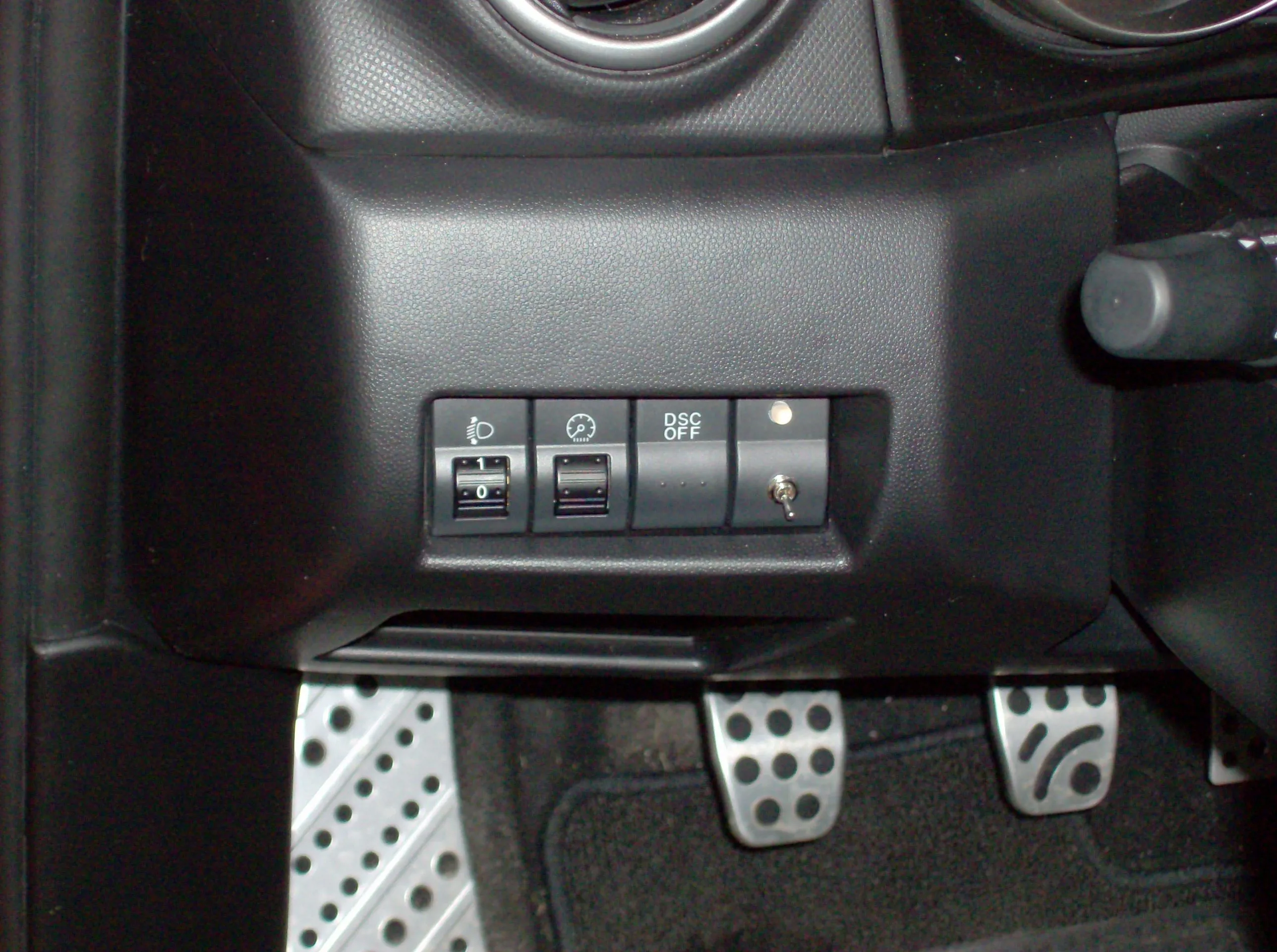

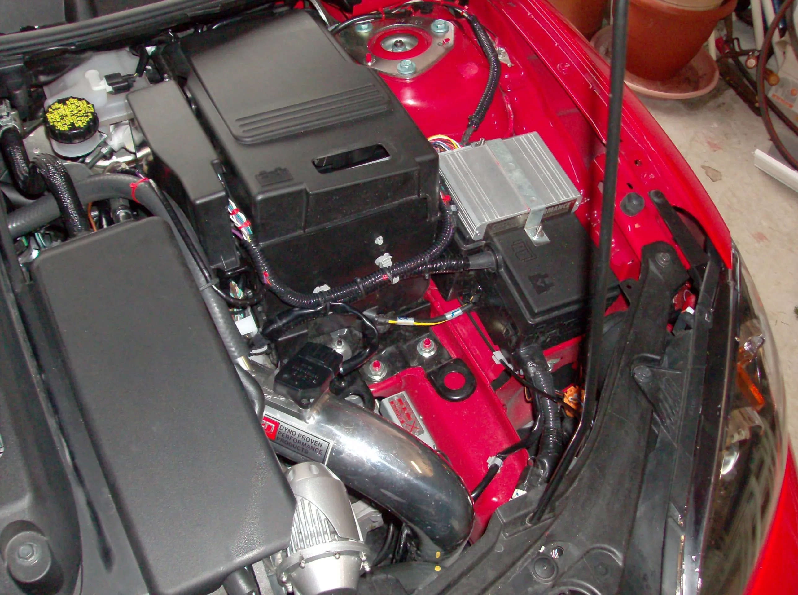

ok. well after a grueling time fighting with my engine bay and making things clear everything is finally hooked up and running great. the standback system is really a great product and now that everything was cleared out (one part was sent wrong and will be sent back to me.) the electronics engineer i talked to there helped me out and helped me figure out what it was. other than that yes i didnt like the instructions completely but it was little things you probably wouldn't really notice unless things werent working right and u scanned every little detail as i did. other than that though this product really is amazing and i havnt even hooked it up to a computer yet. with a little bit of thought and home fabricating you can also mount this stuff into some really easily and protected areas. i mounted the switch and LED light into my dash on the blank button next to the traction control button. as for the processor i was able to make a z bracket and mount it onto my fuse box and it doesnt interfere with anything. i did drill a new hole through my firewall but it was because i was running things for gauges and other things and found a free spot that was safe right through the drivers side. all in all it all looks great and works even better. thanks cp-e.

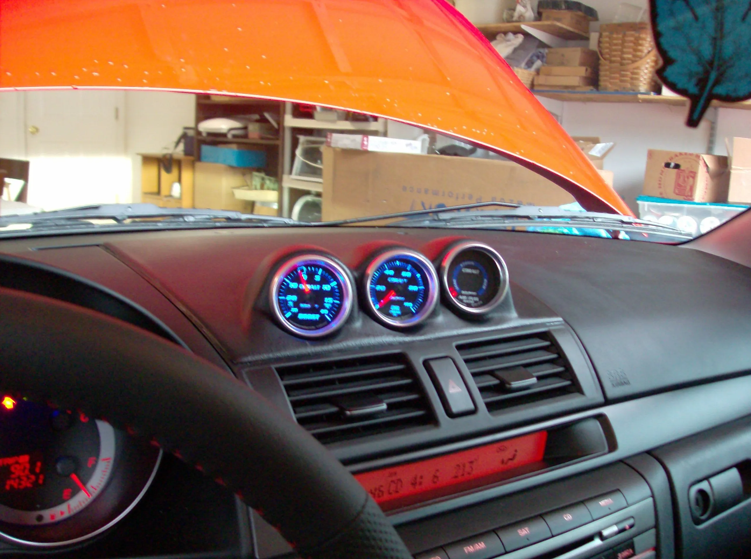

thanks, i did have to extend the wires for the switch and make the bracket but i like how it all came out. i would like to eventually find a casing that will fit over the standback so that it looks a little cleaner and make it more protected. for now i might just paint the bracket and screws. the center pod isnt exactly what i wanted but i liked the style. hopefully someone will just make a whole unit so people dont have to cut into anything and glue or screw it on which makes it look a little sloppy.

as for the gau1ge pod it does sorta suck, i like how the mold comes down with the gauges but they should made one with the vents on it so you dont have to cut. as for the cutting u can do it however you want but i cut out a rectangle and then used a dremmel to make notches for the part of the mold that holds the gauges as it goes down more. i used the silicone adhesive it came with but i think i should have picked up a better glue for it. it glued fine but the silicone they used was hard to mold with a finger swipe so it doesnt come out smooth around the edges. i might go with the dvd player dash that they sell for our car and just mount a gagues holder onto it as its a lot cleaner looking but it doesnt mold around the gauges which i liked about this one. theres plenty of stock covers on ebay in case one should want to mount the gauges elsewhere after installing one of these.
