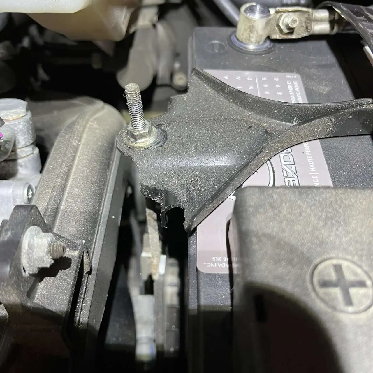

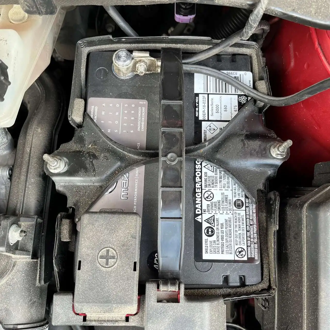

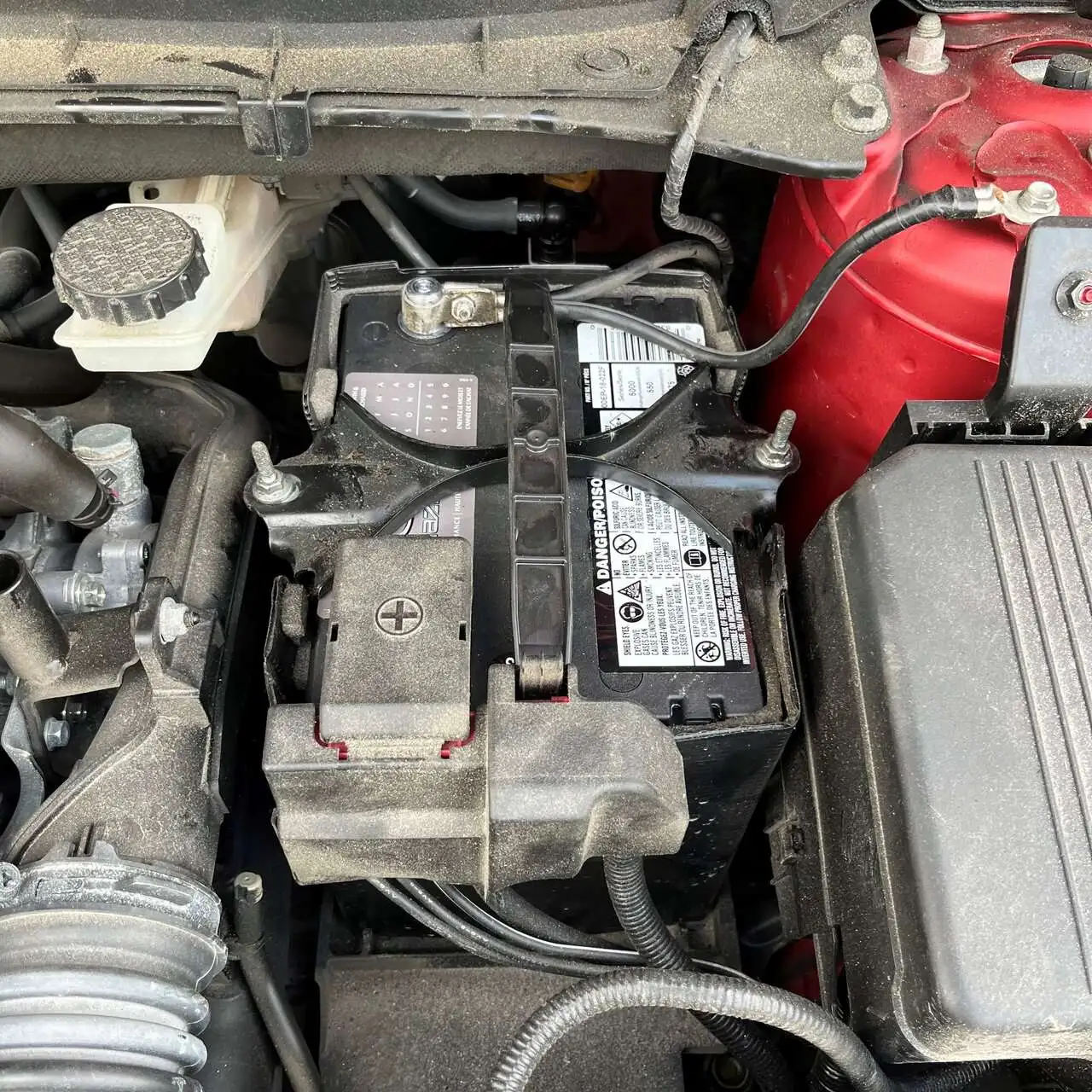

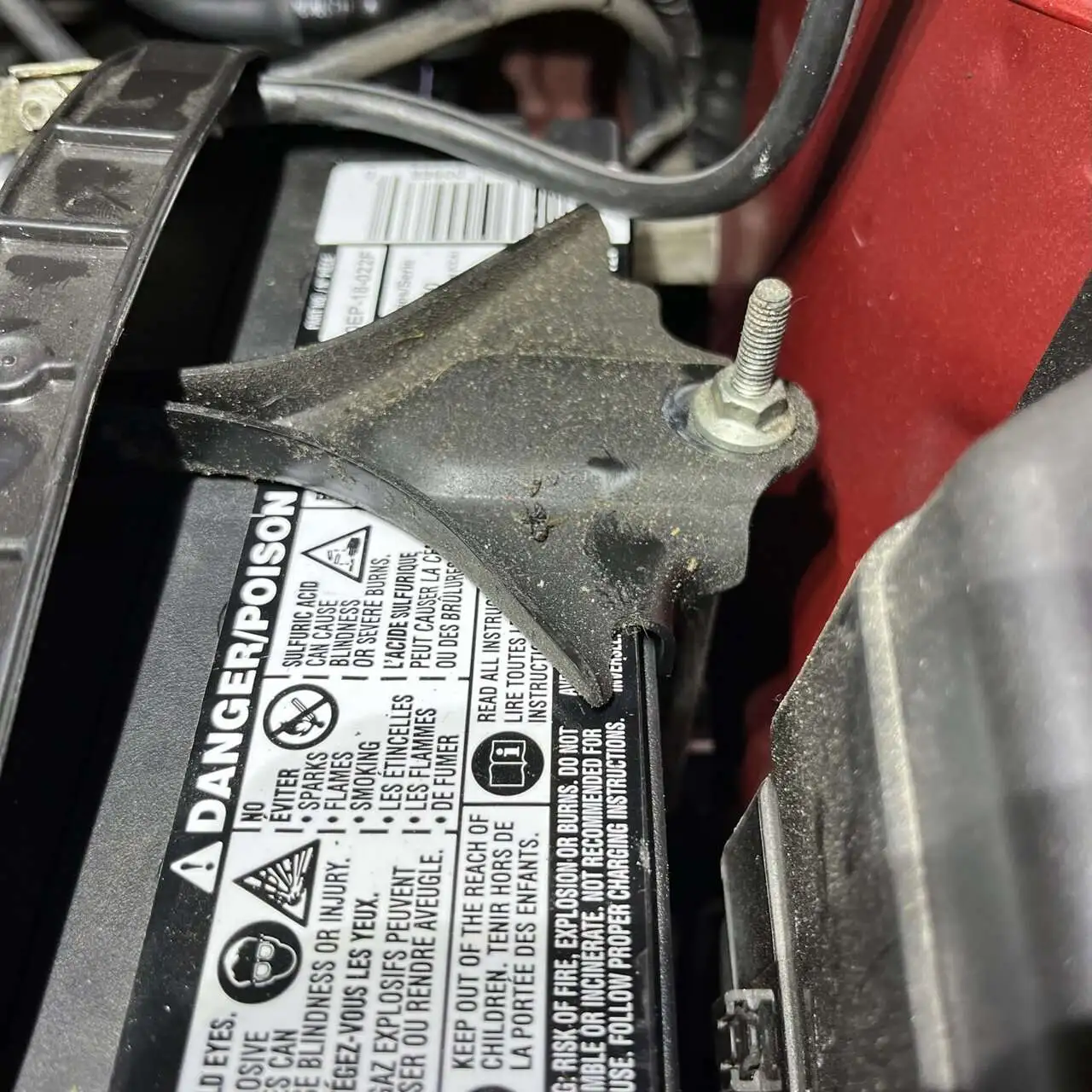

My old battery died after 2.5 years, car wouldn't start anymore. Mazda dealership replaced it under warranty.
00EP-18-022F - is this the correct battery for a 2021 CX-5 Turbo? It seems small in the battery box, I'm not sure if it's smaller than the old one, but it's smaller than the battery clamp.

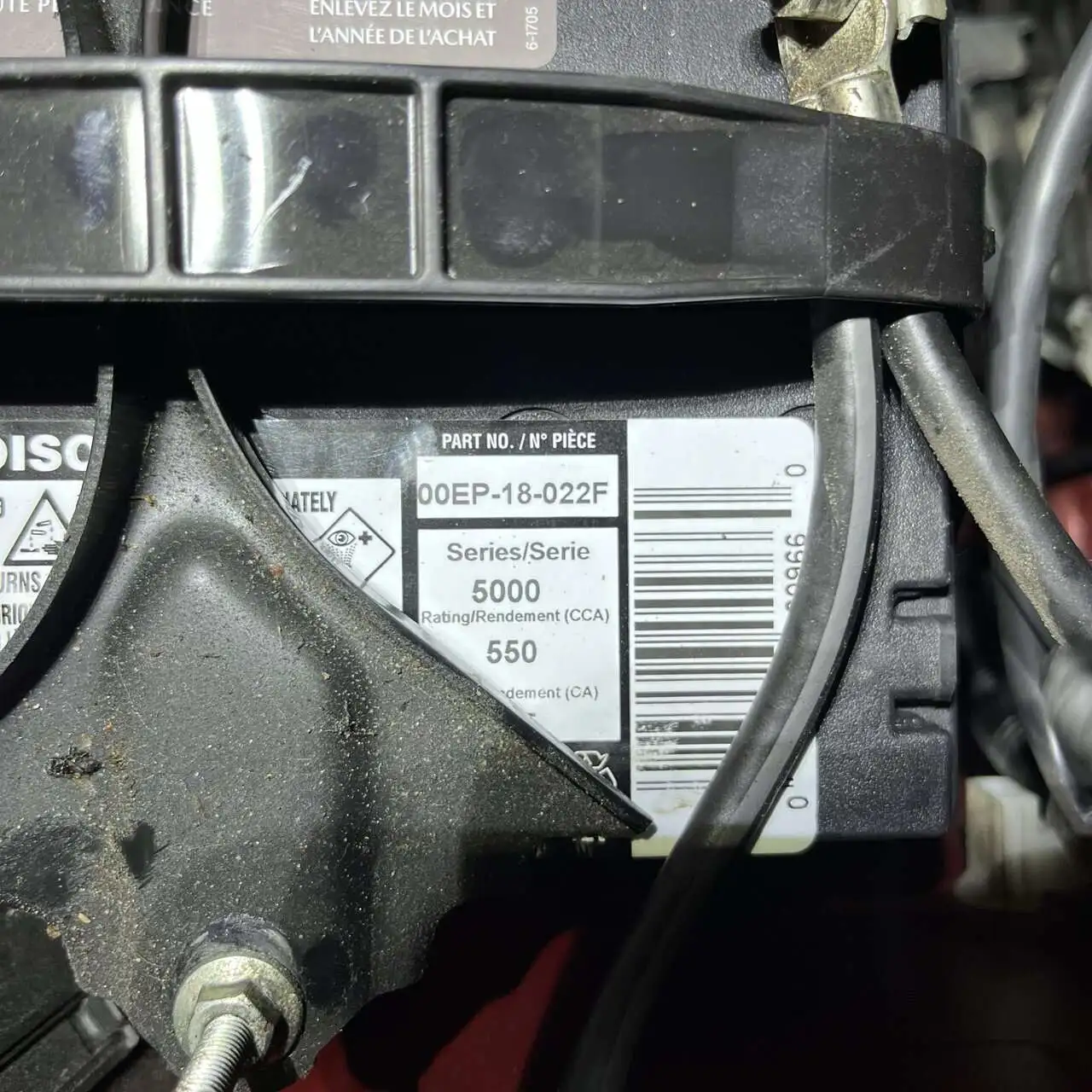

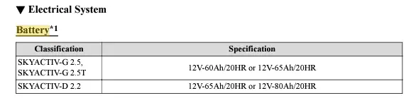

According to the OM, same battery spec for NA and Turbo. Diff for diesel engine (needing more current/amperage).
What is the CCA (cold cranking amperage) and group size of your new battery?
Is that same as your old one?
I see OE battery is used by could be a wrong size. Guessing here.
Unfortunately I did not take a picture of the original battery...
550 CCA, not sure of the group size, I guess 35?
OP,

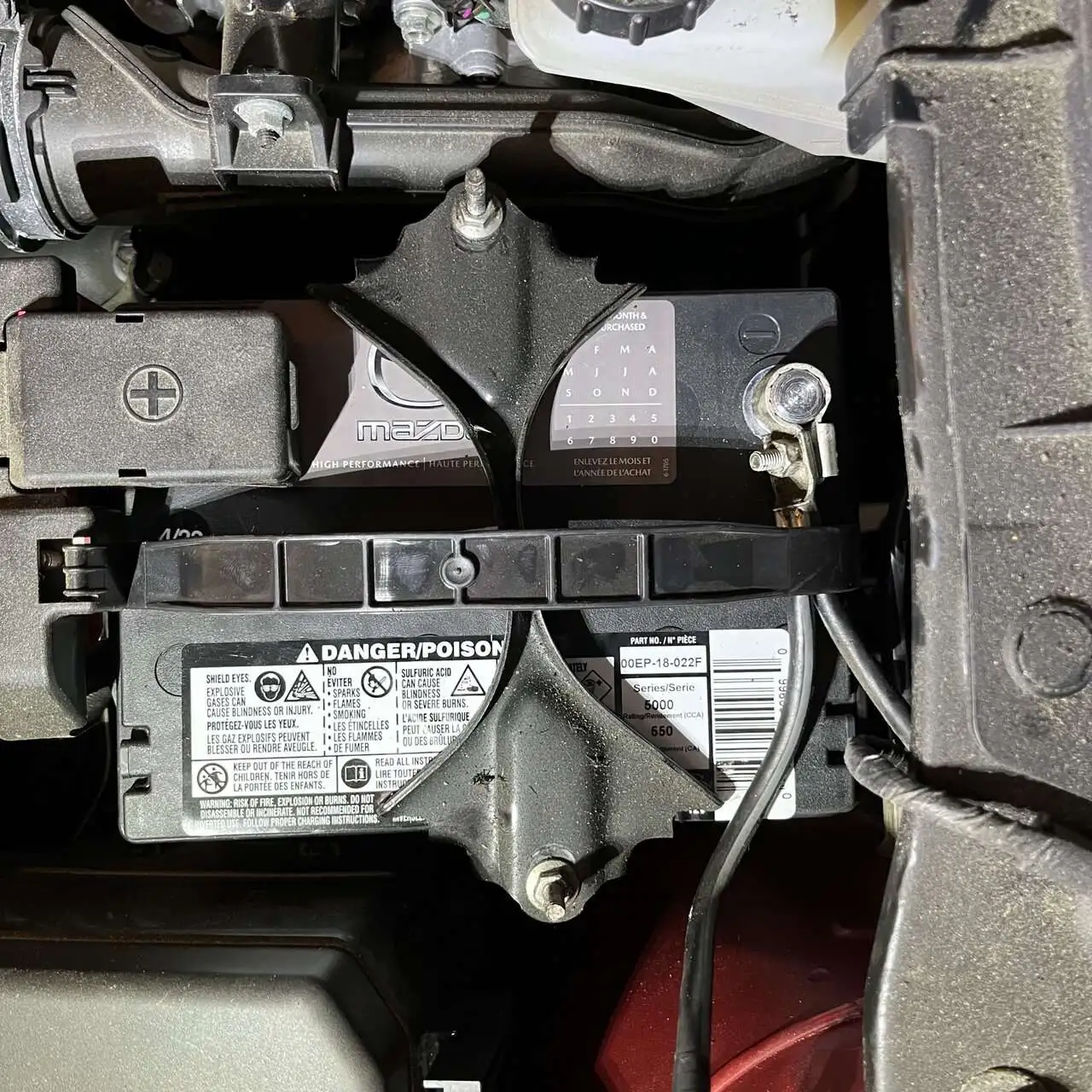

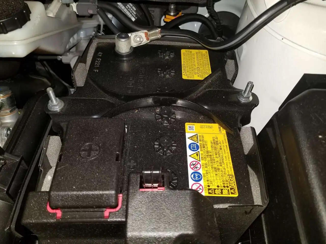

I compared yours to mine ('22 Turbo), there is a paper box that contains the battery with foams between the box and battery. These things (box and foams) seem to be missing from yours.
That is why there appears to be gaps between the battery and clamp.

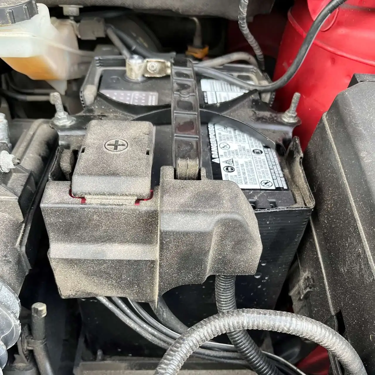

My 2019 Turbo has the surrounding box with foam as well.
Looks like a plain old Group 35.
Physically measure the battery and then compare it to a Group 35's standard measurement, see if it's the same.
In my wife's MZ5, it also calls for a Group 35, but there's enough room that I put a Group 24 in it. That got me a small boost in CCA, RC, and AH for the same price.
35's and 24's are the same width and height, but the 24 is like 1½" longer or something like that.
thats the mazda oem battery in US (the original ome that comes with car from factory is not sold in US) but they forgot or were too lazy to install back the plastic cover around the battery. I would go back and ask for it.
It does help with the heat to some situations.
Head back to the dealership to get your battery cover back/replaced. It's about $40 CDN to replace (if buying brand new from the dealer). Part number should be PE01-18-59XA.
It's common for people to take the old battery out and forget to move the battery cover onto the new battery either before or after installing it. That cover helps to isolate the battery from the heat and the cold, so I would definitely have the dealer replace it on their dime (if they lost yours).
The foam insulator on the batter sides is to protect the battery from hot air blowing on the battery. Battery installer either don't understand that or don't care. JMO. Ed
Thank you all for the advice!
It was the plastic / foam insulation that they forgot to replace. I called the dealership and they found it, and installed it back in.
