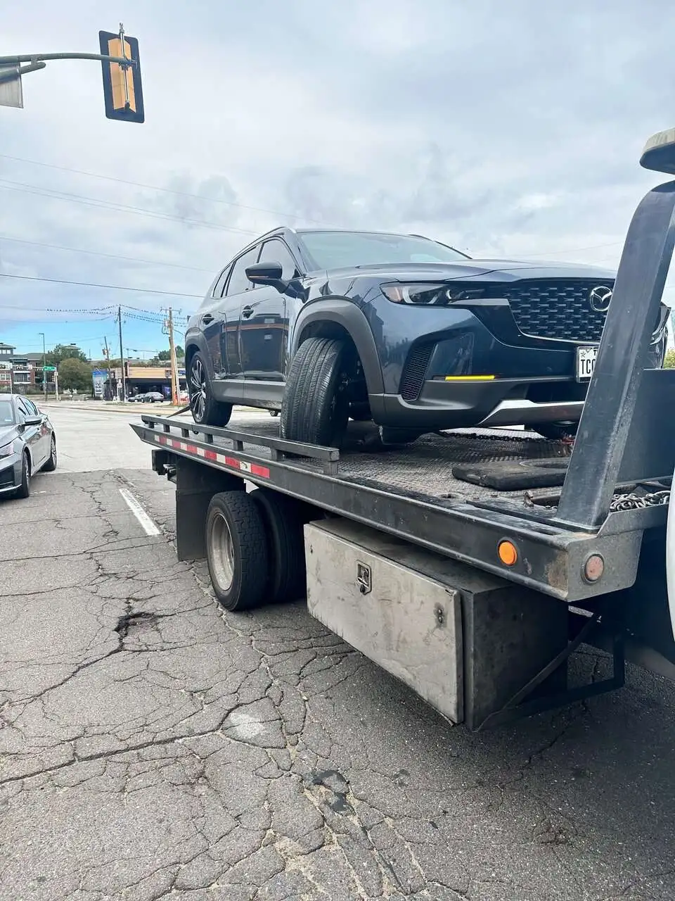

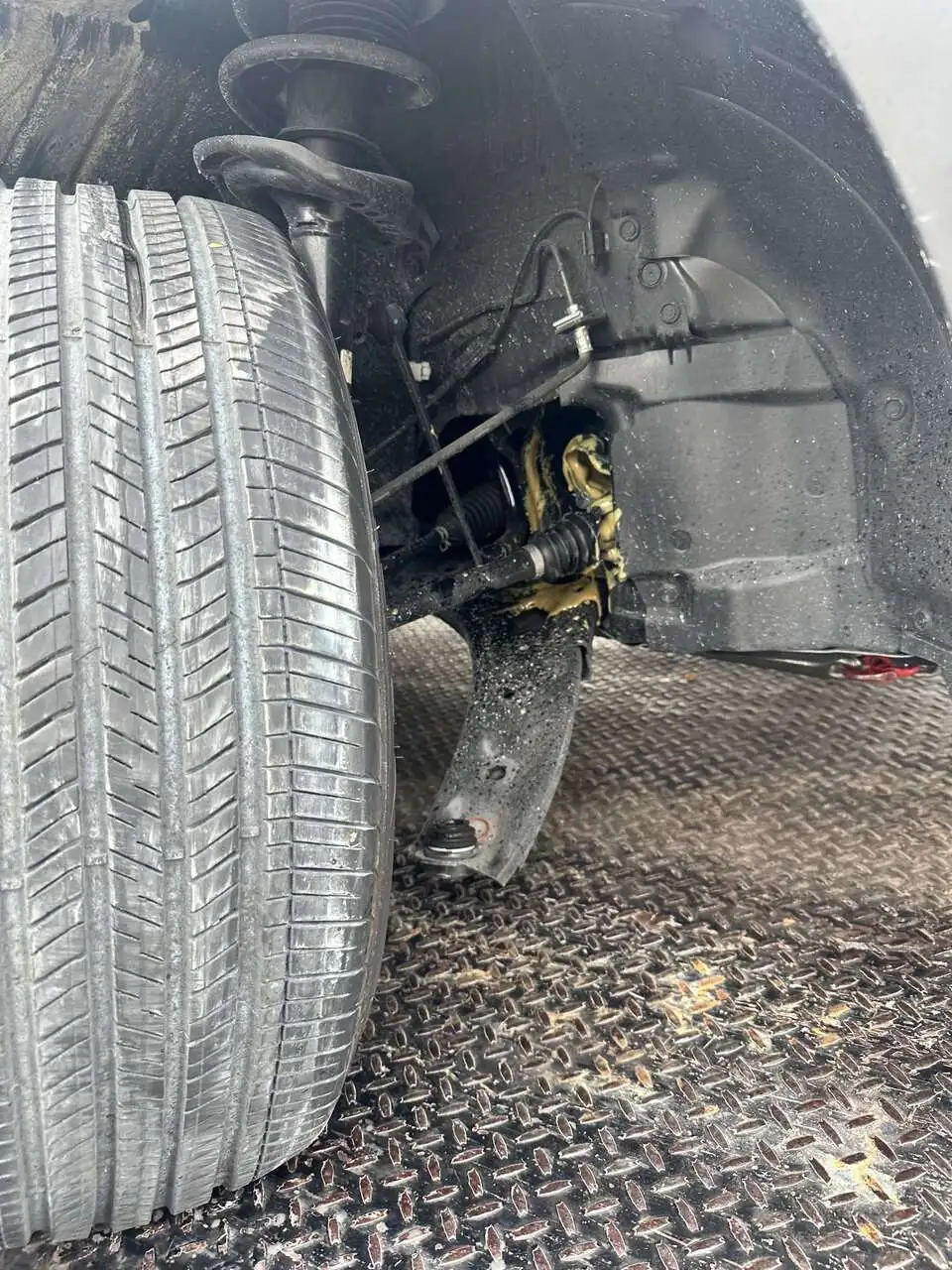

Control Arm Shears off on a 2023 CX-50 with 2k miles
My 24 year old daughter purchased a brand new 2023 CX 50 from a Dallas dealership. With less than 2000 miles, she had just exited Interstate 35 when she skidded to an abrupt stop as her front passenger side wheel came loose from the vehicle and "folded out on itself". She contacted Mazda roadside assistance as obviously the vehicle could not be moved and needed to be towed. The tow truck driver stated that it was a good thing she was no longer on the highway and driving at highway speeds or she would probably have not been around to have been able to call. Also good that there were no other cars next to her at the time or there may have been serious or fatal injuries.
After 5 weeks of back and forth with the Collision Center and Mazda Corporate and getting no closer to having Mazda repair the vehicle, she opens a claim with her insurance. When the insurance adjuster goes to look at the vehicle in person, they deem this was caused by a manufacturing defect and state that Mazda is responsible. Mazda then proceeds to send my daughter an estimate for the repairs and is looking for her to pay. When she again contacts her insurance adjuster regarding this, the advice is to let insurance pay so she can get her vehicle back, insurance will legally go after Mazda to get their payout reimbursed but unfortunately, she will most likely be out of the deductible that she has to pay.
Overall, Mazda's handling of the control arm issue has been a complete disaster. The company has shown no regard for the safety of its customers,
Wow, sorry to see that and glad nobody got hurt. This picture is rare and usually happened on a very old vehicle with broken ball joint on lower control arm!

My point is there’s no way a driver can do something or hit something to cause the catastrophic failure on the ball joint of the lower control arm without any other damages. Based on the pictures and my experience this’s obvious that the failure wasn’t caused by driver error but a defect of the ball joint. You’re a very knowledgeable person with plenty of mechanical experience, please tell me what is the scenario a driver can do to cause such incident? I know I couldn’t even if I try to do it on purpose.
As for what the “Department Manager” said, I said before I simply don’t believe it. The dealership simply doesn’t want to do any thing for her and came up an excuse passing the blame to the “higher up”.
... please tell me what is the scenario a driver can do to cause such incident? ...

I don’t think there’s much else to say. A component failed, the wheel buckled in, and the car slid to a stop. An insurance claim was filed and the insurance company feels they have enough to pursue damages against the manufacturer.
Components aren’t as heavily scruntizned as you may think. If you get a lot of 100 or 1000 components there isn’t time to look at each and every one. You could inspect the first article, subject future lots to sampling inspection per AQL limits, and perform another FAI after a process or supplier changes. This could be the one in a million failure nobody wants to happen (casting defect not visible? Under paint? Microscopic defect?) but flew under the radar. Like you said too, who knows what happened after a vehicle left the factory.
With some Mazdas experiencing cylinder heads cracking and wheels buckling in (not the first report here, but certainly the lowest mileage), no manufacturer is perfect.
