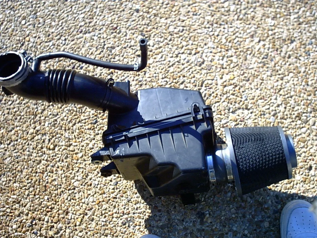

the problem is not running rich, or lean, timing is pulled by the ecu.. the maf detects too much air, not enough fuel, and pulls timing.. wear as it has enough fuel and air, but the maf isnt positioned right to read the amount of air comming in...
K&N doesnt make a full one for protege. try this below.
if u search 1.6L MAF ont he forum, you will see all the trouble we have.
