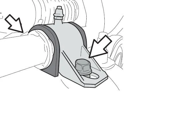

For those who have one, where ae your bushings located. Mine is at the highest setting. I am hearing a noise when i drop the clutch, almost like a kick back.
ok so you have 4 connections or the rear, 2 for the end links and 2 with bushings, the holes are slotted for adjustment on the last 2. I am asking what they are set at, HIGH so the bar is closser t the car, or low so the bar is closer to the ground
the end holes are full stiff and the inside holes are less stiff. for street i would run less stiff, especially in chicago winters
This is the bracket that im talking about.

Just make sure those bolts your picture is pointing at are tight. Mine made awful sounds until I got under there and realized i had loose bolts on one side. I just did a pull up on the swaybar to get it all the way down and tightened everything up :thumb:

Thanks. That is what i was looking for.
