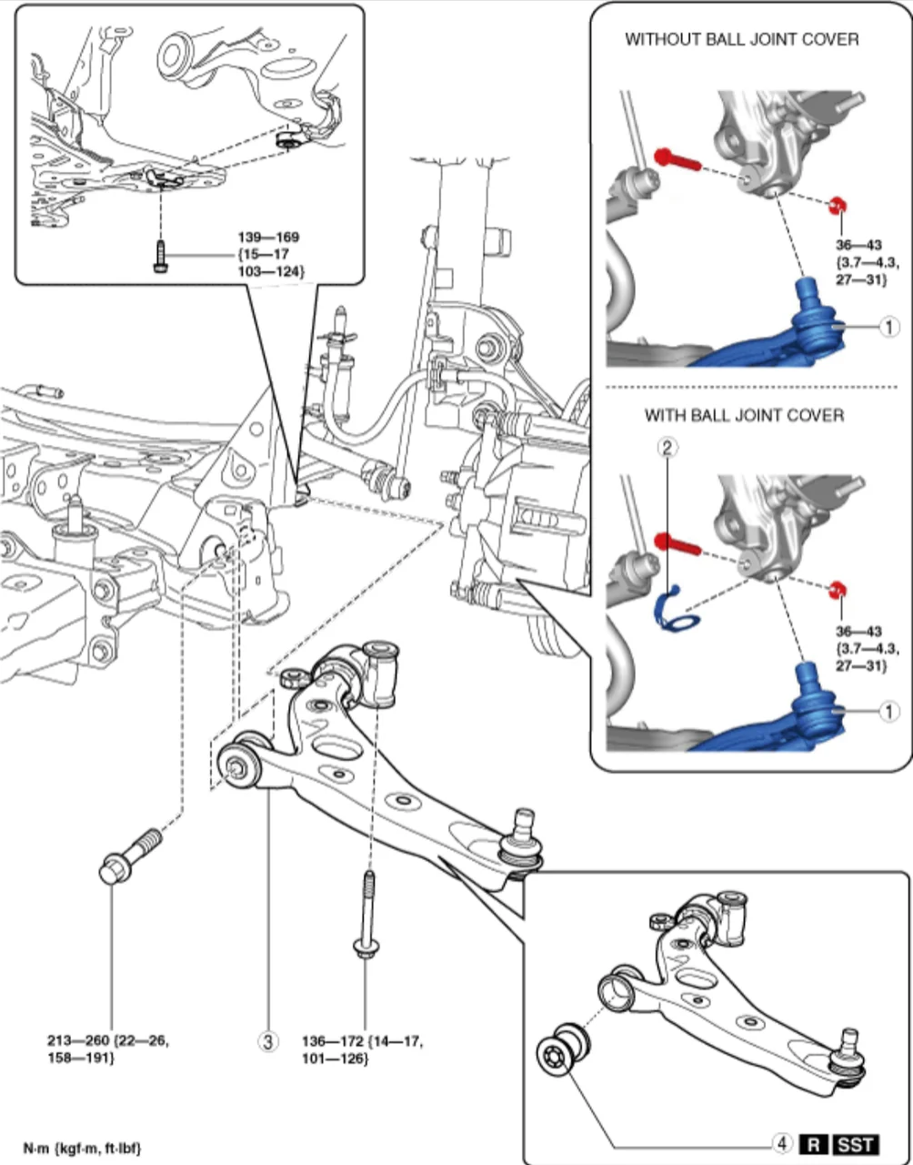

So my question is: I seem to be finding conflicting info on bolt torque specs aside from the bolt and nut securing the ball joint (seems to be around 30 ft lb). Does anyone have any info for the remaining bolts?
Secondly, since I would be touching the suspension, guessing would have to get an alignment done again?
Looks like ...
158 - 191 FT-LBS for the horizontal bolt
103 - 124 FT-LBS for the shorter vertical bolt
101 - 126 FT-LBS for the longer vertical bolt
https://mazdamanuals.com.au/wsm-secure/WSM/D9F2-1A-25A/

Guess it was fine. All the bushings look to be in great shape. No idea what's creaking. I still loosened and re-torqued the 158-191 ft lb horizontal bolts with the wheels at ride height for good measure.
