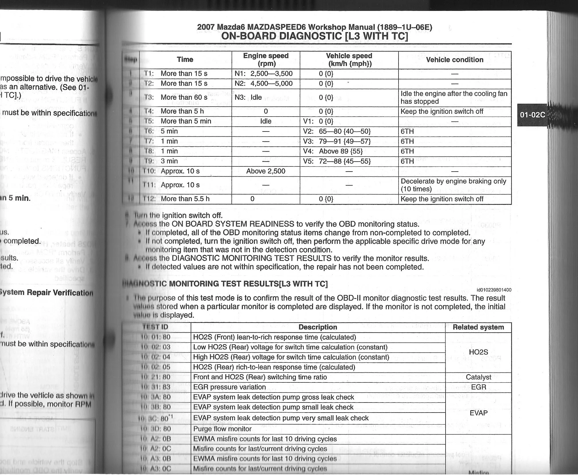

Yes, the regular scan tools will show the monitor status. If you guys are still seeing the 8 flashes of the CEL light, your ECU has not completed the drive cycles to allow normal operation. Something is wrong. The FSM has the drive cycle matrix required to complete all tests and I posted it up on one of these forums, but it was a long while back. I'll try to find it and repost or maybe someone that has it can throw it up.
Here's the Drive Cycle shot from the FSM
