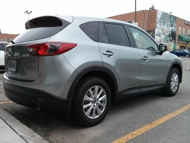

I've only got a picture of them fitted on the CX5.
But I can tell you that you don't need to drill any extra holes,you use all the existing three holes.

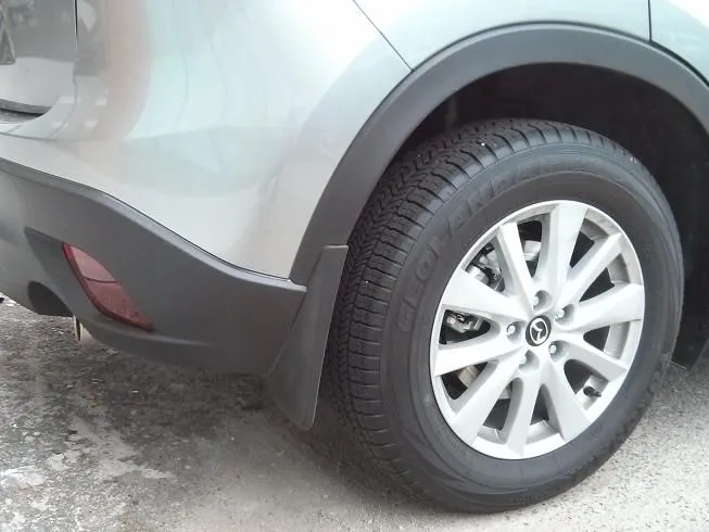

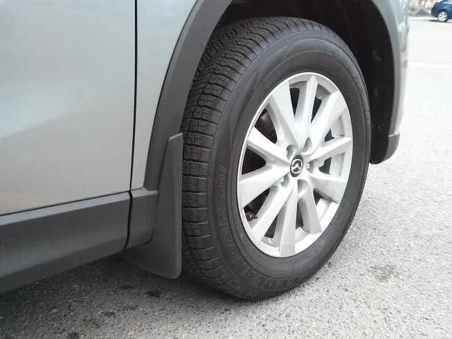

Mudflaps come predrilled. This is a poor photo of a rear. I used 2 existing plastic push rivets that our CX 5's already have. A screw at the top (supplied with flaps) and there is an existing screw used in the underside of each rear.
[/URL][/IMG]
I don't have photos of the fronts, but I used 2 existing plastic push rivets and 1 screw (supplied) at the top of each front flap.

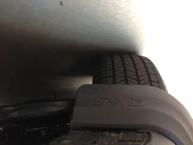

I purchased a set of mud flaps off of ebay that have CX5 embossed in the rear flaps. They are junk. You can't use the factory push pins to secure them. I had to make a couple of trips to an auto parts store trying to find push pins long enough to fit thru the mudflaps and the molding. I found that push pins labeled for GM bumper trim where long enough to go thru both and at least felt secure. I also had to buy a package of number 10 speed nuts and screws. So about another $15 worth of hardware to install them. The rears fit okay but the front have a gap and I tried to adjust them in but there isn't much adjustment. I think I'll leave them on for winter but next summer I'll be getting factory mudflaps. I'll mark this up as a lesson learned.

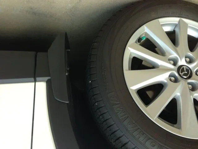

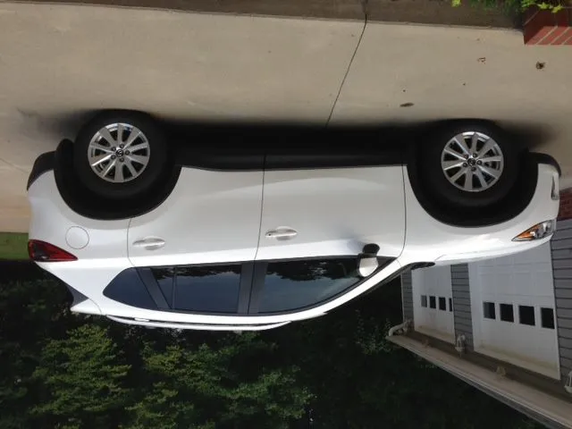

Overall, a very easy install using the 2 plastic clips from (each mudguard) already on the car. No enlarging the holes necessary on my chinese mudguards. I used one screw for each mudguard that came with the package to secure the top. The two rears have an OEM screw that you take out and put back on when the rears are in place. Great product for the price over OEM. I put some tire shine on the guards and they matched well with the rest of the plastic lowers.

Those look nice. A lot better than the Chinese ones I bought. I don't know what you use to wax your car but give Turtle Wax Ice a try. You can use it on the paint and all of the plastic trim. After I waxed mine the color matched the OEM plastic a lot better.
Rumble79, could you take more pics in better light and other angles? Those look pretty good, and I can get them for around $26 shipped to the US so if they are as good as you say I'll probably get them on your recommendation.
