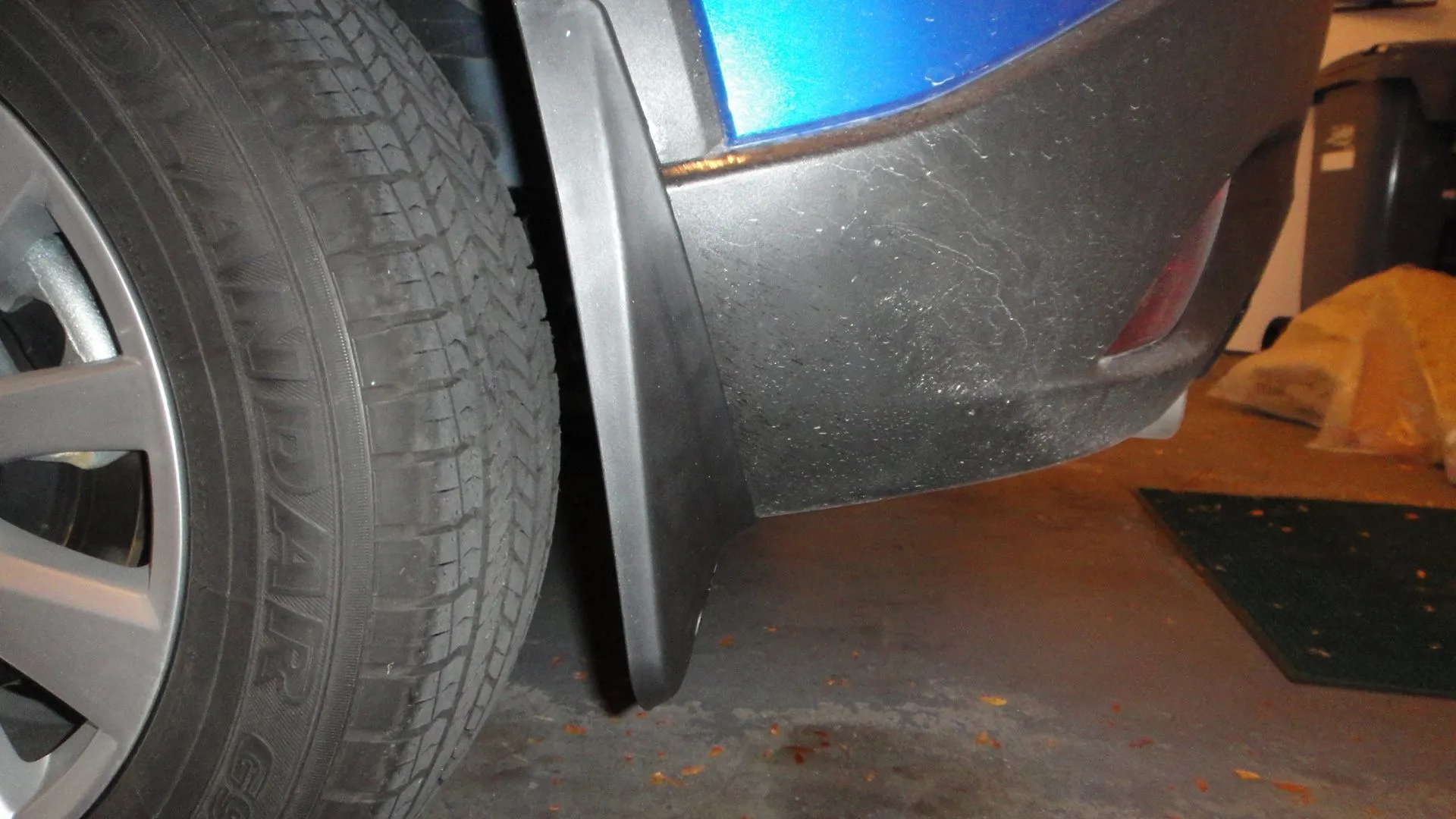

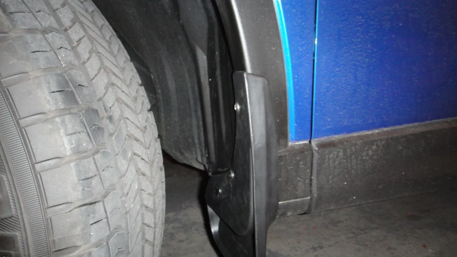

I got mine today - the box that they were shipped on got opened by customs - no big deal. I put them on in less that 30 minutes and the rear ones fit like a glove. The front ones... well I was warned - LOL - a little additional pressure actually made the rivets go in smoothly. The rest is history... And yes, the holes are a bit of problem, this is all easily solved by reading other posts and get ready. I thought it would be tougher and I am not someone that works a lot on cars - my momma did not make me lemonade and I did get a little dirty (grin). I went through the car wash and drove 130k on the 401 and they stayed on, so far so good... DSC00822.webp DSC00823.webp DSC00824.webp DSC00825.webp

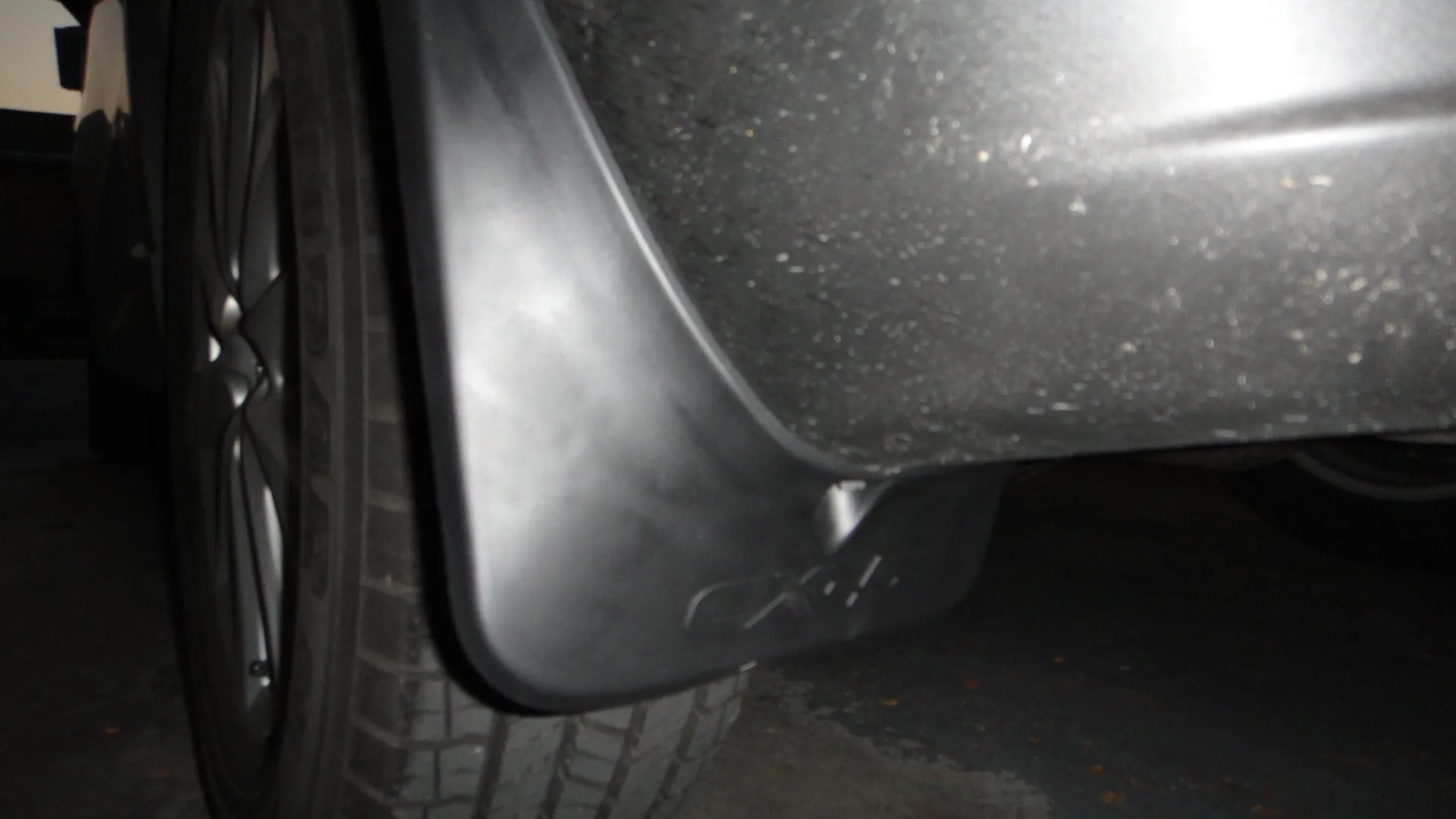

Aelaan > Thanks for the PM. I like the new guards they shipped you. They look exactly like mine, but your version with the CX-5 print on the rears look great. Good job!
Here's pics of mine....also ordered aluminum pedals. Got them installed less than 1 hour but I have to buy longer clips to get a perfect fit.

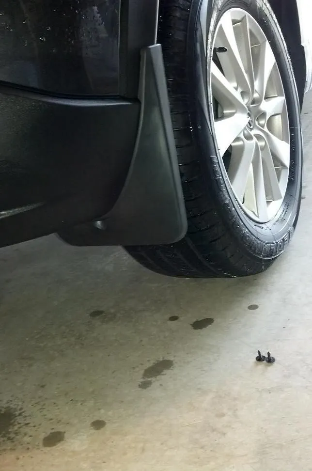

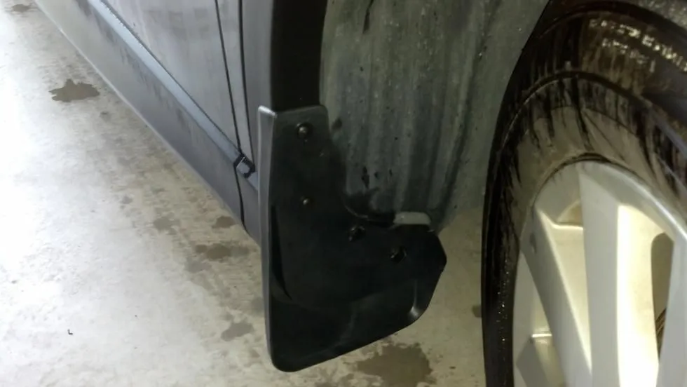

Ordered mine off Ebay for $29.99 and free shipping that takes about 15 days. Only took about 30 minutes to install with only one modification. I did not use the existing top hole on the front flaps(see picture). Over all I'm very happy with the flaps and price I paid.

I have also made this decision and ordered from eBay. I was prepared for modifications and some issues due to short rivets.
However, I need to admit that installation was very fast and super easy. No modification was needed and I used provided screws as well to fix them on the top to the plastic layer. I think it is a great cheap idea especially for winter season.

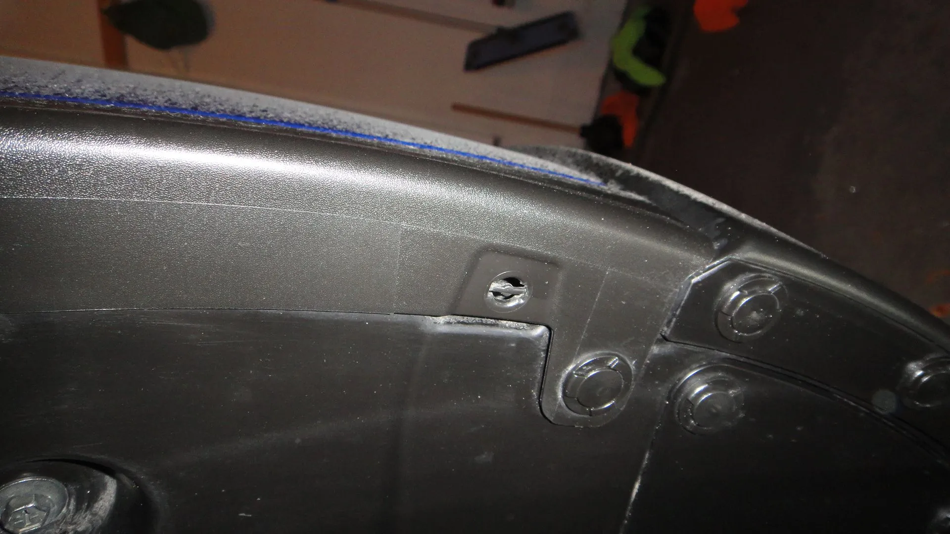

Did any of you have any problems installing your front mud flaps? My rear ones went on without a problem. I have already tried increasing the size of the holes on the mud flaps in order to make it easier to put the push pin rivets in. I don't believe the rivets are actually catching onto anything. As you can see in this picture I'm not currently able to get them on tight enough. Despite that the rivets are pushed in fully. Any suggestions would be appreciated.
To me, it looks like you got it lined up too far inwards.
yes, you have to cut that thing out, and you may have to get a bigger size rivet form autozone. If you are having non oem fitment issues, you may be able to remedy it with some double sided tape/spray adhesive(no gap) after you do what you can with the rivet..
