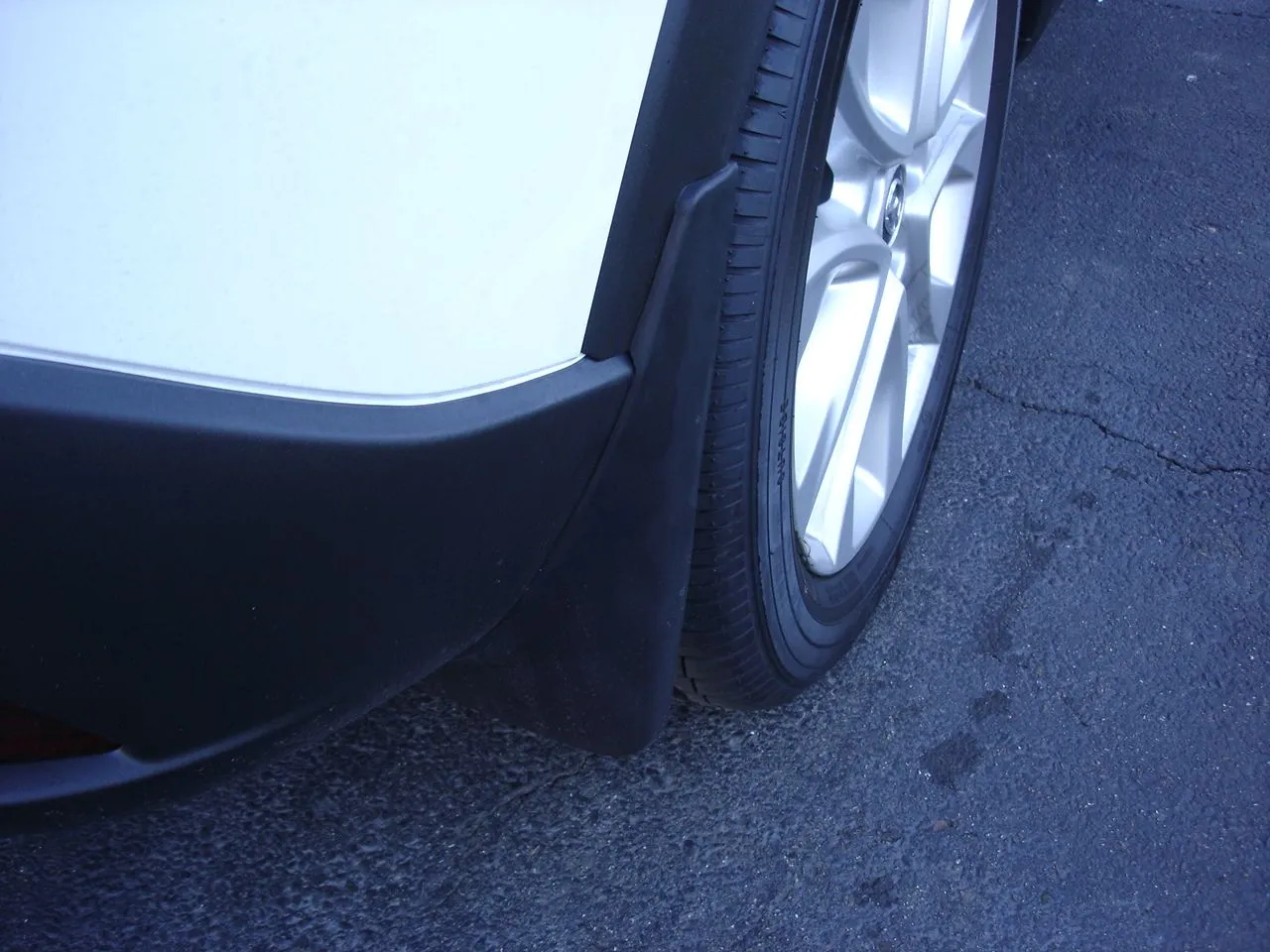

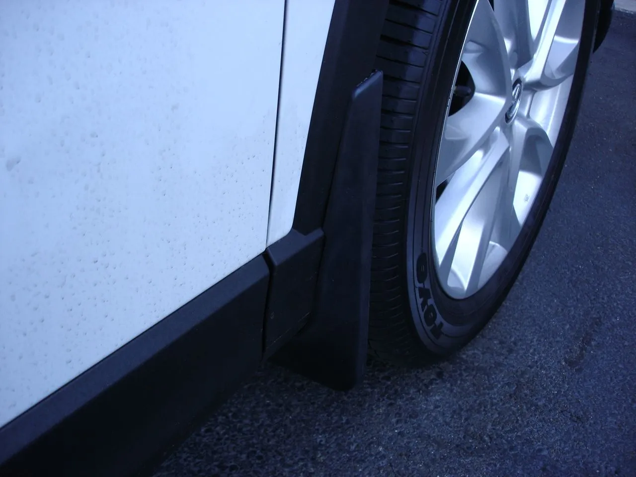

I got ebay chinese mud guard,
just remove snaps from wheel well and the rear that single bolt on the bottom
I increase the hole size on the flaps so the snaps will fit right in. no new holes to be drilled, cheap and it works, just wait for 4-6 weeks for delivery.
can't tell if it is OEM or not.

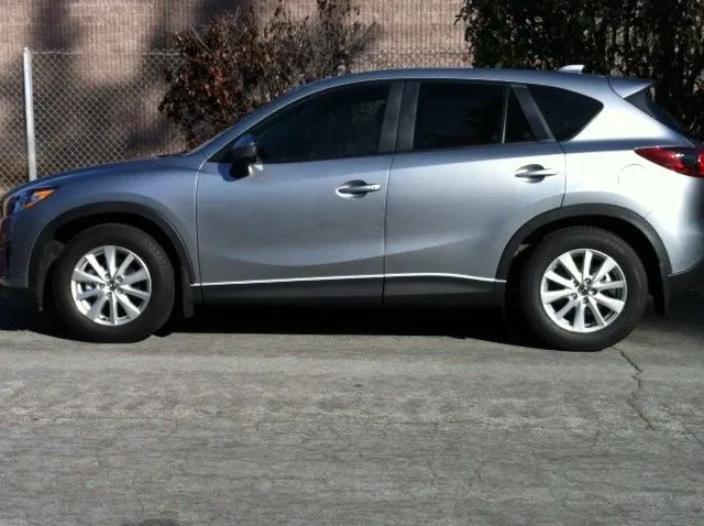

Can anyone provide a side shot of their car w/splash guards on it please. I'm having a hard time fiding said picture; I only can find close up shots at various angles, not a full vehicle shot. Thanks n advance
not sure if this helps, as for mileage I didn't notice any difference. there has been lots of debate on this topic, maybe some aerodynamic guru can give us some insight.

The Chinese ones seem to come down a little further then the Mazdas.
I just installed the Chinese ones on the rear. Really easy. I made the holes in the mudflaps slightly larger and used the lower two push-pin-rivets that were already on the car and ignored the top hole. The top hole of the mudflap does line up with a mark in the molding that looks like it is designed for something to be screwed into it. The top hole would require drilling a hole in the molding and possibly the sheet metal behind it, I don't know whats behind the molding in that pre marked spot. I would rather use another push-pin-rivet in that spot then a screw. No need for adjustments on the bottom bolt. I will do the fronts another day.
Finished up the fronts. I did not use any of the included screws because they were already starting to rust while in the little plastic bag. I used all the pre existing plastic push pin rivets that were already in the molding and had to purchase another one for the top hole in the rear and a slightly longer screw expansion rivet for the front middle hole. Overall I am happy with the install. The longer screw expansion rivet is a little concearning because is not as snug fitting as the original push rivets. I do like that I did not have to modify or snip any of the original molding and could always go oem if the $35 Chinese dont work out.

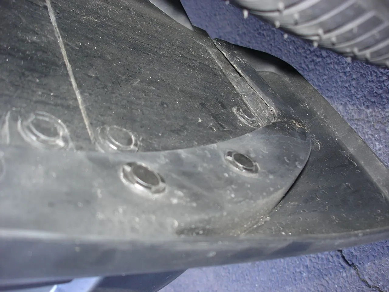

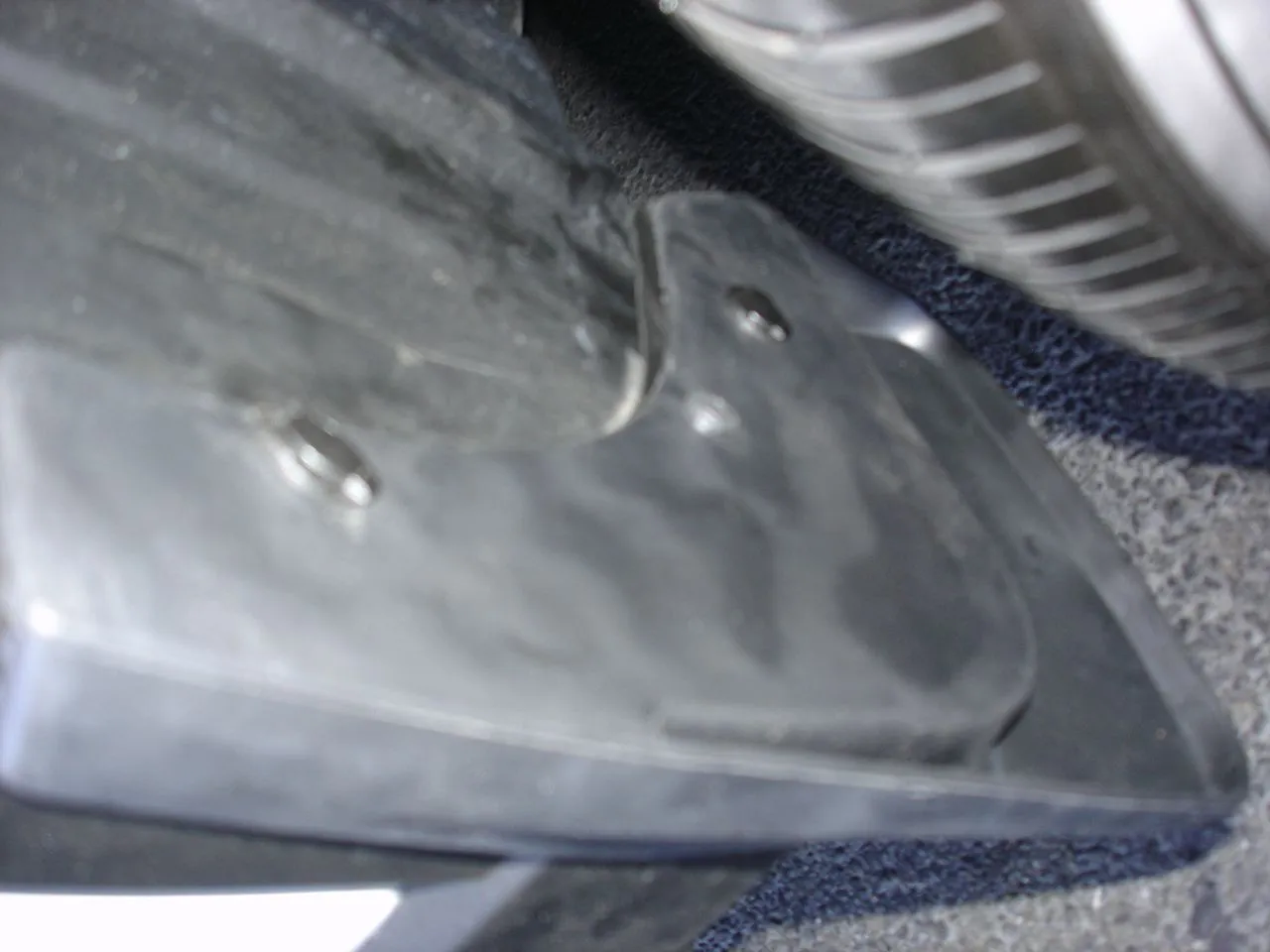

I installed these from ebay, No problems!
I had to -
Drill the ebay covers a bit to make the holes wider
Use the pop screws already on the CX-5 to hold it in - they all fit but were very tight due to the additional space required to push through.
I also had to screw in scews at the top just to keep the fit even. There is an existing hole in the gaurd and it fit perfectly in there.
Took 5 minutes to do
