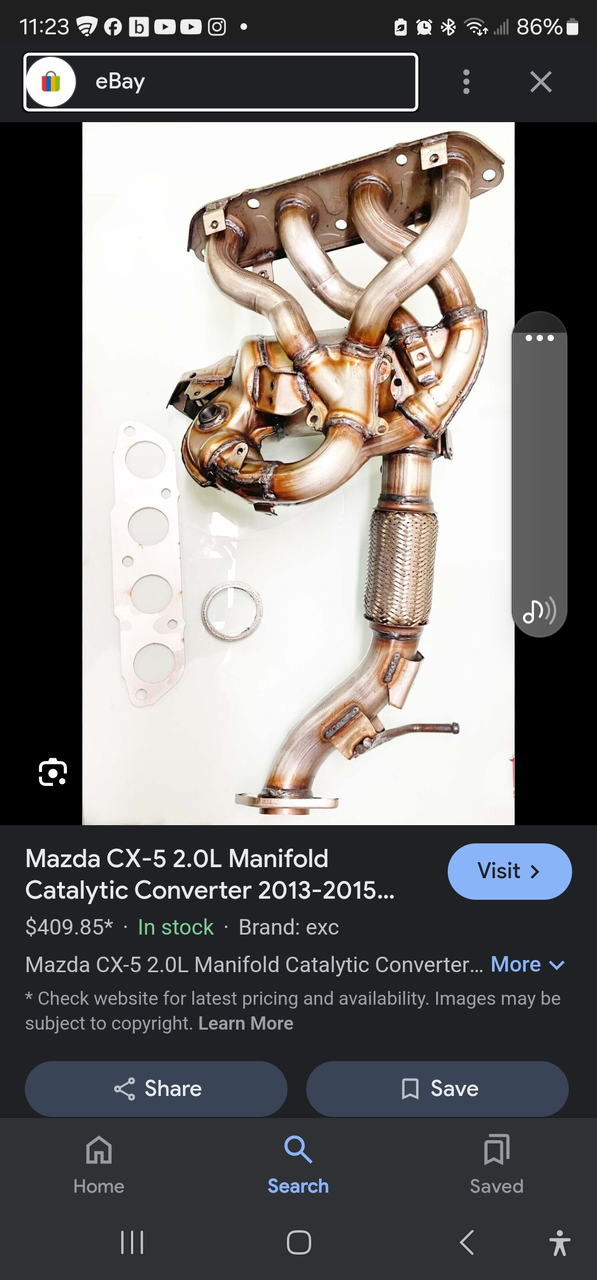

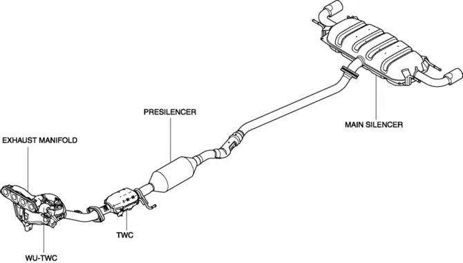

The guy at the dealership said this attaches to the pipe that contains the catylic converter and was trying to get me to replace the entire exhaust system with a quote of $7500 dollars...obviously I wasn't willing to do this because that is pretty much what the car is valued at and there is nothing wrong with the rest of the exhaust system. I was trying to get this done under my warranty, I just wanted them to replace the manifold since that's where the issue is but he kept saying they wouldn't pay it because it failed at the flex pipe, not the manifold...since I have been told it's all one piece that just doesn't seem right to me. It's an extremely frustrating situation..the car isn't loud at all so I'm assuming it's small leaks. I had an exhaust guy look at it as well and he said it would probably hold up for a few more years but that it was leaking where the flex pipe attaches to the manifold as well as on the flex pipe. I'm assuming the picture above is the part but not sure..

Seems like it would easier to repair the flex pipe, but that might take a shop that knows how rather than just replace the entire assembly.

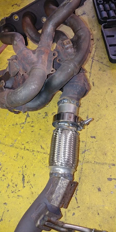

You can have a new flex pipe welded in, you will have to have the manifold removed though, I did this on my 2014 Mazda 6 a few years back. I added a V-band flange before the flex pipe so that it can easily be removed and replaced in the future. This also makes it way easier to reinstall the manifold in 2 pieces.

Thanks! I will have to take it somewhere since the engine needs shifted forward or separated to get the manifold out but maybe I can see if they could just replace the flex pipe on it that way. That's how Mazda should have made the part in the first place so that the flex pipe could just be removed and replaced..

Hi, I ended up taking it to a local mechanic to have them cut the flex pipe off and weld a new one on. It's a pretty big job and it was around 450 dollars to get that done. It's way cheaper than replacing the entire manifold though which is closer to 1000. If you find a good welder it should hold up for a few more years if not more. If you do have the money to replace the entire manifold it's probably better to just go ahead and do that so that the engine only needs shifted or moved once...they assured me my manifold was fine though and it was okay to just weld it. One thing I have noticed though is it still sounds the same after getting it done. It always sound loudest when started then gets quiet...not sure if that's just how the vehicle is or if it's cause it was welded...
