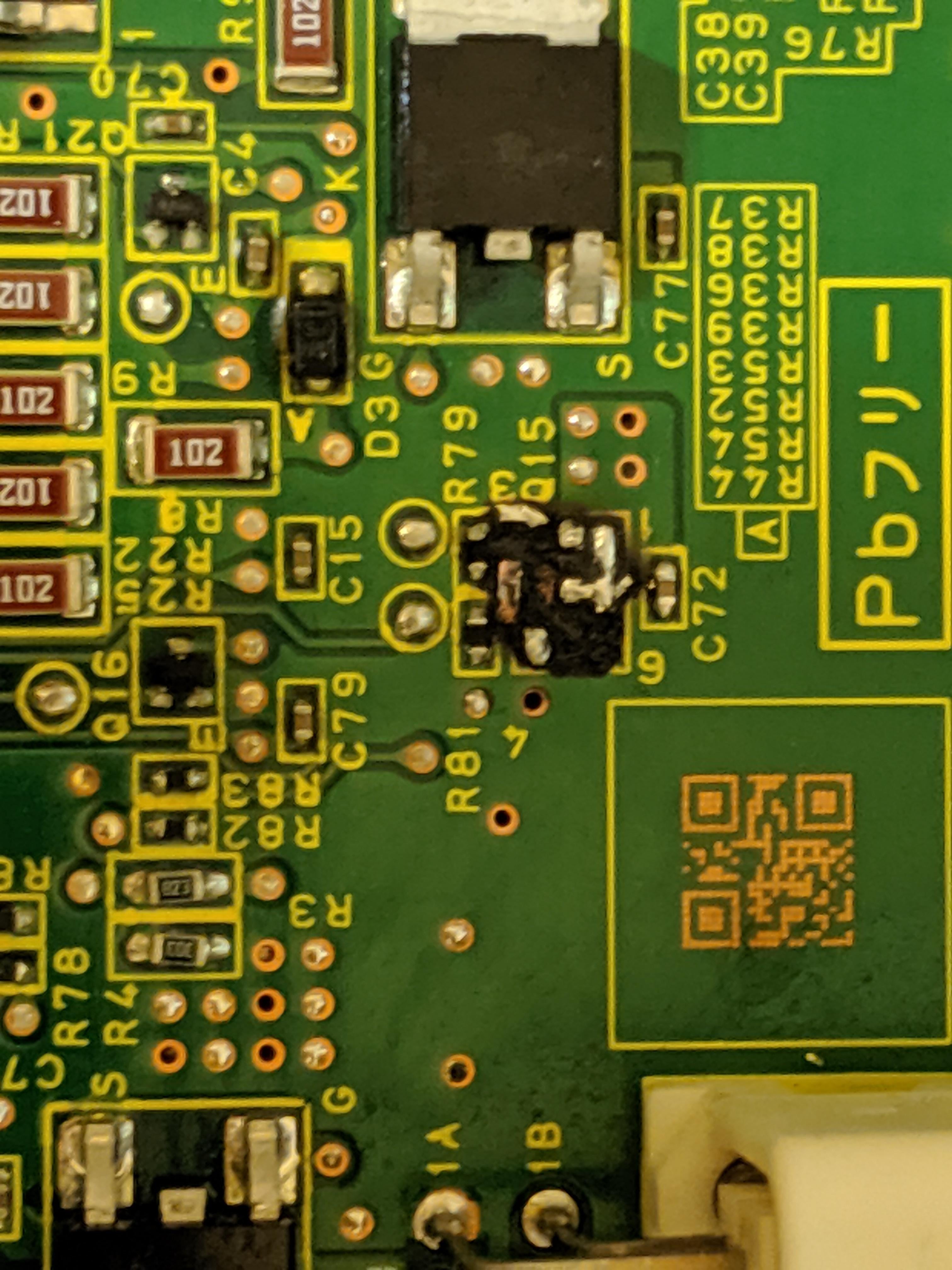

Great thread. Just experienced the issue after swapping my cargo compartment bulb without disconnecting the battery or the bulb assembly. I replaced the MOSFET Q15 on the RBCM and all was back to normal.
Thanks for the info. If my RBCM ever goes out I'll look for that MOSFET.

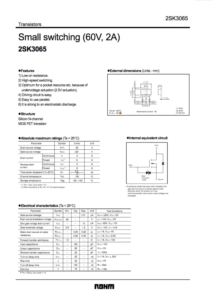

I believe this is what was used

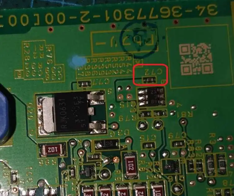

Sorry for reviving an old thread. Does anyone know what component is on C27?
Managed to replace the MOSFET but knocked component c27 offed.
C27 is a “C”apacitor. You need to read the tiny numbers on the package to know the value. It’s hard to damage this type of the capacitor. Can you just solder it back if the capacitor itself didn’t get damaged?
Ahhh. I can't find the knocked off capacitor so I am looking to see if anyone know what the capacitor value is. Looking to replace it 😅

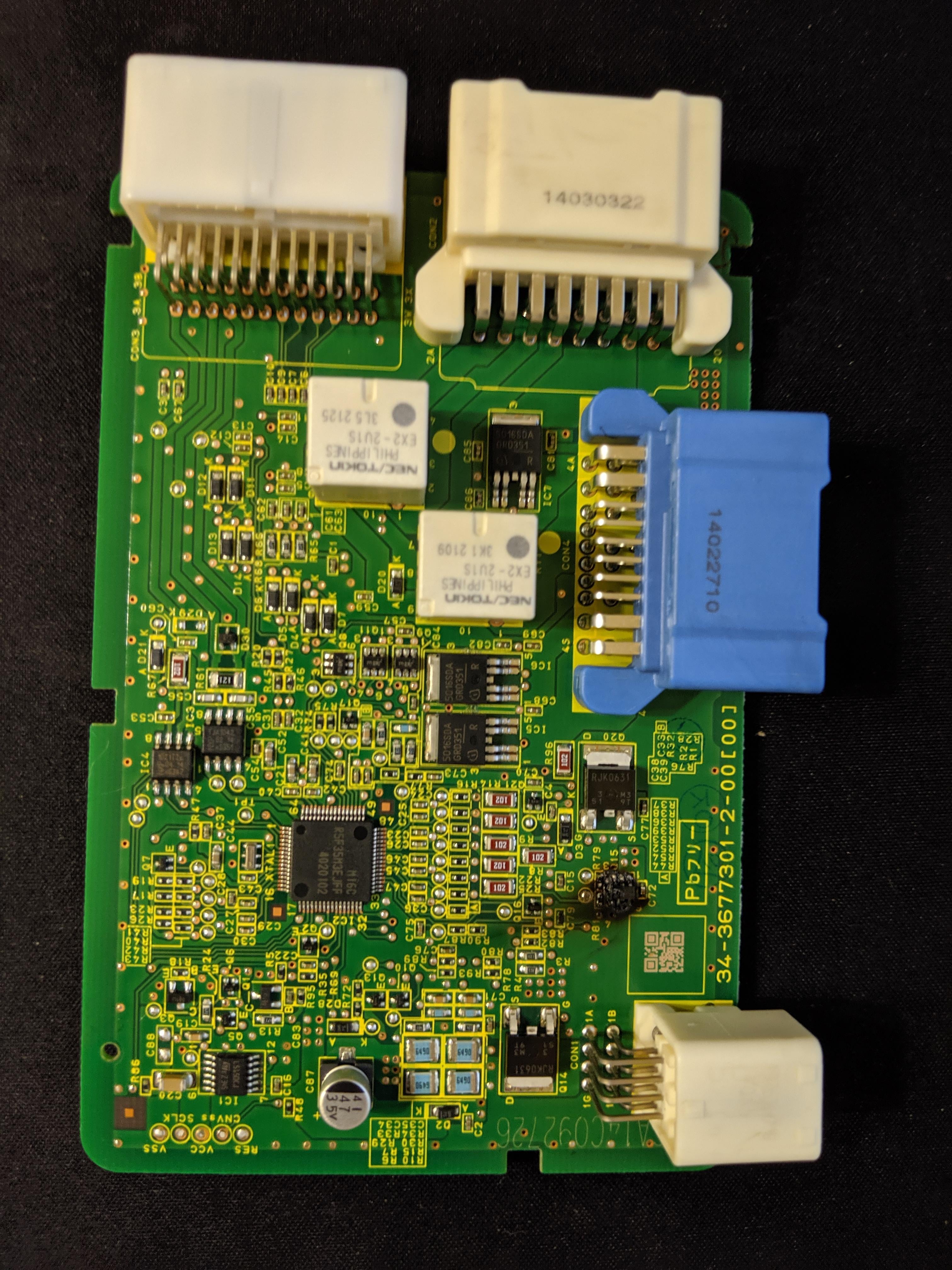

Hey there,
I apologize for posting in this old thread. I tried changing a bad trunk light bulb and now it doesnt work. I read the things to look for in the rear BCM. But didn't see any burnt MOSFET. I am attaching image of the BCM. If someone can kindly guide me which MOSFET I need to check?
