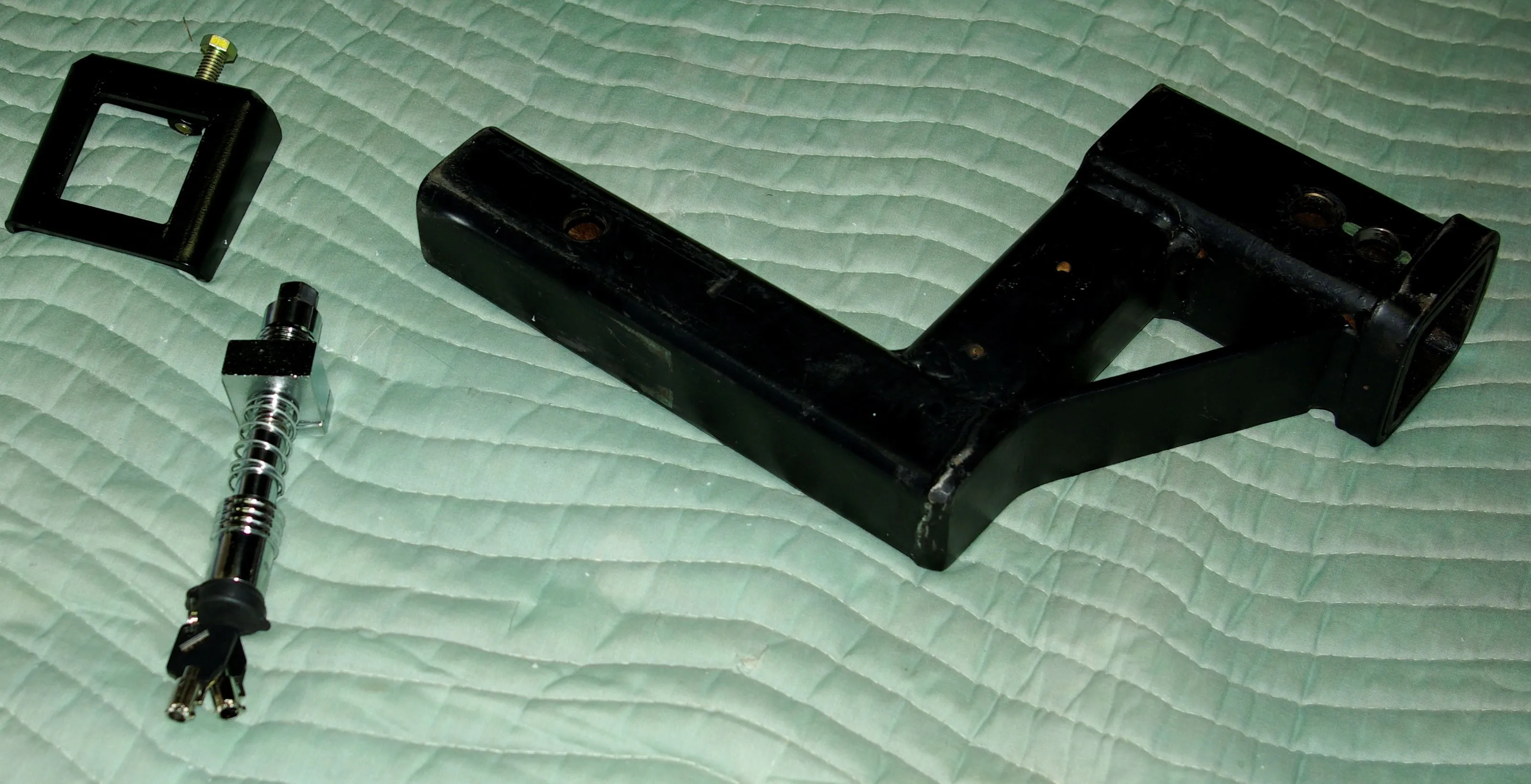

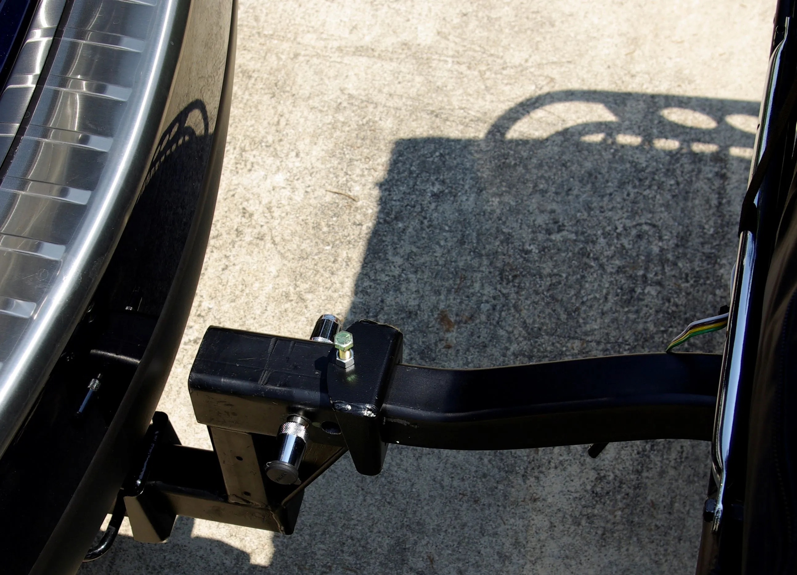

To get the load off the ground, I decided to try a used 7 inch riser made locally to carry an electric wheel chair carrier with powered chair. The riser brings the carrier several inches above the exhaust, and makes it much easier to load. In the case of the Rola, and some other carriers I saw, there's a couple of inches of rise in the shank of the carrier itself - which gets the carrier backbone up 9 inches higher than hitch-height, using my riser, and then the actual platform about another inch or so higher. Overall the 10-11 inch difference in height really improves serviceability, and appearance.

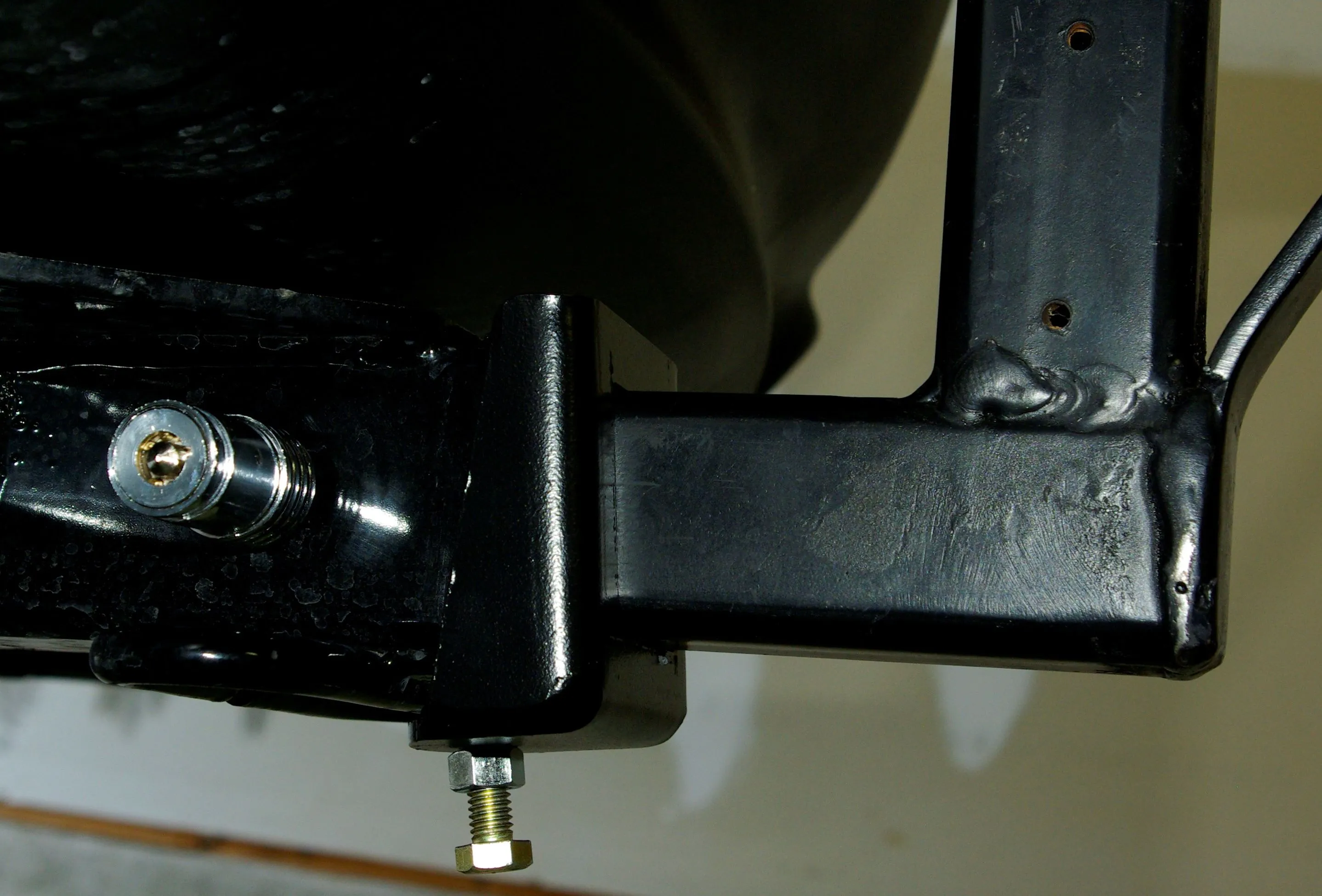

To eliminate the shake and rocking, I elected to use double anti-rattle devices at each of the two junctions. Where the riser comes out of the hitch, we installed a anti-rattle lock, and to eliminate vertical movement, installed a Curt device with bolt, and lock nut. Together they completely stabilize the mounting.

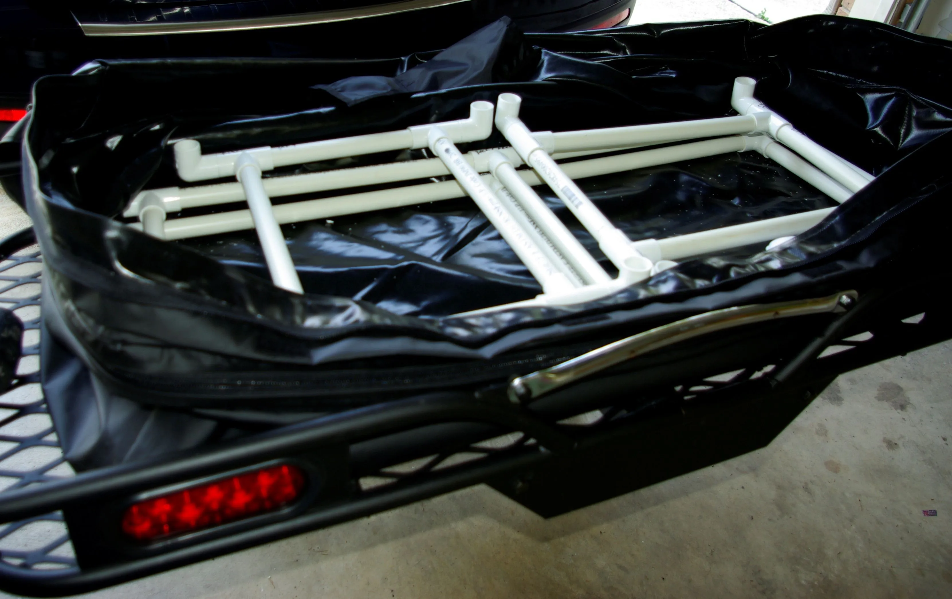

The Rola bag is limp, and to me that makes it more difficult to load. To solve that problem, I went to a big box, and got PVC pipe and fittings to make an internal cage for the bag. It was easy, and I can tap it apart and store the sections in the bag secured to the carrier when its not being used. The frame was built around the smaller of the two bag configurations, since I knew if the bag had to be used in the expanded mode, the contents would hold the bag shape beyond the PVC frame. Truthfully, a second consideration was my unwillingness to have a half filled floppy bag detracting from the vehicle. The concept of the carrier and bag is sufficient detraction without looking like a hobo in the process.
I got my bag at a discount because the tie down straps were missing. Went to a sporting goods store and bought 1 inch straps with plastic snaps, and wound up with a better strap.

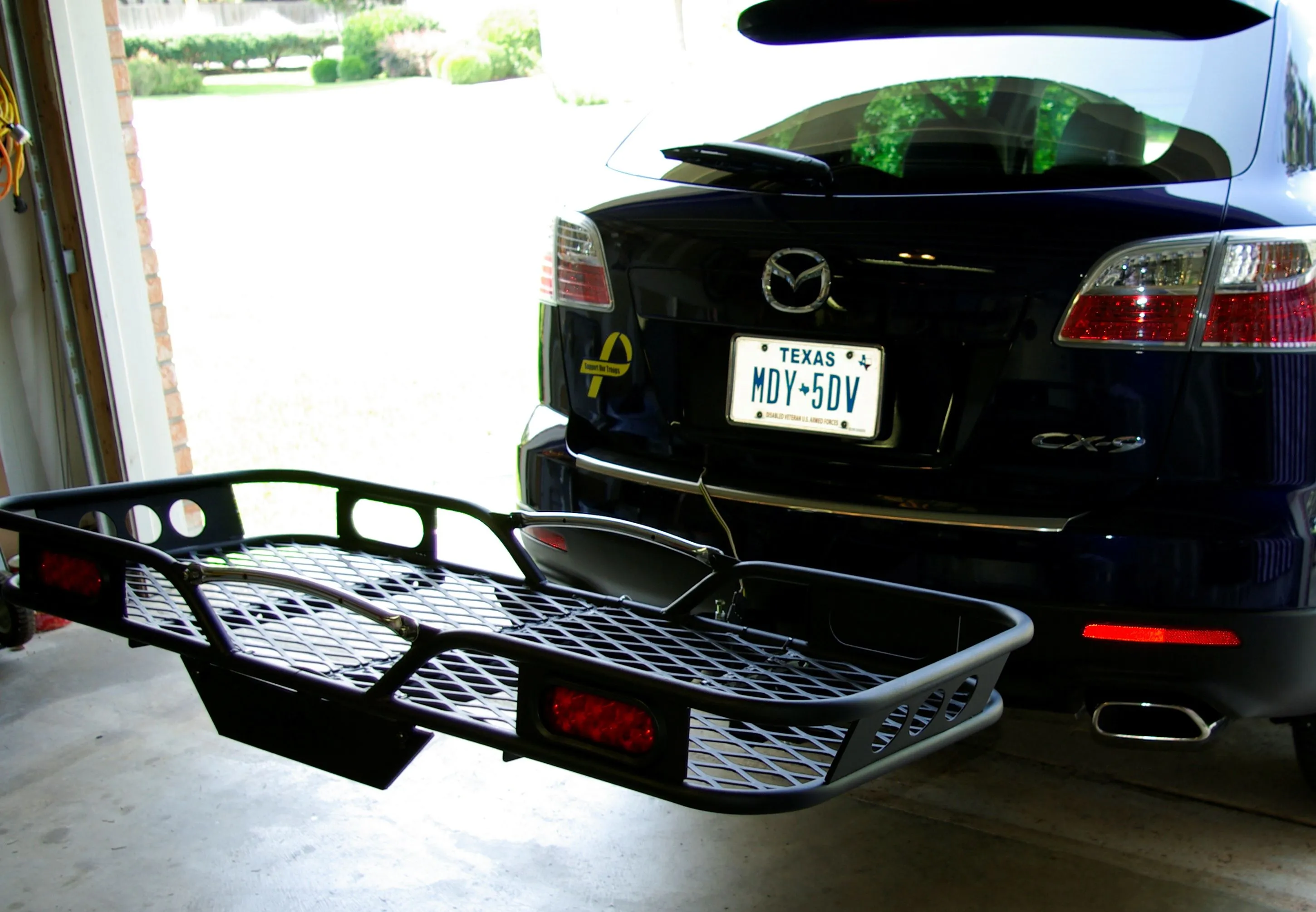

The first shot shows the riser, and the two anti rattle devices. Select your riser carefully, the carrier will take 600 pounds, but your hitch tongue weight is probably going to be 400. Make sure the riser is made to handle the load. There are some out there with 100 pound maximum's, and the carrier weighs about 50 pounds by itself!
Second - close up of the anti rattle features installed.

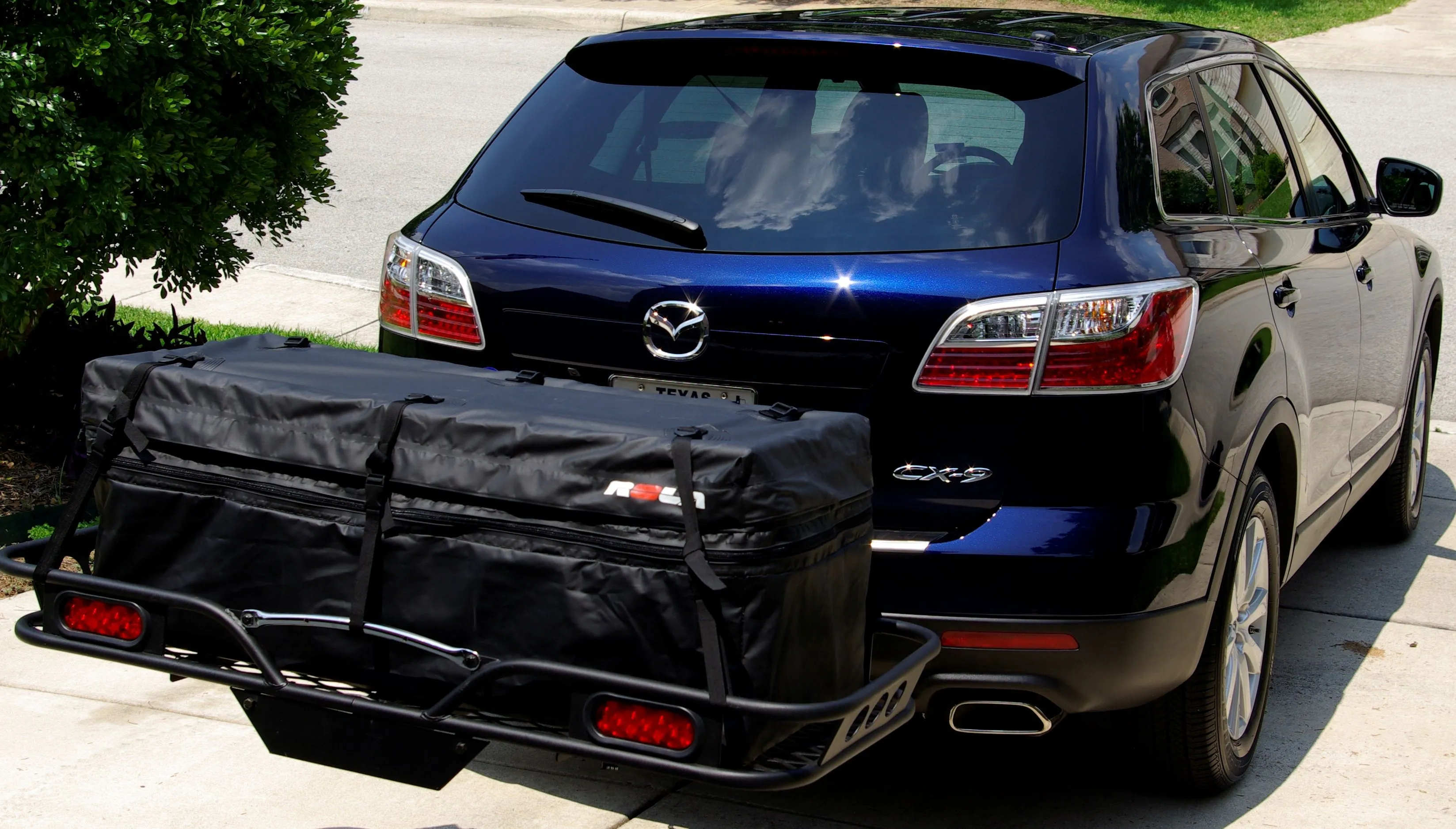

In the first shot is a sense of the basic carrier as it relates to the vehicle. Its 57 inches across and 23 inches wide.

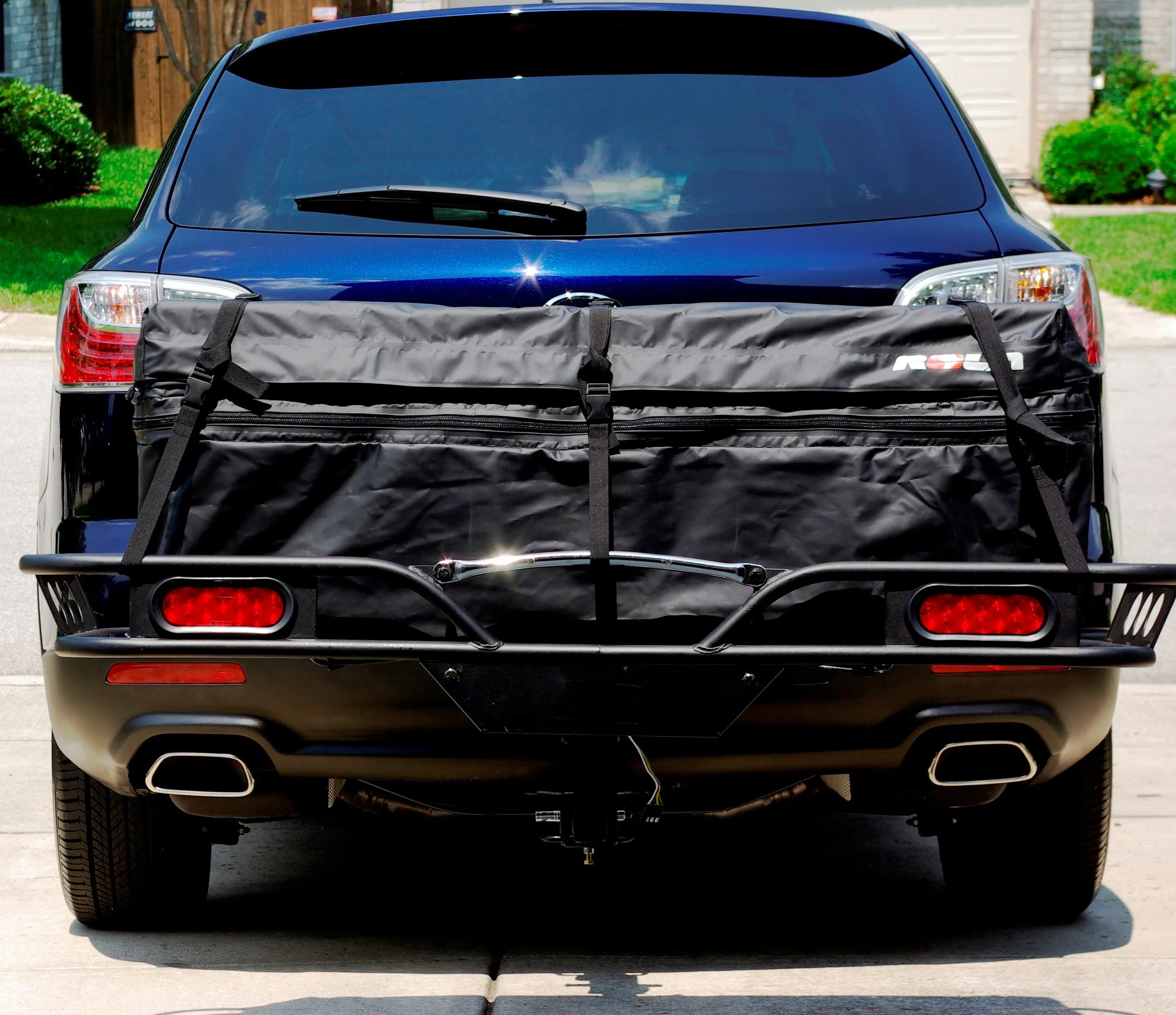

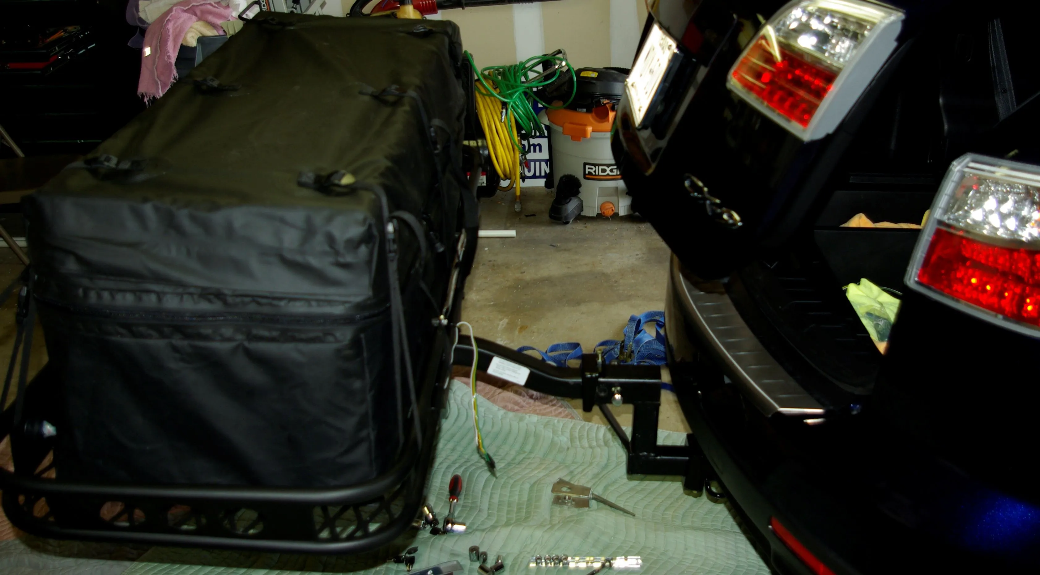

Second shot (taken before leveling adjustment (darn)) shows the relative size of the package.

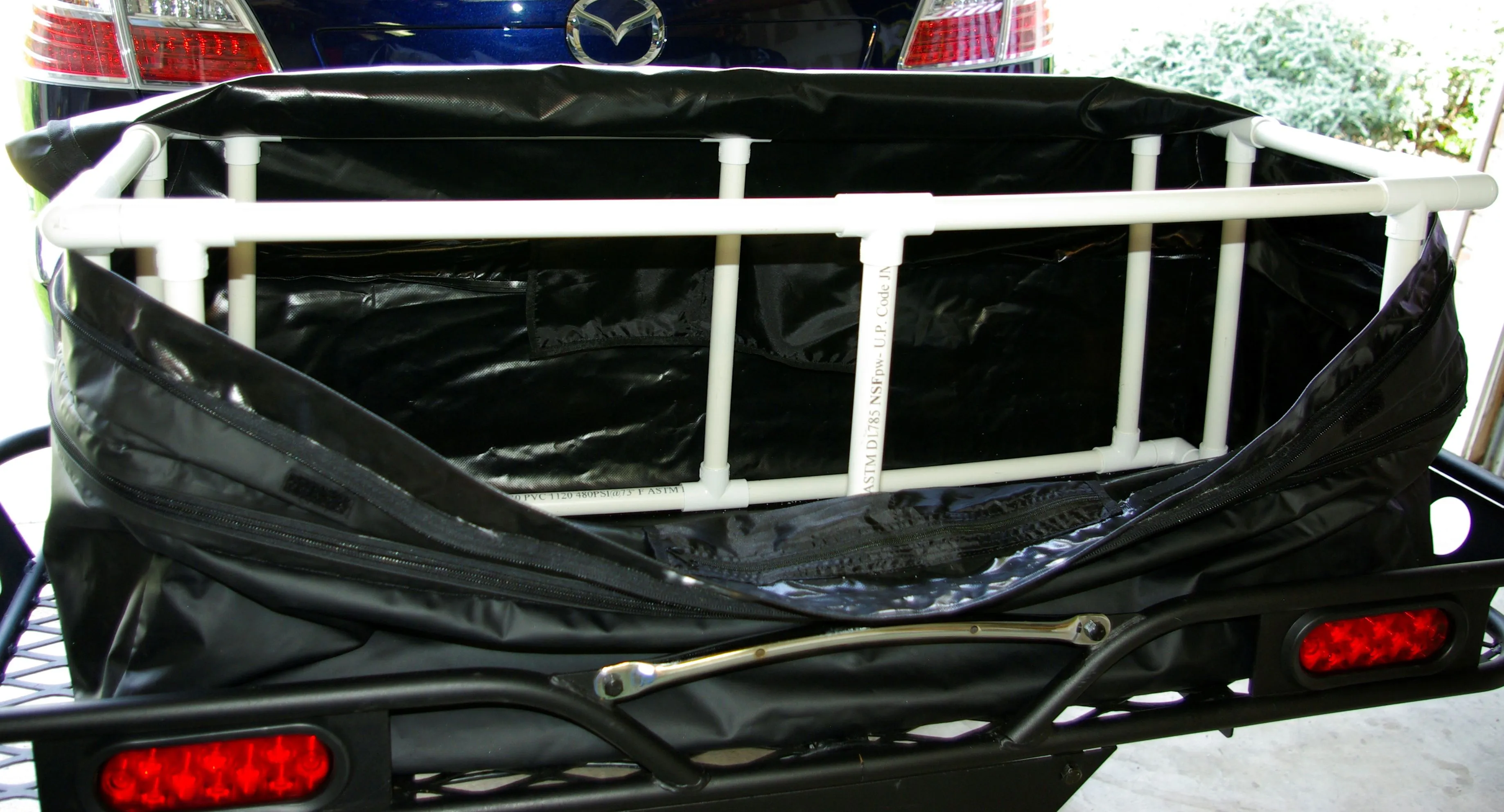

Third, is the PVC frame with the bag dropped to show detail. It simply lifts out if not needed, and stays home.
4th is a shot of the PVC frame with the ends knocked off, and collapsed flat for transport if I don't need the bag both ways. The bag can then just be lashed to the carrier empty, or placed in the back of the vehicle, out of the way.
Finally, the package ready for travel, except for moving the tag to the carrier. Provision is made for that with mounting holes on the chrome bar where the center lashing is secured.

Relax, I resized them all, can't explain why one was out of whack. I would add that they all passed the forum's size requirement just fine, or they would not have posted up. Personally, I am disappointed to learn that someone on this forum can change the entries of other folks, right or wrong, unless they have moderator status, but I've only been here a month or two, so am still learning this bunch.
The cargo carrier is what it is, I don't foresee replacing it because someone else think's its overkill. Extra beef isn't a penalty, since its weight is in line with other carriers of the "near 60" size."

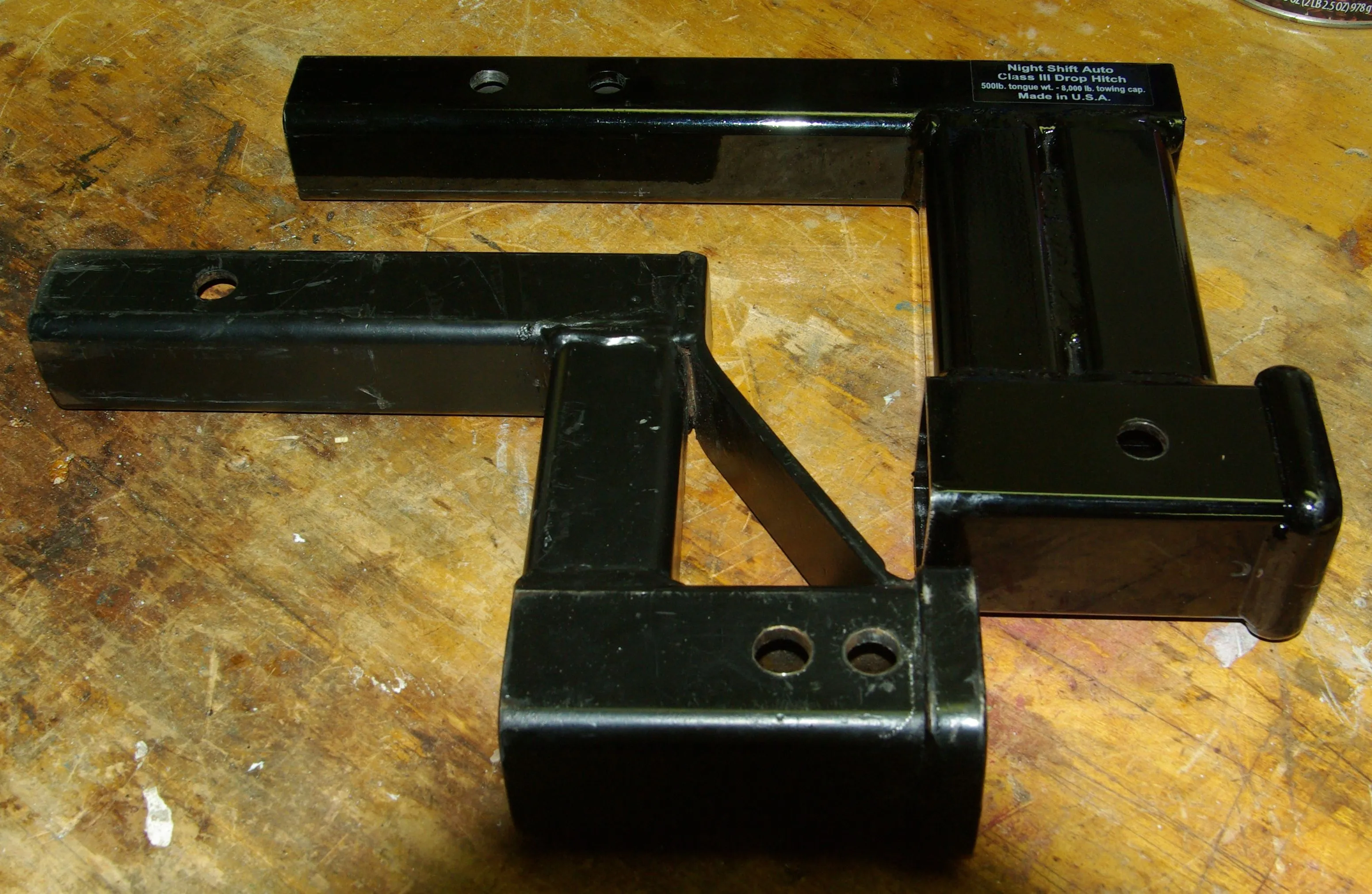

One Component Change
When I last posted to this thread, I was using a home-made riser, for which we had no load bearing specifications. Things like that make me a little twitchy, so I surfed around until I found what is (for me) a better solution. As you can see in the photo, the new one has two 2" vertical towers, and they are welded together on both sides, as well as being welded completely around the unions top and bottom. It's rated for 500 pounds tongue weight, which exceeds the vehicle and hitch limitations. Be advised that if you happen to order one for the CX-9, you'll need the over-length model to clear the curve of the bumper. As it happens, this one is an 8 inch rise, which is a pretty negligible increase over the original. This one was made by Night Shift Auto - in the USA! Once again this configuration is all class III, but one could do essentially the same thing with the stock hitch. I posted this change because nearly 1200 people have looked at it, and that indicates at least a passing curiosity on the subject.
